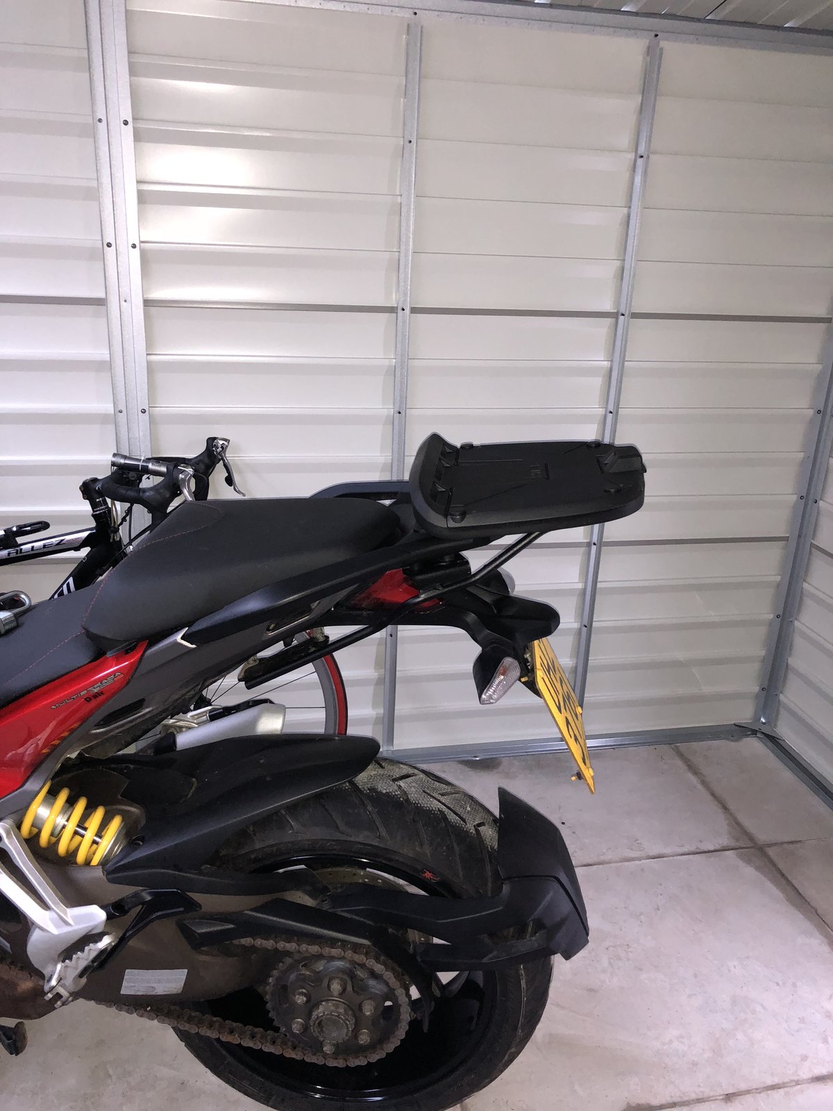

  1. I still haven't fitted the stuff off my DVT yet as I've had to order up a couple of replacement screws, and I need to repaint the rails as they've taken a battering but everything I've looked at indicates that all the DVT stuff should fit straight onto the 1260. The standard 1260 grab-rail\rack (that the Givi base plate fits over the tope of) looks different but it's the same as the DVT where it matters. I've offered up my old DVT rack and it seems to line up just fine.

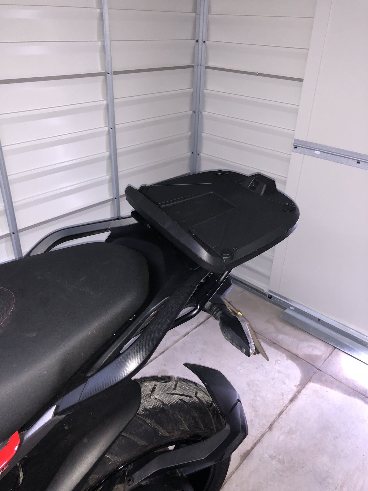

  2. Here’s a picture of the base plate, I think it’s about the same size as the Givi one but much tidier looking. It’s also a good shape for attaching a roll bag or some other soft luggage, should the notion take you

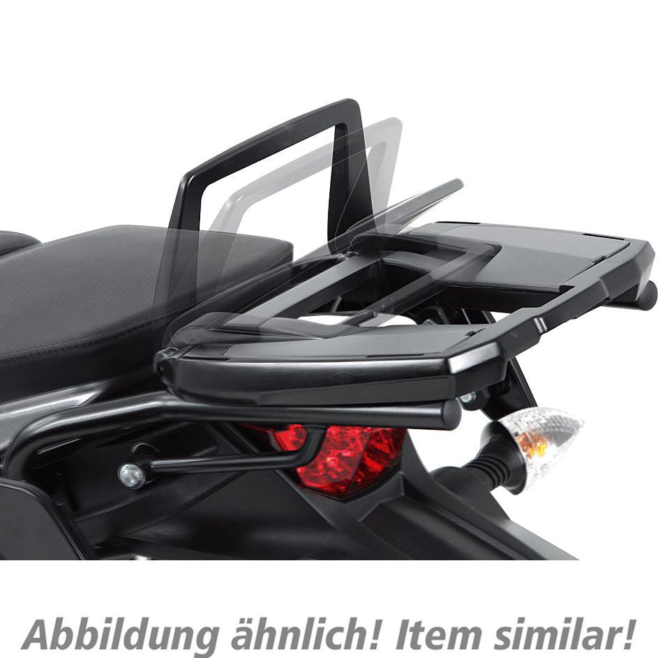

  3. The Hepko and Becker rack has 2 rails and fits on top of the rack, I've been very happy with it.
    There is a video here:
  4. Thanks to both for the pictures!
    I will go the H&B route. I will order tomorrow the H&B luggage rack which is specific for the MTS DVT.

  6. It looks very similar to givi's monolock plate. On the givi monokey plate, kappa boxes work too. Have you thought of looking at the ventura luggage system as another option?
  7. The Ventura brackets for the 1200DVT don't fit the 1260 rack, as I found to my surprise. They've changed it just enough to foul on the rack, even though the mounting holes underneath are the same. Ventura don't yet make a 1260 model
  8. The Shad one takes 10kg where as the Hepco is only rated for 5kg as far as I know
  9. Just keep in mind that regardless of the capacity of the actual box, the owners manual states the max luggage capacity should not exceed 30Kg:-
