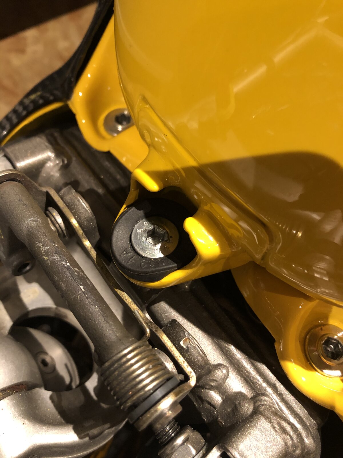

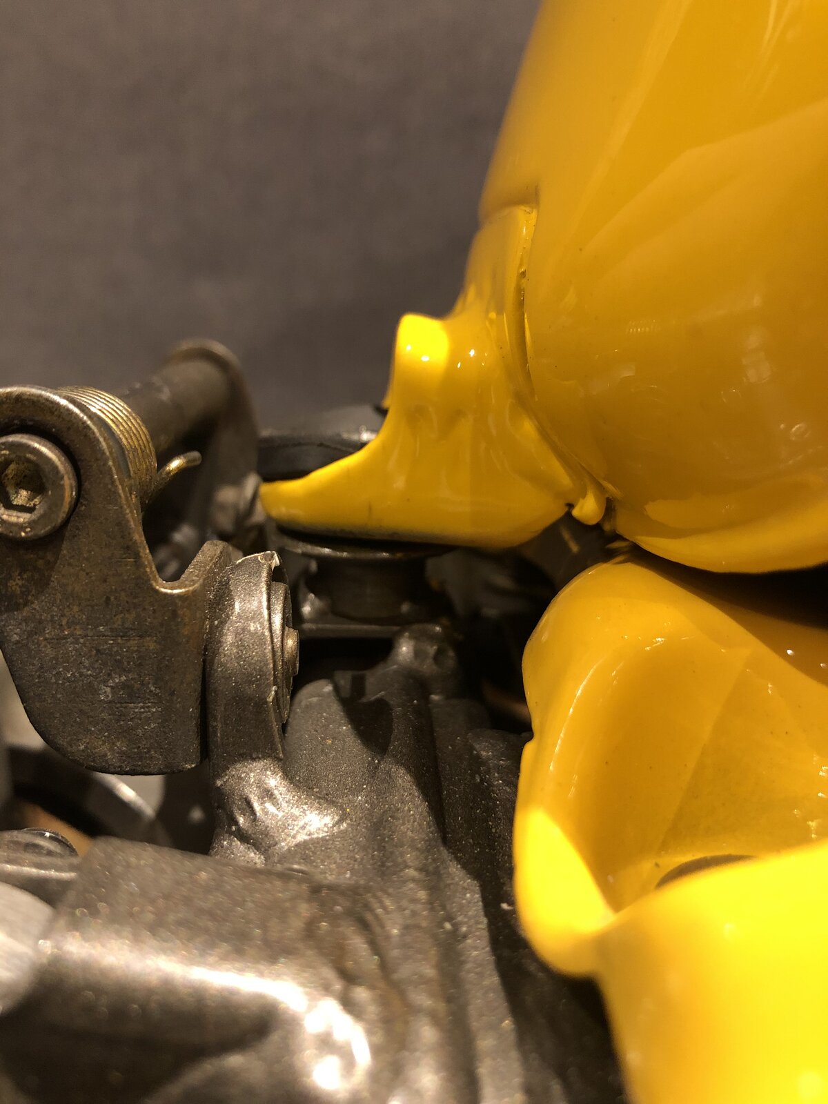

    Started to have a good look over the bike again and gap between the air box and the tank looked odd! I’m pretty sure this bung goes underneath the bracket and pops through?
    A7053B09-F9CB-4037-8730-927E119E662D.jpeg BFABF4D5-171C-479E-9A3B-6231B006E1A7.jpeg
