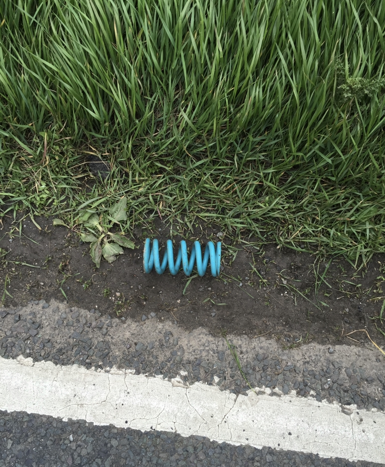

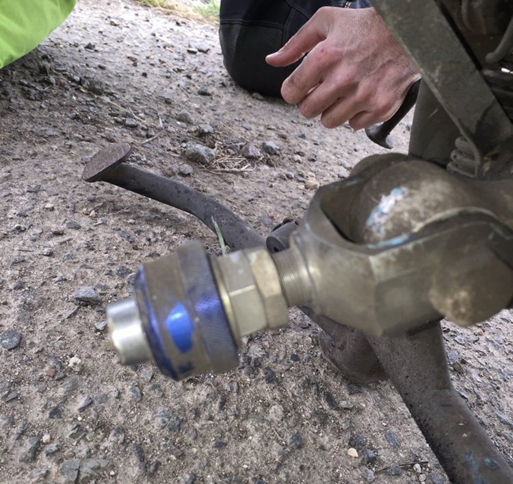

  2. the bottom of the shaft...
  3. Hope you sent the manufacturer a reclamation starting with "the spring is just around the corner.."... OK I'll get me coat once again.
  4. There must have been a issue with the heat treatment. Usually they bend like a banana before they snap. Not that that is any comfort when that happens. I'm going to have a good look at mine now.
  5. It might be worth checking how much shaft is threaded into the bottom yoke if it’s the same style...
  6. I'm very surprised about this kind of failure. I don't want to blow my own trumpet but I have extensive knowledge and experience with dampers. Mainly racing cars and not specifically with nitron but regardless, I have never seen a shaft snap like that. Usually they bend like a banana before they even think of snapping. There must have been a issue with the hardening of that shaft for it to go like that. That doesn't really fill me with confidence. I know they are a middle of the road damper price wise but they are still a lot of money for what they are. Mine is too stiff with the wrong spring for my weight anyway and I have a stock showa damper here to refurbish. I shall get that done and put that back on with a slightly increased rebound and that will be just fine for me.

  14. The pic was obviously taken from a Enduro or even more likely an adventure bike and these heavily loaded tanks snap every shock’s shaft. I had seen failures from all big brands and I am pretty convinced that they all has just to carry more load than planned on rough tracks over an elongated period of time.

  16. But you cannot expect a shock/a whatever to sustain abuse beyond its planned frame of usage. Overlander bikes are usually extremely overloaded and that makes shocks snap. A shock is pushed exactly in rod direction so there is nearly no chance of snapping

  18. Looks like a road bike to me.
    Centre stand and low position of shock mount.
