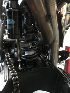

  5. The new shock turned up and I’ve installed it - I also took the opportunity replace the ride height adjuster which was FUBAR and clean and regrease the linkage and swingarm pivot.
    The build quality and finish on the shock are excellent as you’d expect, glad I got the black spring which is matchy matchy with the remote reservoir, it’s nice that’s it’s made in this country as well.
    Hopefully it’ll be a vast improvement over stock, I’ll have a set of S22s on Monday so I’ll be able to go for a ride next week.
