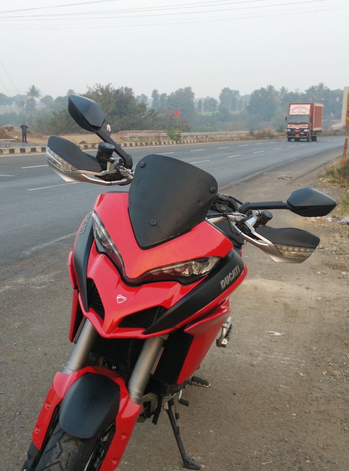

  8. OK update on the ninja screen
    was able to test upto 90 KMPH and there is no buffeting
    the noise levels have improved but not gone completely
    I am a shade under 6 and the clean air seems like hitting the mid of my helmet if I rise up a couple of inches the noise goes away
    will check at higher cruising speeds and report soon
    cheers!

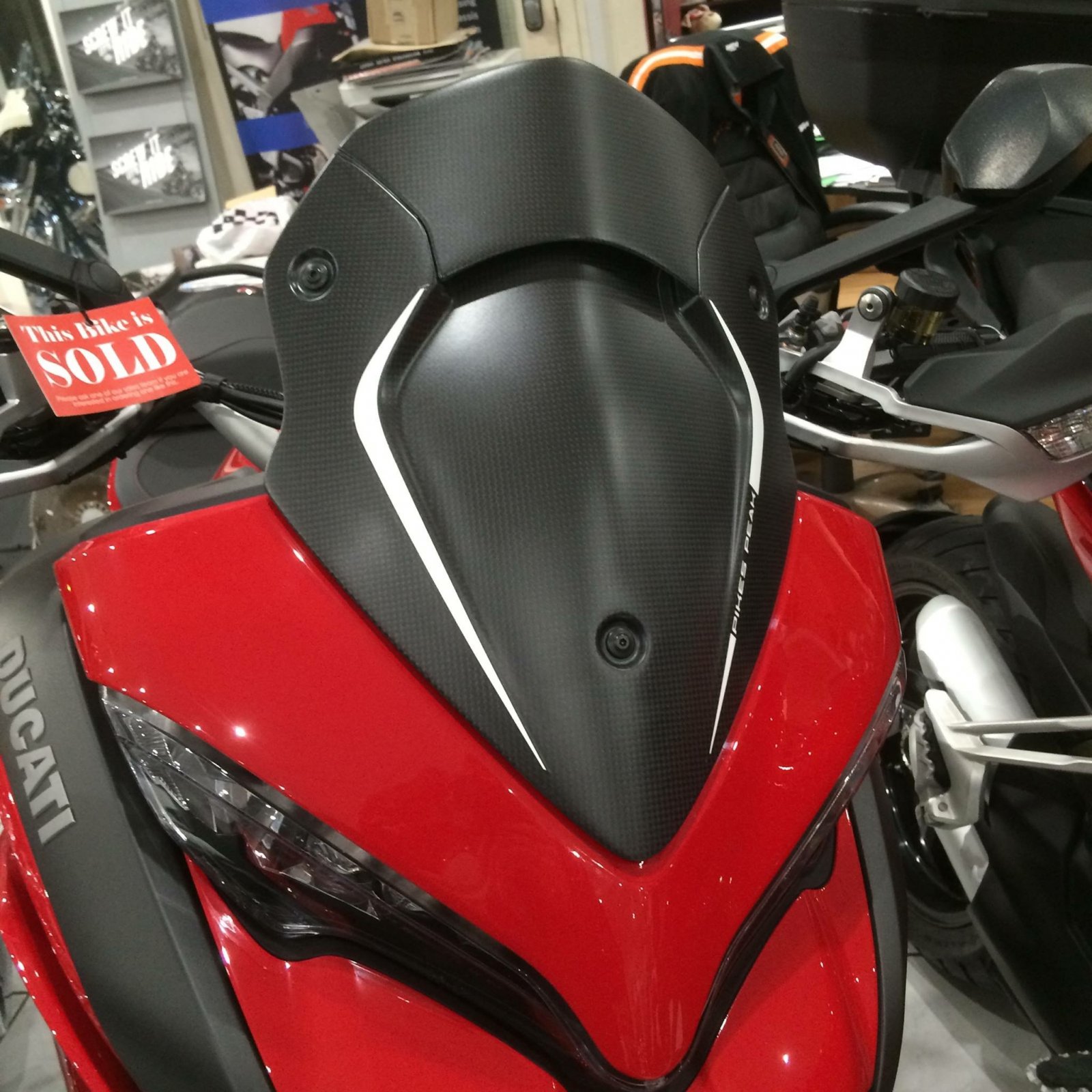

  9. Here is the final version of the cut down ninja screen finished in carbon fiber aka Pp look
    Works like a treat, clean air and enough of a screen to duck under at silly speeds IMG_20160107_073816.jpg

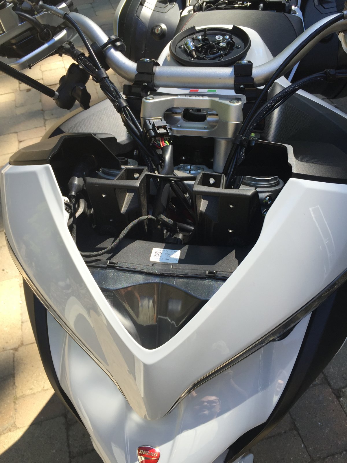

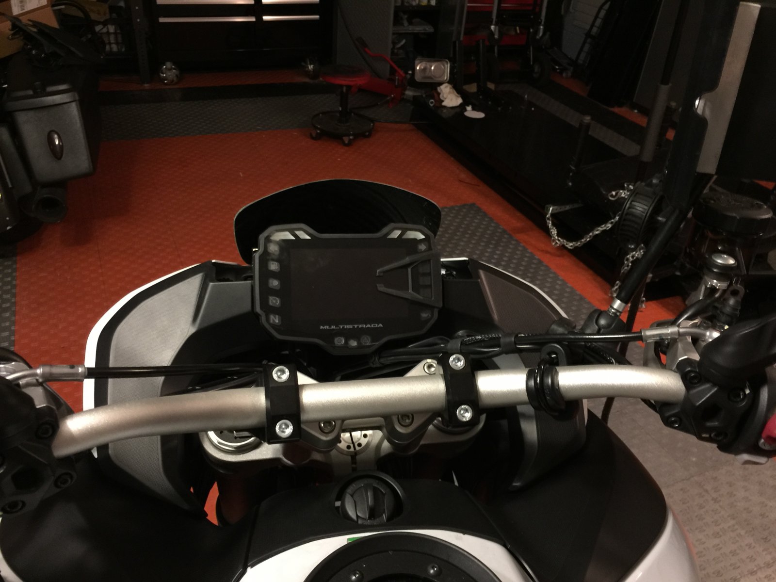

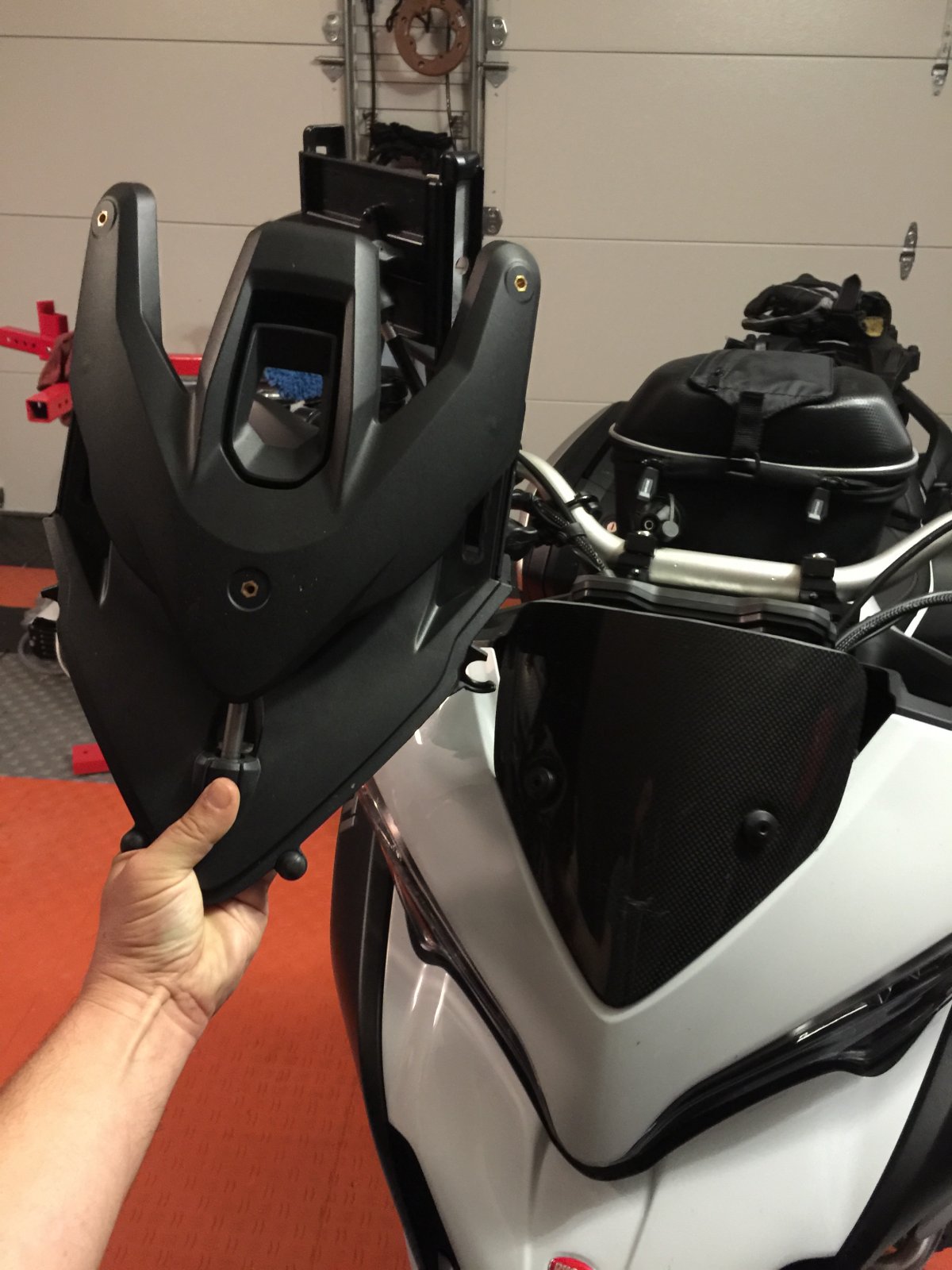

  11. I have the beginnings of tinnitus from a lifetime of fun and idiocy, and any sort of buffeting really bothers me. I also went to a C3 Pro, for the quiet. For me to get clear air at my towering 5'5", I went even further and removed the entire assembly, then cut a screen to size and attached it directly to the front fairing. The only tricky part was re-mounting the instrument panel, as its original mounting point is on the windscreen assembly that's now gone. Wound up using some sheet metal I had lying around, holding up fine so far.
    The result is clear, quiet air for me, and my passenger, who is 5'7", said it was a huge improvement as well. It starts to get a little noisy at triple digit speeds, but that's fine too -- a reminder to keep the speed sane.
