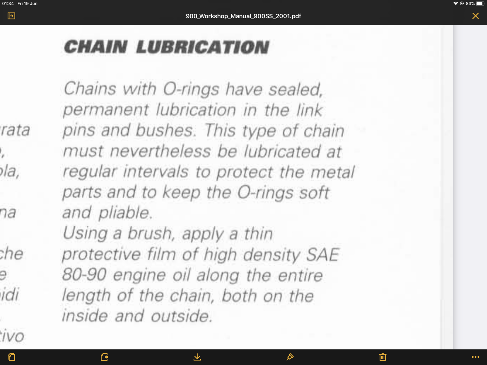

  17. Yes we do need to look again at the diagram that you provided. Also I may have misled you by the incorrect use of the terminology. I should have said bush not roller.
    The inner plates on the chain are held apart by bushes which have a “stepped end” and the hole through the inner plates has a similar but mirrored profile. The fit between the bush and the plate is an interference fit and the bushes do not rotate within the inner plates. The roller is fitted over and rotates around the bush. The pin goes through the middle of the bush and it is the space between the pin and the inside of the bush that contains the lubricant introduced during manufacture that our O or X rings protect from the elements.
    Regina Chains recommend the application of SAE80-90 oil, the surplus to be wiped away after a couple of hours with a clean rag.
