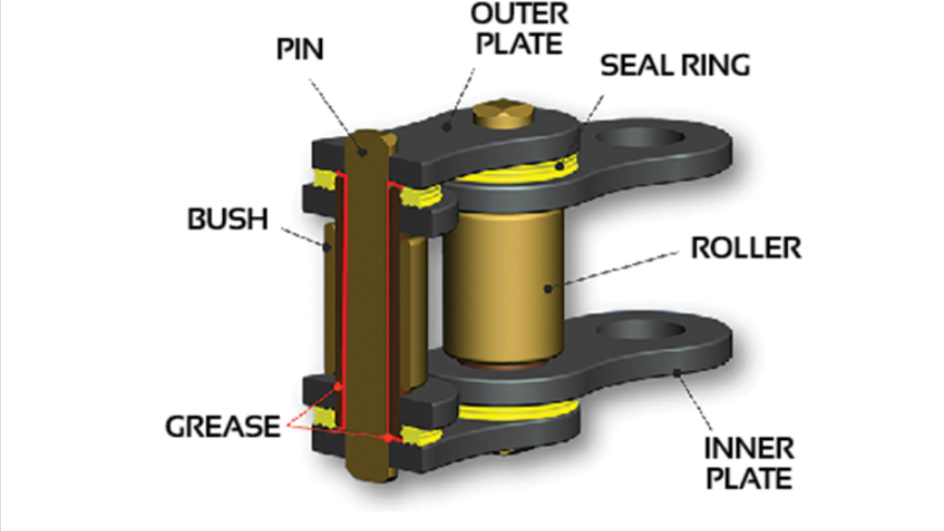

  1. Ha ha, you’re at it now, the roller doesn’t rotate around the pin. It rotates around the bushing and it’s the interface of the roller and the bushing that needs our lubrication. From the videos posted by Alex we will have learned that once the roller engages with the sprocket there is no relative movement between the two it all happens between the roller and the bushing.

  2. OK bushing, the roller should have lube on it inner wall, hows that? :)

  6. Excellent, so do we think that wax type lubes get to that inner wall as well as oil or thinner proprietary chain lubes.
  7. Isnt The bushing and roller the same thing in this picture??

  8. No Rex :)

  9. Are you saying inside the roller... but outside the grease? That darker area is a bushing?
    Rex
  10. From what I understand the lubes, whichever type, are sufficiently thinned by their solvents to penetrate the gaps and crevices where they are needed and you then need to give the solvents sufficient time to evaporate before riding the bike otherwise the still thinned lube will just run out of where you have just sprayed it.

  11. Yes Rex, that’s it.
  12. So, to sum up, it's best to lube the bush area into which the pin slides and rotates and some prefer the wax type of lube whilst some prefer the runnier type of lube but we all have to be careful there's no fling off as it makes a mess :thinkingface:
