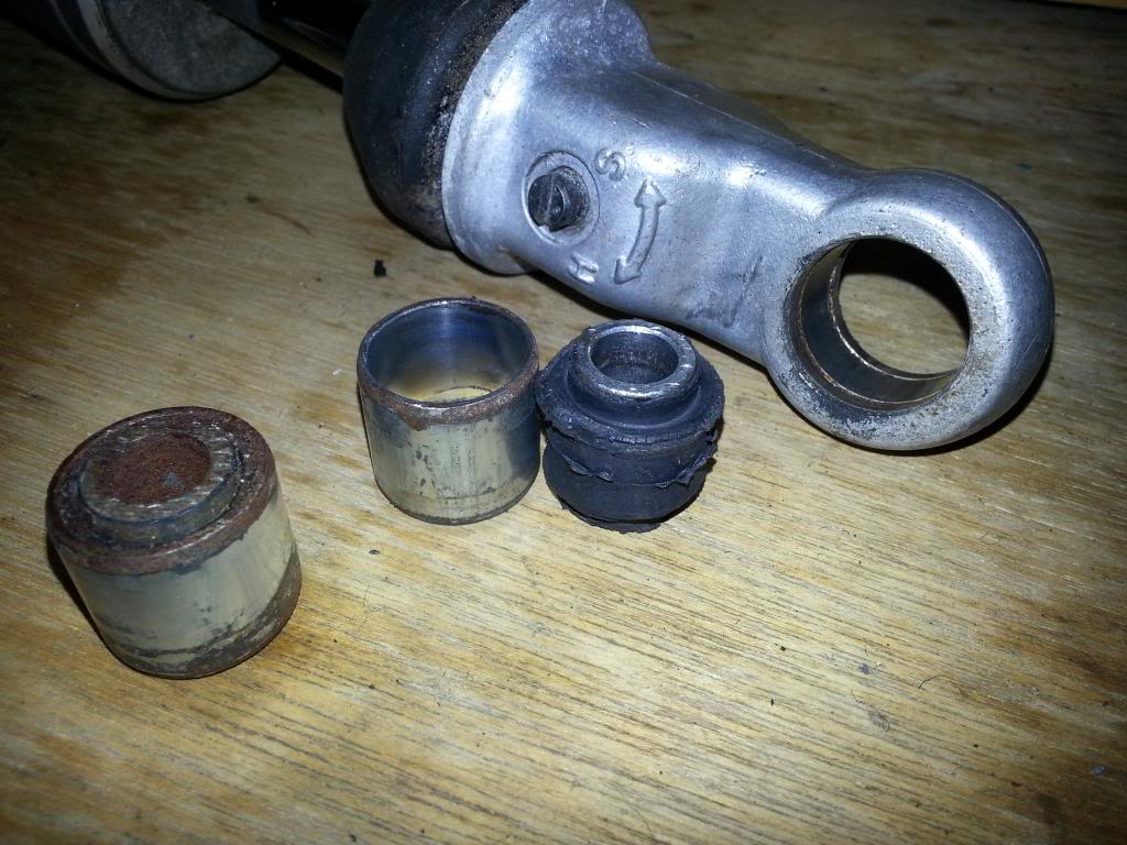

  3. Right - I think that a previous owner has fitted the 'wrong' bushes at some point in the past. I've found that the bushes are indeed a rubber sleeve sandwiched between two metal sleeves, but looking at the shock mount itself, you can see the grooves for the wire retainers that would be used to hold the SB12A bearing. My original idea was to replace the spring and clean up the shock. But now do I, A) Buy two SB12A bearings and go on the hunt for top hats and wire retainers (o-rings not a problem) or B) Say 'to hell with it' and buy a newer Boge shock? I would rather 'A' I think . . .
    The photo below shows the shock, one complete bush and one dismantled bush . . .
  4. I reckon you are right.........
    ......bearings replaced with rubber bushes because some silly git couldn't find the right ones, unless of Ducati fitted them to the very early shocks.......

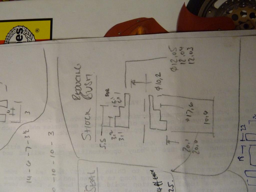

  6. I think I'm going to try and gather bits and go to a bearing place tomorrow and explain the situation. Would there be any chance that Al, Gaz or anyone else that has easy access to them, could provide me with the dimensions or a drawing of the top hat bushes please? From Gaz's drawing I've got the M10 x 20 od dimensions, I'm guessing they're 10.9 mm long but info on the steps etc. would b greatly helpful/appreciated.

  10. I can't access my SHowa ones, because I'm not taking my shock off just for the hell of it, and the Sachs top hat bushes are a different size to the Showas........the Showa ones are smaller O/D...........but if you check with Gaz and his drawing on the right side page, I think you will find his dimensions allow you to calculate what you need.........
    AL
  11. What you want these dimensions - It will cost you.
    May be measure the bearing I.D. and machine to suit to get a good fit. As you can see I measured 3 different O.D's
    Cheers Gaz

  13. As far as I can reall, the 'flange' of the top hat bushes for the Showa are 20mm diameter.
    The 'spigot' part of the bush should be the same diameter as the hole through the bearing, with a 10mm hole right through the bush.
    I'll see what I can measure on my Showa later today......
    AL
