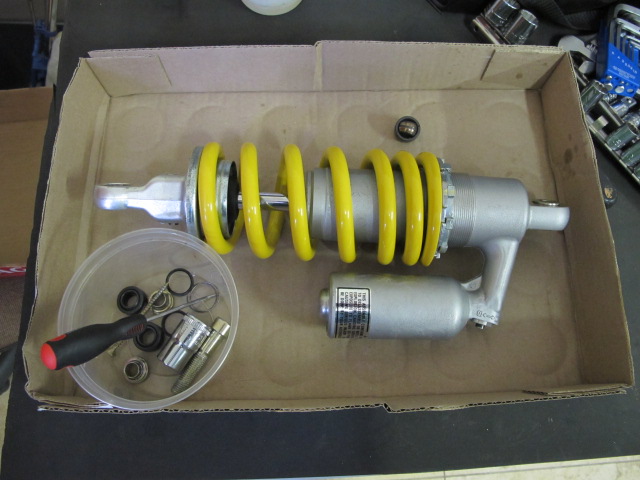

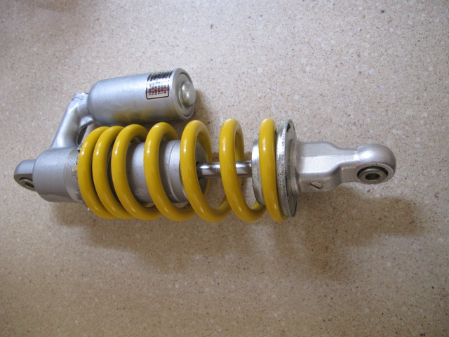

  2. My Showa GD041 lower bush also poked:Arghh:
    Tore the lower end apart, what a mission to get the 2 top hat halves out the bush, removing 2 c-clips and pressing the bushing out went ok.:Grumpy:
    Is the upper bush the same as the lower bush??? IKO SB12A.
    My top bush appears OK, but my OCD getting the better part of me, bought a box of bushes- QTY 5, so might as well throw another one in the top end if the bush is the same.

  3. both bushes were the same on mine
    go on do it you know you want to :Angelic:
  4. Thanks for the info johnboy:upyeah:
    Top and bottem end bushes replaced...:)
