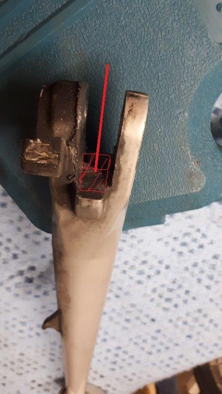

  1. if you look at the Al part ie just the stand leg it pivots around the bolt. So it forms sort of a u shape when viewed from the front or rear and the bolt would go through the u near the top. In the valley of the u is where you add metal. Because this is where the Al part of the stand mates to the steel of the bracket. Ah: that’s as clear as mud isn’t it. I will try to draw something and take a photo.
  2. I have an old triumph street triple stand I will take a photo later and draw an arrow where the extra metal goes, if it looks right should make it a bit clearer, as the stands off the bike
  3. So the suggestion is that the stand, with wear, pivots too far forward towards the front wheel and thus inwards, rather than simply leans too far outwards away from the left side of the bike.
  4. I think I get it now, the plate is added at the closed end of the fork, stopping the stand pivoting as far forwards. So the wear isn’t taking place at the sides as I imagined but on the end-stop, as it were.
  5. Yep. You got it
  6. Where the red line is, is that right?
  7. Yes that’s correct

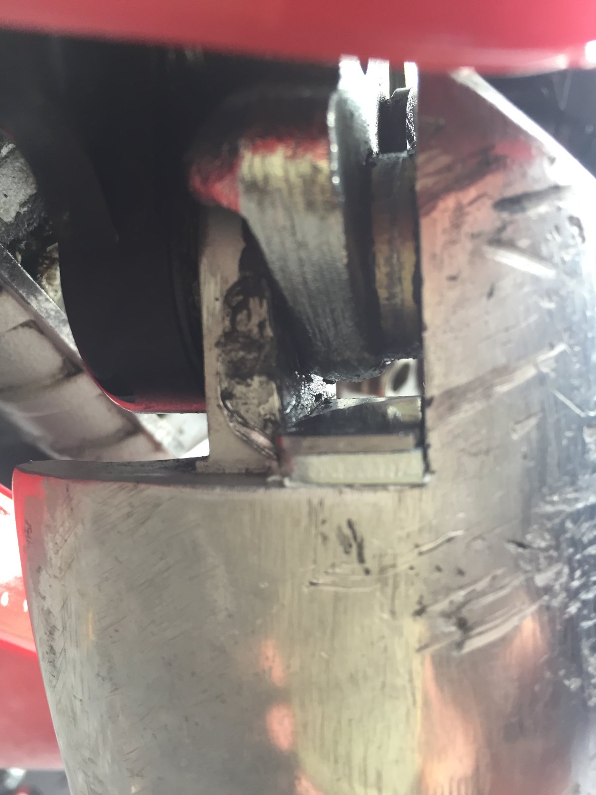

  8. Ok, have made a 2.5mm stainless plate that Is now setting in some of the epoxy marine filler I have extended the stand with. It’s still there btw.
    Sticks like shit to a blanket.
    I was able to do this with the stand in situ, so if it works out it will be an extremely simple, elegant and cheap solution
  9. that sounds good. If it works Any chance to blag a piece of your stainless as I don’t have anything the right thickness.
  10. Tbh I'm not sure it's quite thick enough.
    Looking at the op's pics, his piece looks rather thicker.
    Haven't had a chance to road test it yet, as it were, as I've been waiting for the epoxy to fully harden.
    Will report back

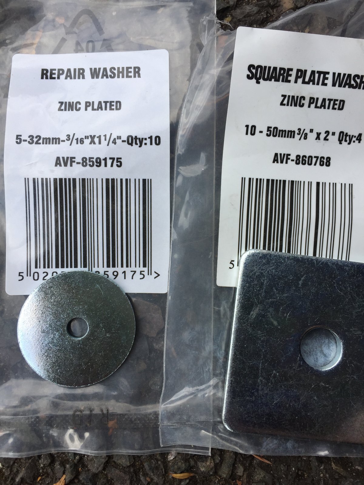

  11. I used an m10 square plate I’ll send a pic and measure it. They’re pence from any builders merchant etc
  12. I used an m10 square plate I’ll send a pic and measure it. They’re pence from any builders merchant etc
  13. My lean is now about right but I have a half inch extension to the end, so I reckon you will need at least 3mm
    It occurred to me that a 50 pence coin might work but it’s surprisingly thin, a new pound coin is too.
    However an old pound coin is perfect - 2cm x 3mm
    So take 1/2 cm off opposite sides of an old pound coin and you should be spot on :)
