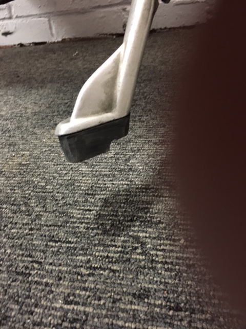

  1. The camera flatters.
    It`s not perfect but it`s not that noticeable. Not in the same way smashed fairings would be if it fell over so I can live with it.
    Lengthening the stand slightly and sorting the bent and loose bolt on the bracket has made a big difference.

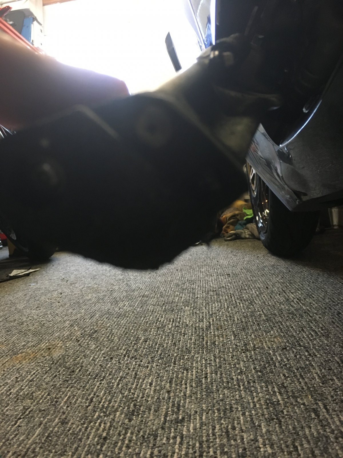

  2. Has the rear ride height been jacked up.
    Sounds like it has

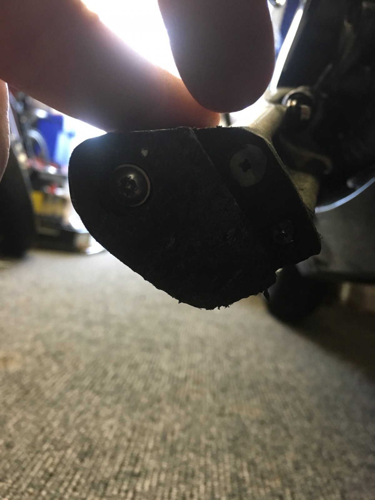

  5. This was already done to mine when I got it, it has a slight notch in it to miss the fairing.
  6. Nice job - can you see how it's attached?
  7. Ill have a look later when I get back.
  8. Looks like whoever did had drilled into the bottom of the stand and fixed the black plastic/nylon piece with a couple of threaded bolts/screws, it works a treat.

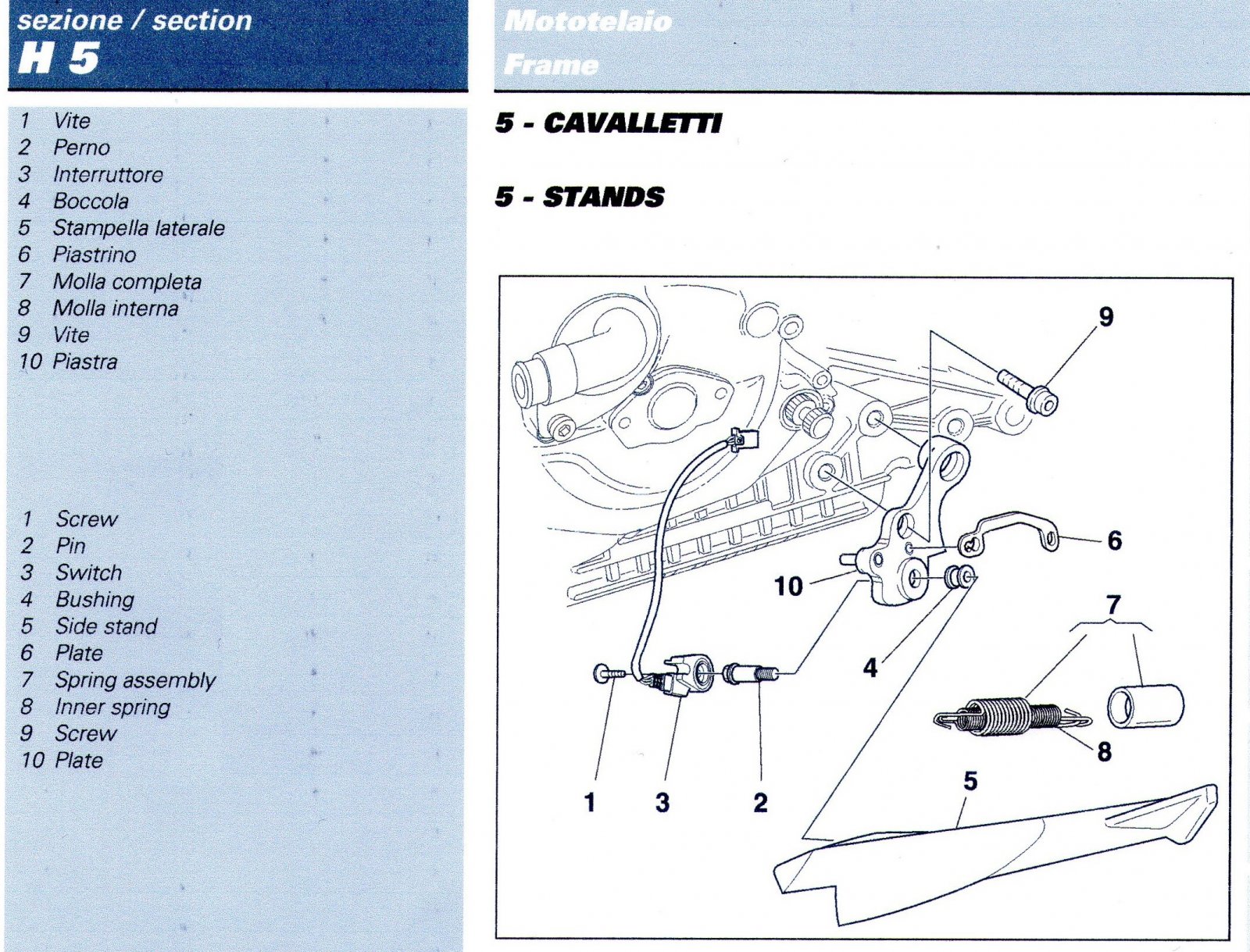

  11. Yes, it was the bolts (9) that screw into the case. One was loose, the other was loose and had a slight bend in it.
    I`m going to have a look at the bushing (4) because the stand has some sideways movement, I think it may have a slight oval worn in it. If it has, I`ll either get it sleeved or get a new bush made up.
    I`m happy with the lean angle I have with the modification I`ve already mentioned previously but, I still don`t leave my bike on its side stand any longer than I have to.
  12. New bush (4) is only about £5, it's the bolt that's stupid money.
