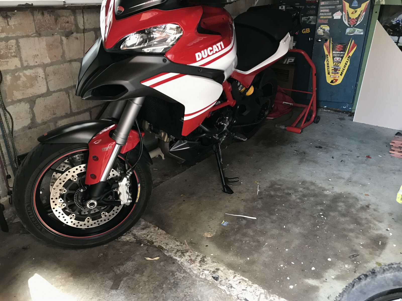

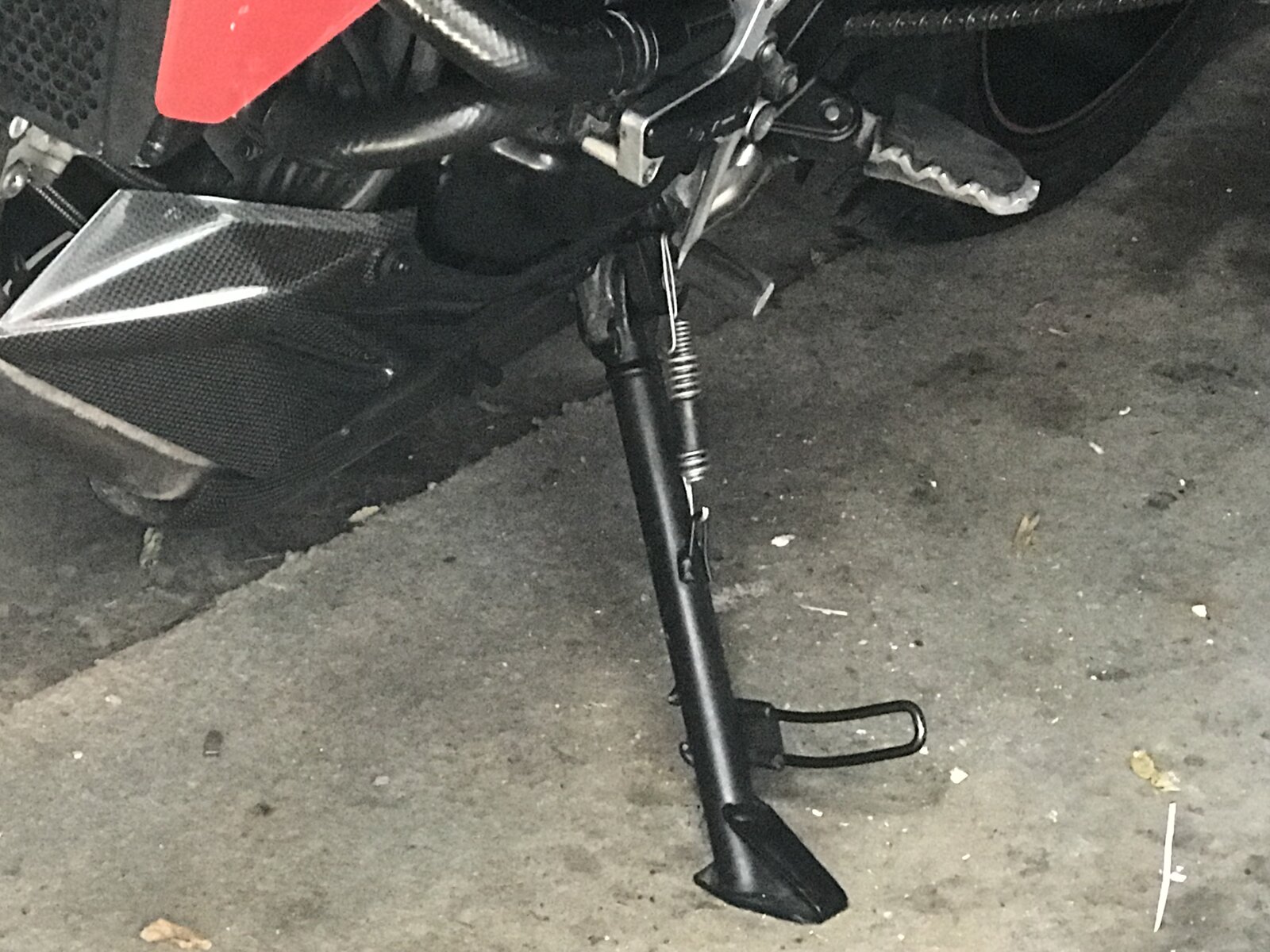

  1. Just to clarify, the stand was made 2.5cm longer, which was perfect; 2.5cm going up inside both ends of the the original stand, hence 7.5cm
  2. My mate has a wooden block on a string. A proper crappy look but it works for him and saves us having to get him upright.
  3. I put mine in the garage today (only picked up today) and had to position it quite far from my racking as it leans quite a bit!
  4. If you'd parked it the other way you could have got it close.

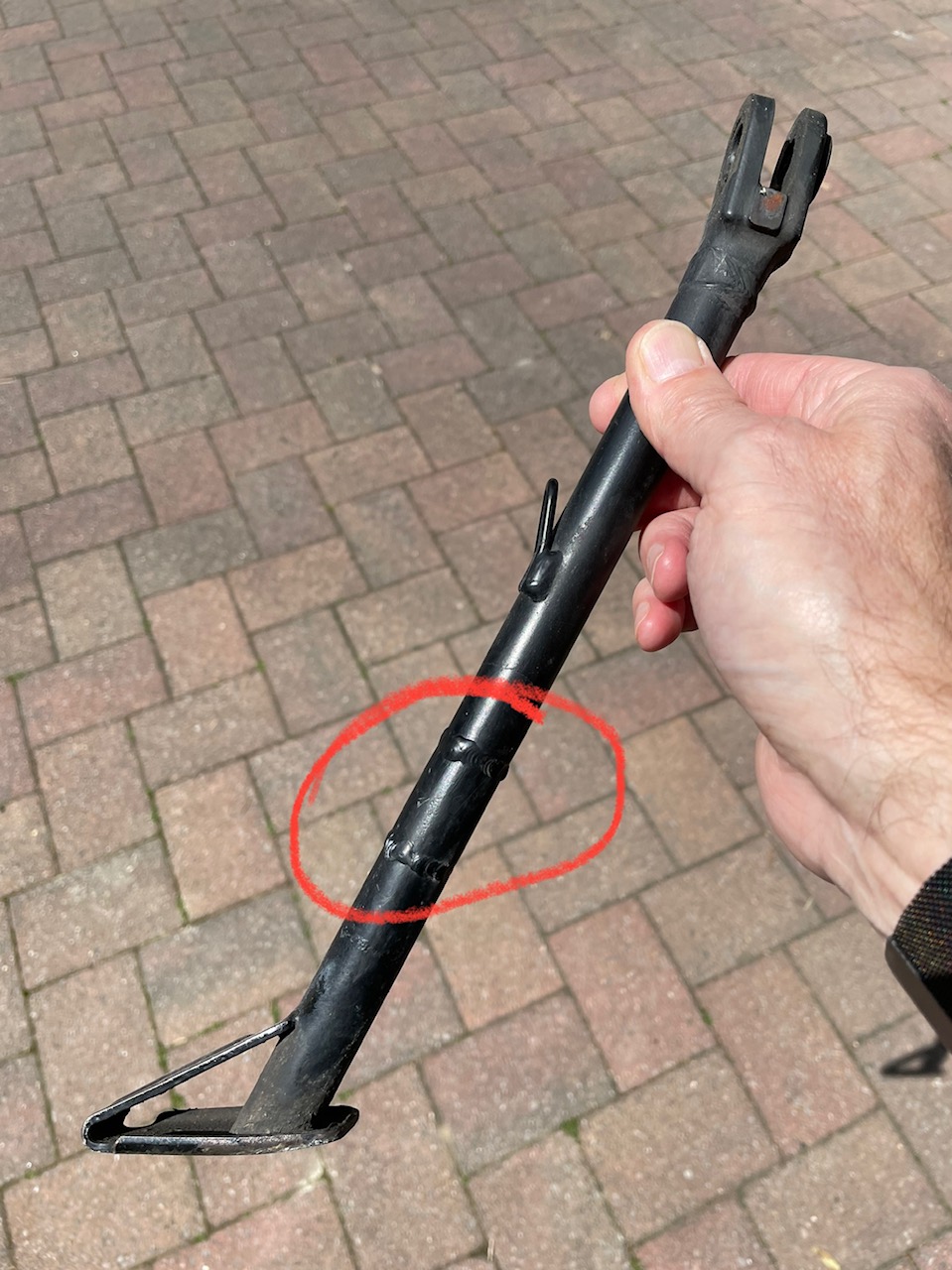

  5. The stand does bend easily, a few years ago a complete fucking goon ratcheting my bike down on the ferry bent it - I had to shout at him to stop!

  13. I have seen 2 original stands fail at that top weld where it joins the pivot!

  18. 2014 model:- I have just completed the +25mm mod as above. I reckon you could comfortably go to 30mm. But +25 is a great improvement.
    edit:- Having used it, I would say 25mm is just the job. post pic added
