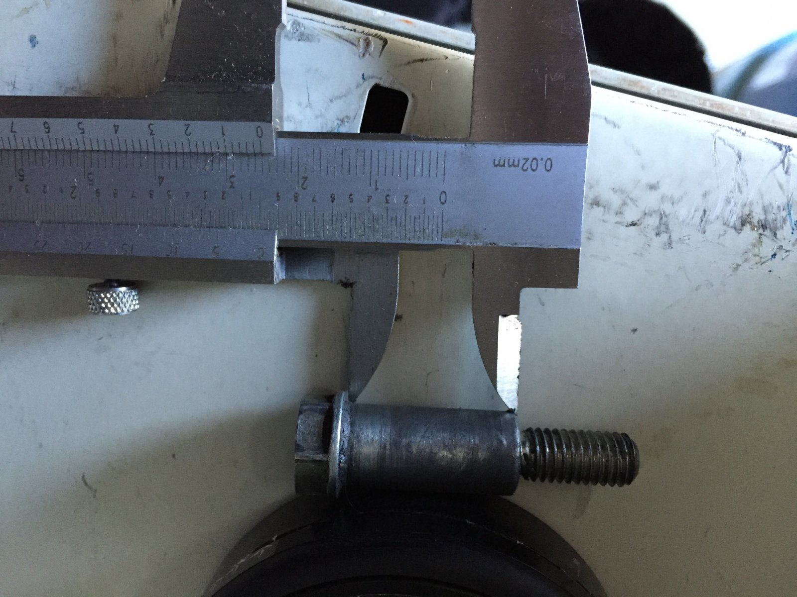

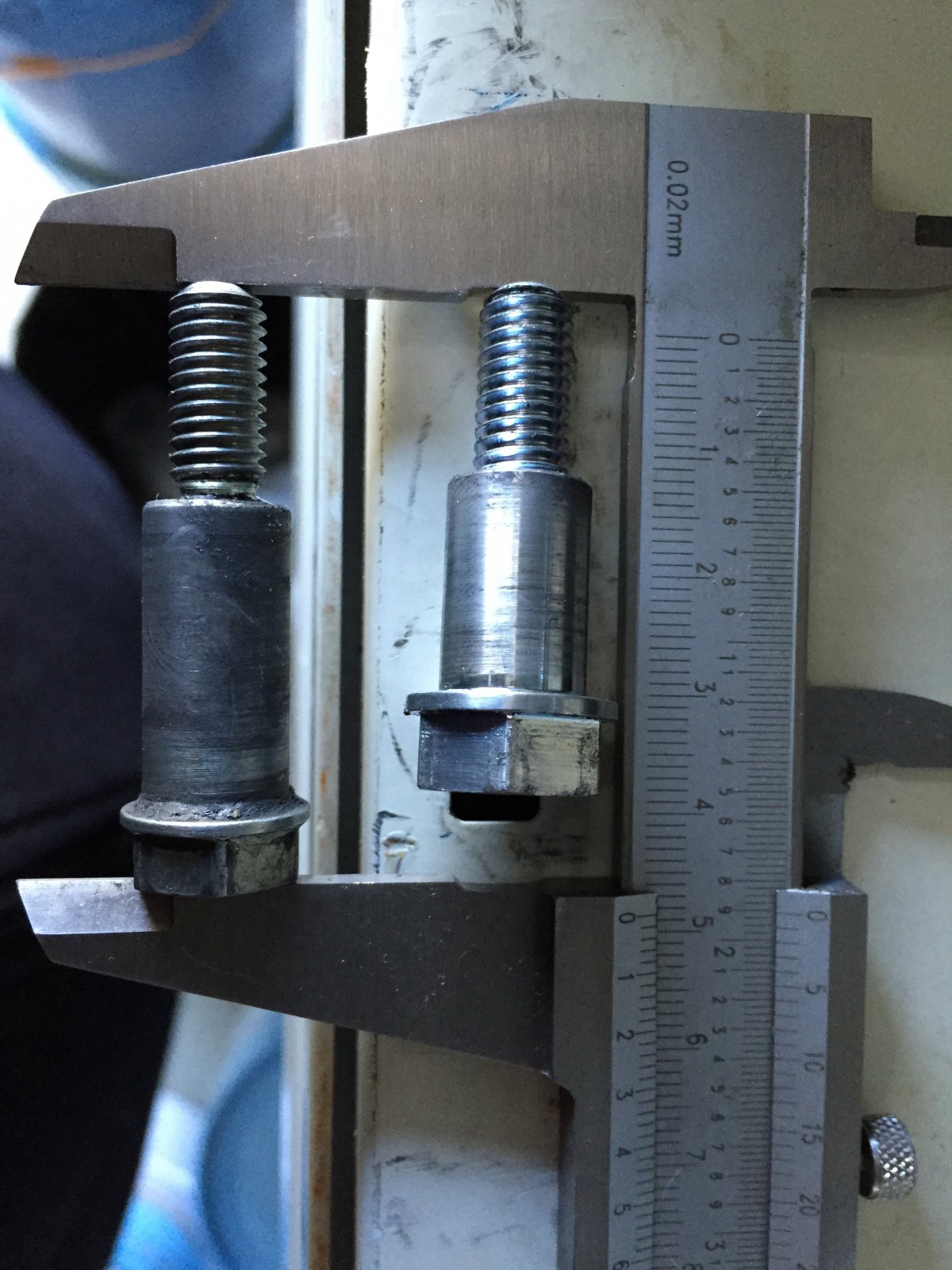

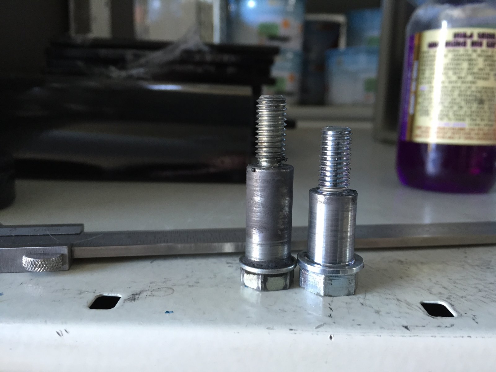

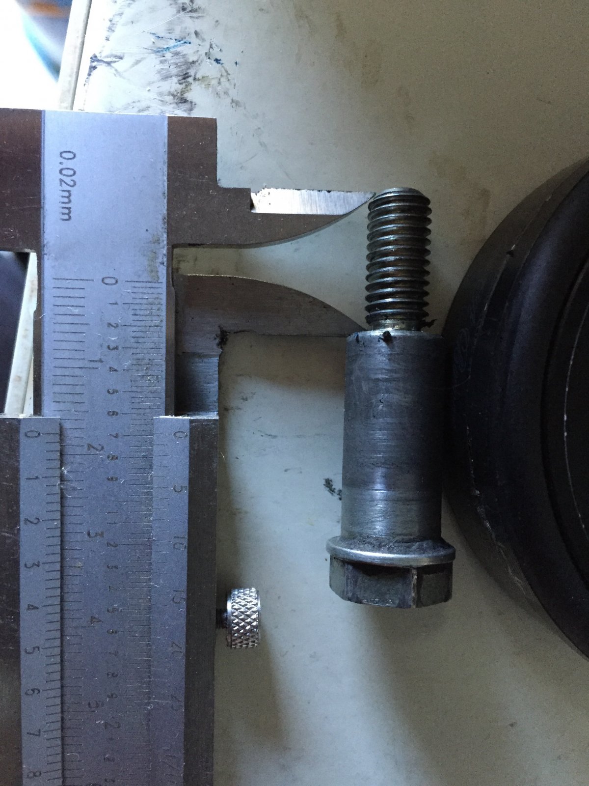

  1. Quite a bit different, slightly longer thread, but longer body, still got the same m4 in the main bolt body, for the switch? Are the main body diameters the same? Are the threads m8?
  2. All the thread are the same, also size of socket what i used is different, OEM 13 mm custom 14 mm.
    But it would fit if it would be a bit longer.
  3. Looks like the part that is on the frame/ case is a bit wider. I would hazard a guess at 3mm longer thread, and 5mm longer on the main section, what do you think?

  5. Yes something like that, cause with this length there is basically none threads coming on the side where you put the nut.
  6. I'll figure out the differences, fundamentally they are the same design, so, costs should be similar. I did notice the new oem bolt is badly designed too. All that leverage on that thin section, it's bound to snap
