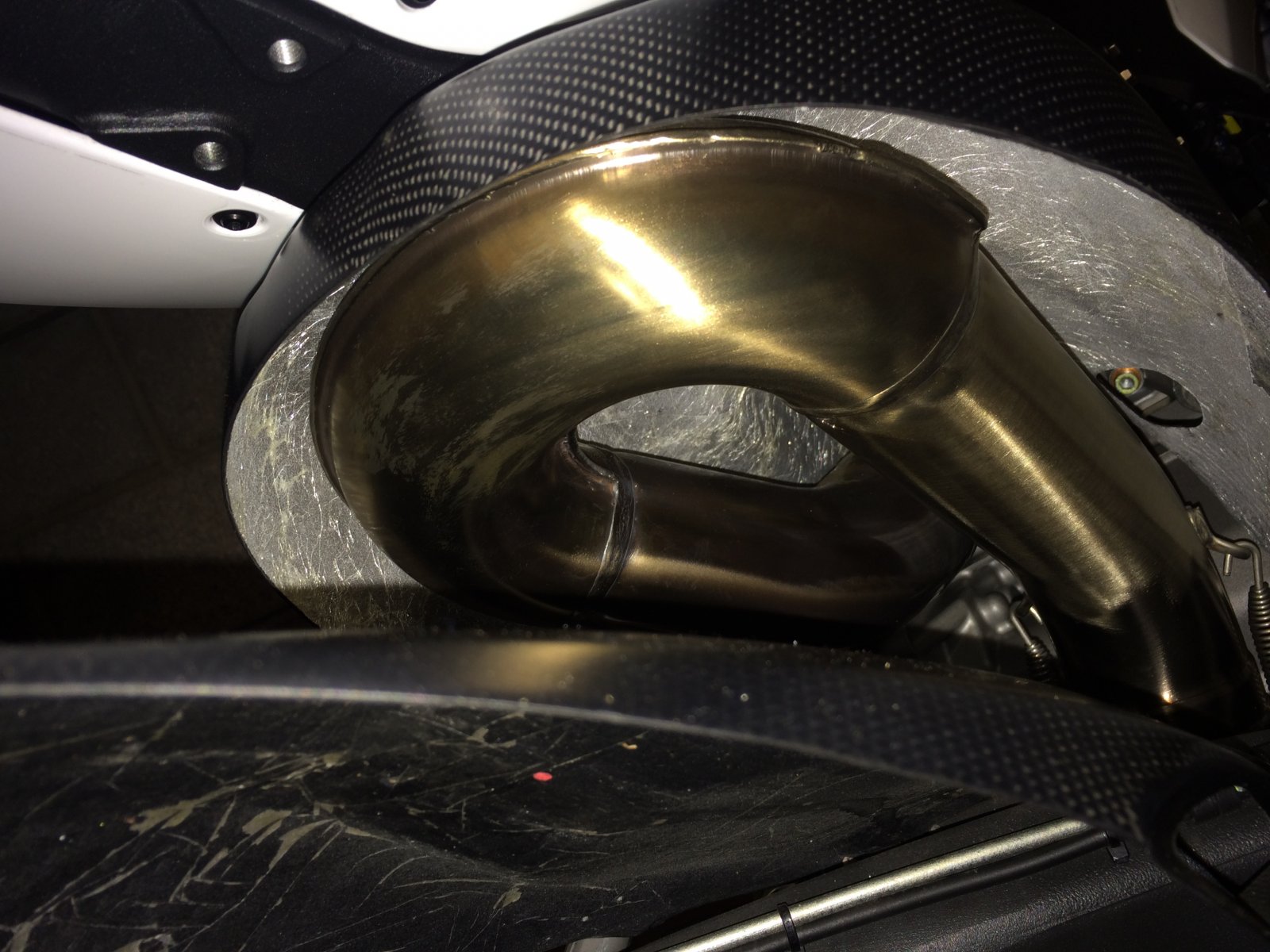

  4. Ah ok, were they ever taken off before? When I removed mine there was a 'cut to fit' fibreglass sheet between the cans & Alu slip on covers. Maybe they were removed by the previous owner?

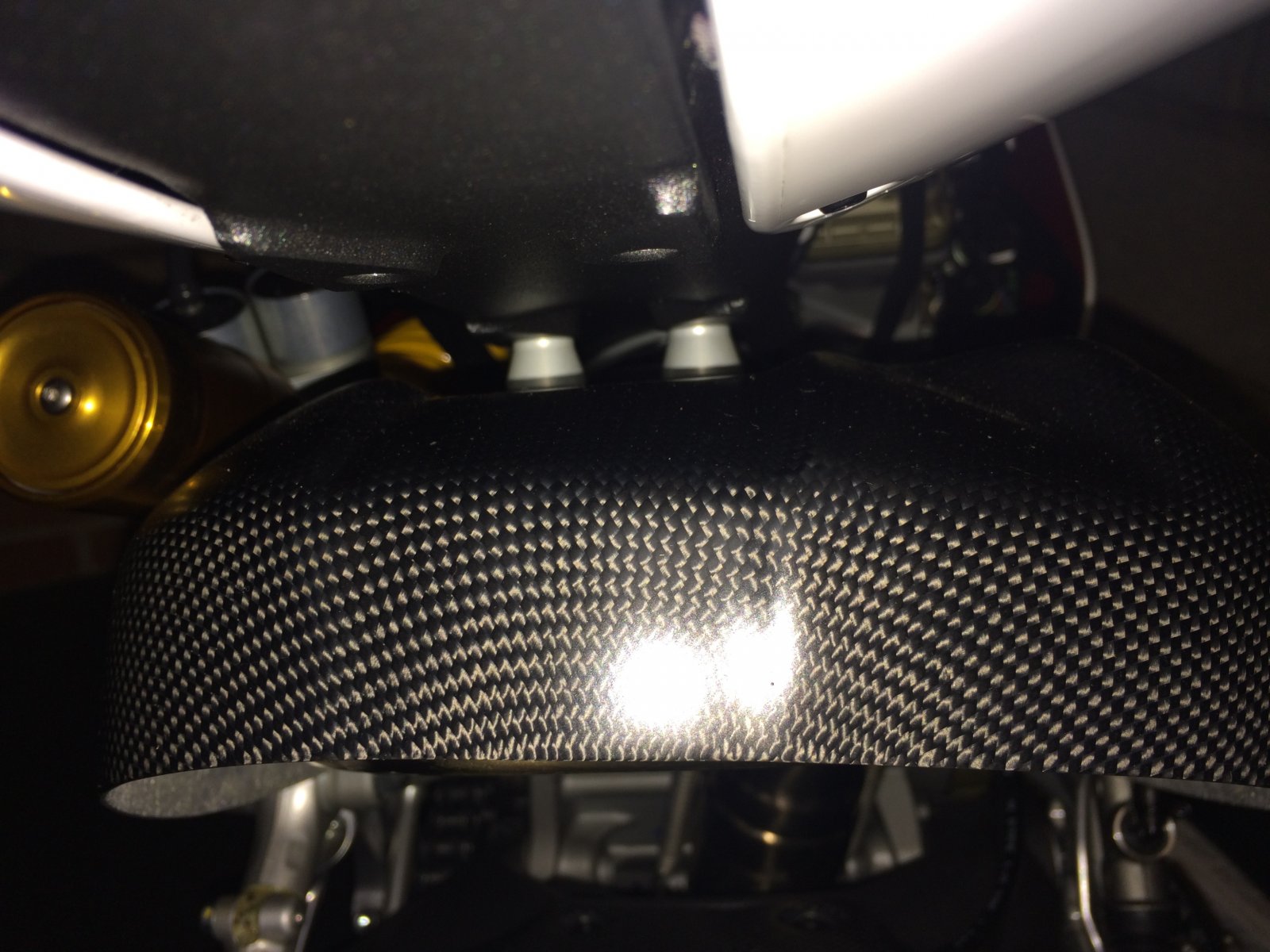

  6. I just did my standard heat shield and purchased all new bolts carbon washers ect came in at about £30.@750steve if you look at my panigale bits for sale thread you will see I have a superleggra Carbon heatshield for sale, I bolted this directly to the subframe but I had to drill a hole in the subframe easy job to do and it still looks mint after 2 years a much better solution, when I get 5 I will dig out my standard 1299 heatshield and see how it is mounted at the front.
    Edit, just been to have a look and there is one further mounting point on the subframe towards the exhaust manifold, so to fit the 1299 shield you would need to drill one hole in the subframe.

  8. I have never read anything good about carbon heatshields but the sl one has stood up well, I think maybe because on the 899/1199 the carbon is so close to the exhaust but when it is bolted to the subframe its a lot further away from the exhaust, I just had a standard 1199r carbon one fitted it was £240, I am selling the sl one for £100. image.jpeg image.jpeg

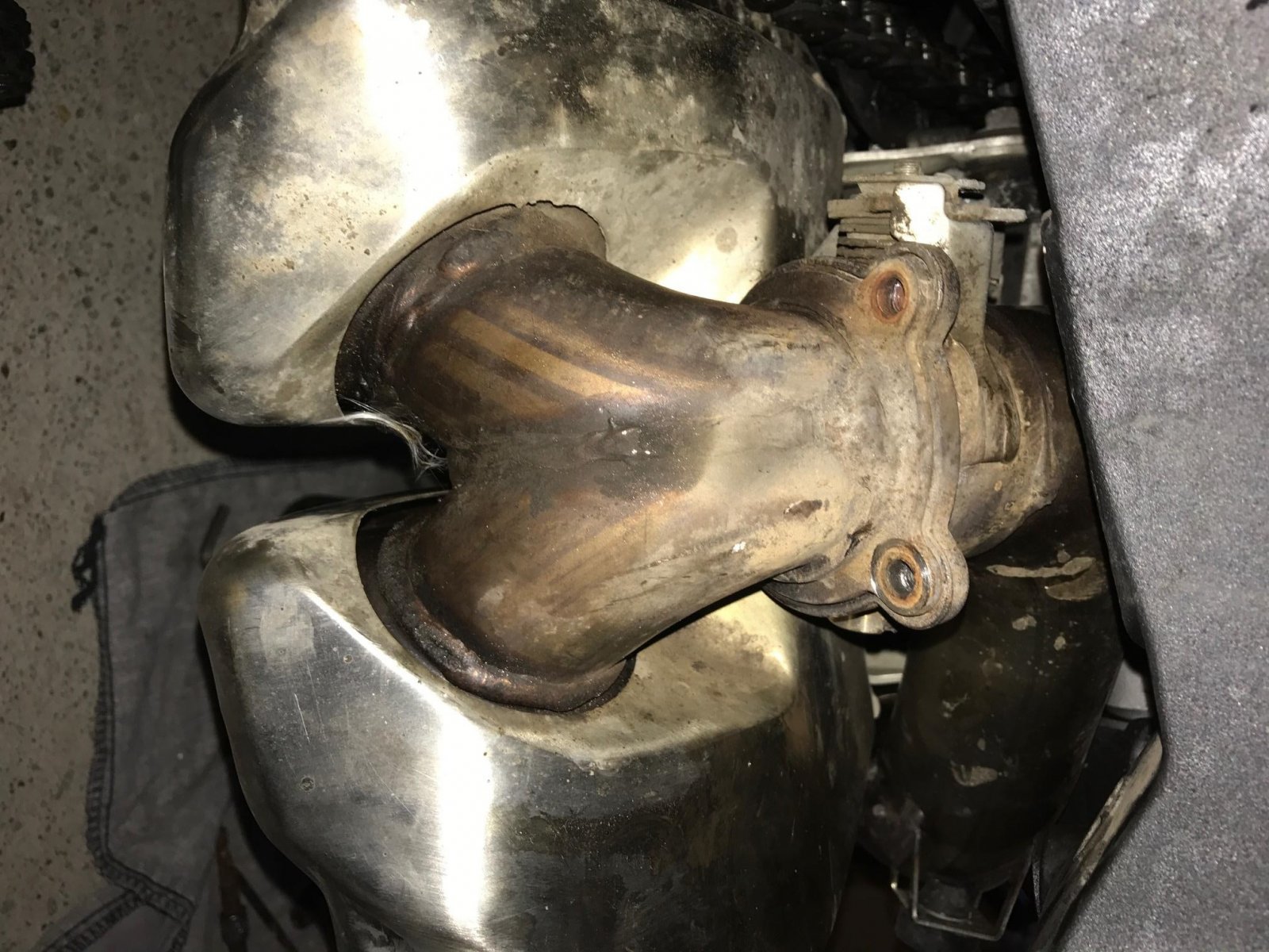

  9. After beginning what looked to be an easy job, I am now searching through threads for advice after it all went pete tong at the first hurdle!!
    After letting my frustration get the better of me, I have rounded off the 3 flange bolts! As someone has mentioned, it would likely be alot easier if I took the rear wheel off but I dont have the axle socket required! I assume this can be bought from my local ducati dealership? I'll need to do some shopping tomorrow by the looks of things.... or I could take the easy way out and book it in with the professionals.

  13. I never got past the 3 flange bolts (the 6mm allen head ones where the silencer joins the header pipe), even with the rear wheel off and loads of penetrating oil on the bolts they would not move, even with heat and a pair of mole grips on them. I get the impression from viewing previous threads it will end up with the complete exhaust off, rear subframe off etc.

    After spending another 3 hours in the garage, I have now hut a dead end! I managed to get the top left bolt out, sheared the head off the top right, and totally rounded the bottom bolt.
    How on earth can I get the bottom bolt out? As the gap between the 2 silencers is narrow, I cant even use a socket extractor on the head of the bolt. Is there any other options or will I need to purchase a long drill bit and just drill it?
    I assume if I was to drill it, I would have to re thread it afterwards?

  19. If I was in your shoes I would probably get a long drill bit as you suggested and try and drill the bottom one out. I don't think there is anyway of getting an angle grinder or mole grips near the bottom nut to snap the head off if I remember correctly. At least then you can get the silencer off which gives you some space to re-drill and tap the 6mm threads into the downpipe flange section that remains.
    Another word of advice, be careful when you remove the two 8mm bolts that hold the silencer to the engine case, you need to remove the gear lever side foot rest to get good access to the bolt. If you try and get it out from an angle you will round the head off and then it's a major nightmare job to sort out. Use an allen socket set and make sure it is a good fit before you try and loosen it.
