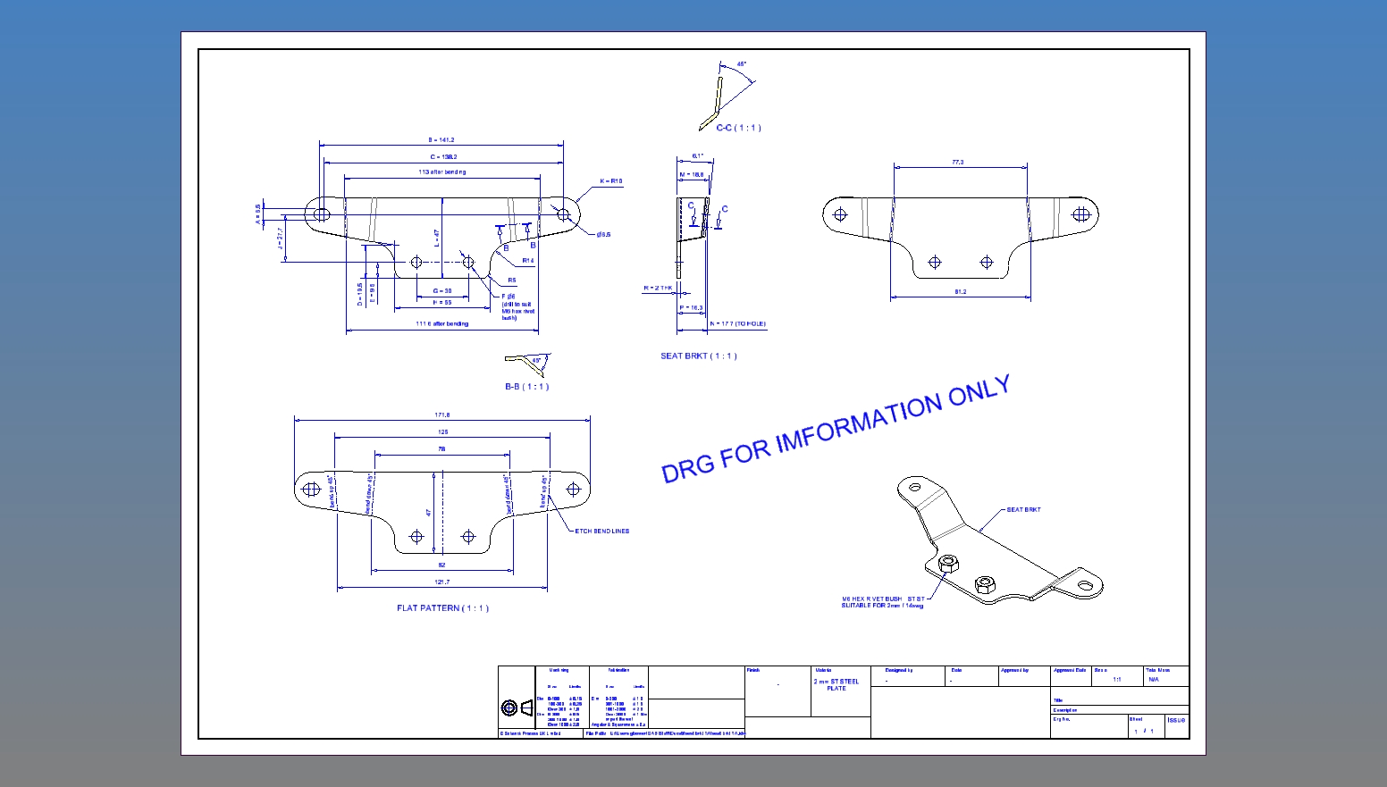

  2. Hi guys, I've just bought a SL single seat from RicambiWeiss for my 95's SS750.
    Now I have to make 2 front support brackets. I intend to cut the shape from a 2mm steal sheet (is it tick enough? ) and bend it myself.
    Sooo here comes the question of dimensions... no offense gaz92, has anyone tried to make the brackets with these dimensions and do they fit?
    I would also really appreciate it, gaz92 if you send me the Autocad files :)

  4. Those drawings I did were to make a very simple full size paper template, you could then make up two of these brackets which a few people have done to good effect but Gaz's version might be a tad more accurate than mine ; )
    Which ever one you use it won't be too far away and there is quite a bit of tolerance in the fitting : )

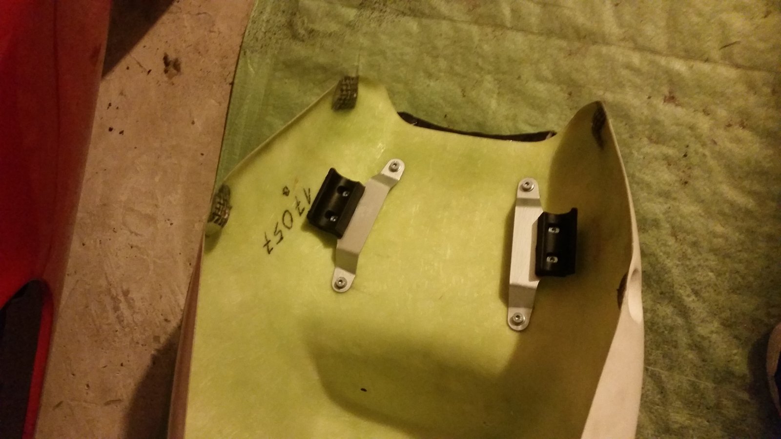

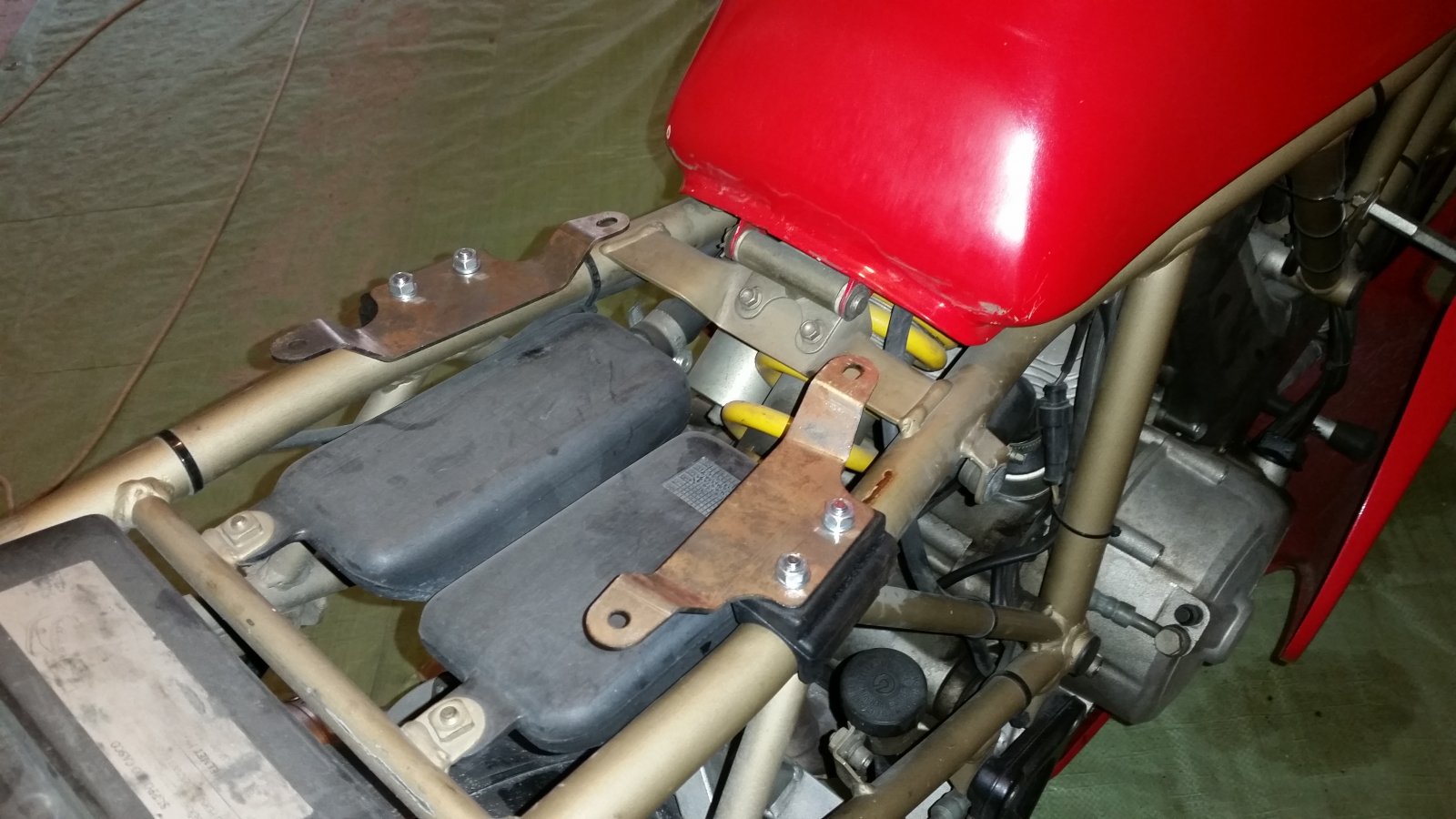

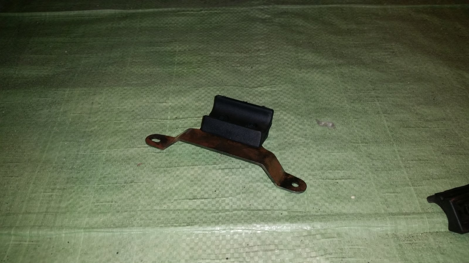

  5. Hi guys! So after some delay now everything is done and here is the process with some pictures included :)

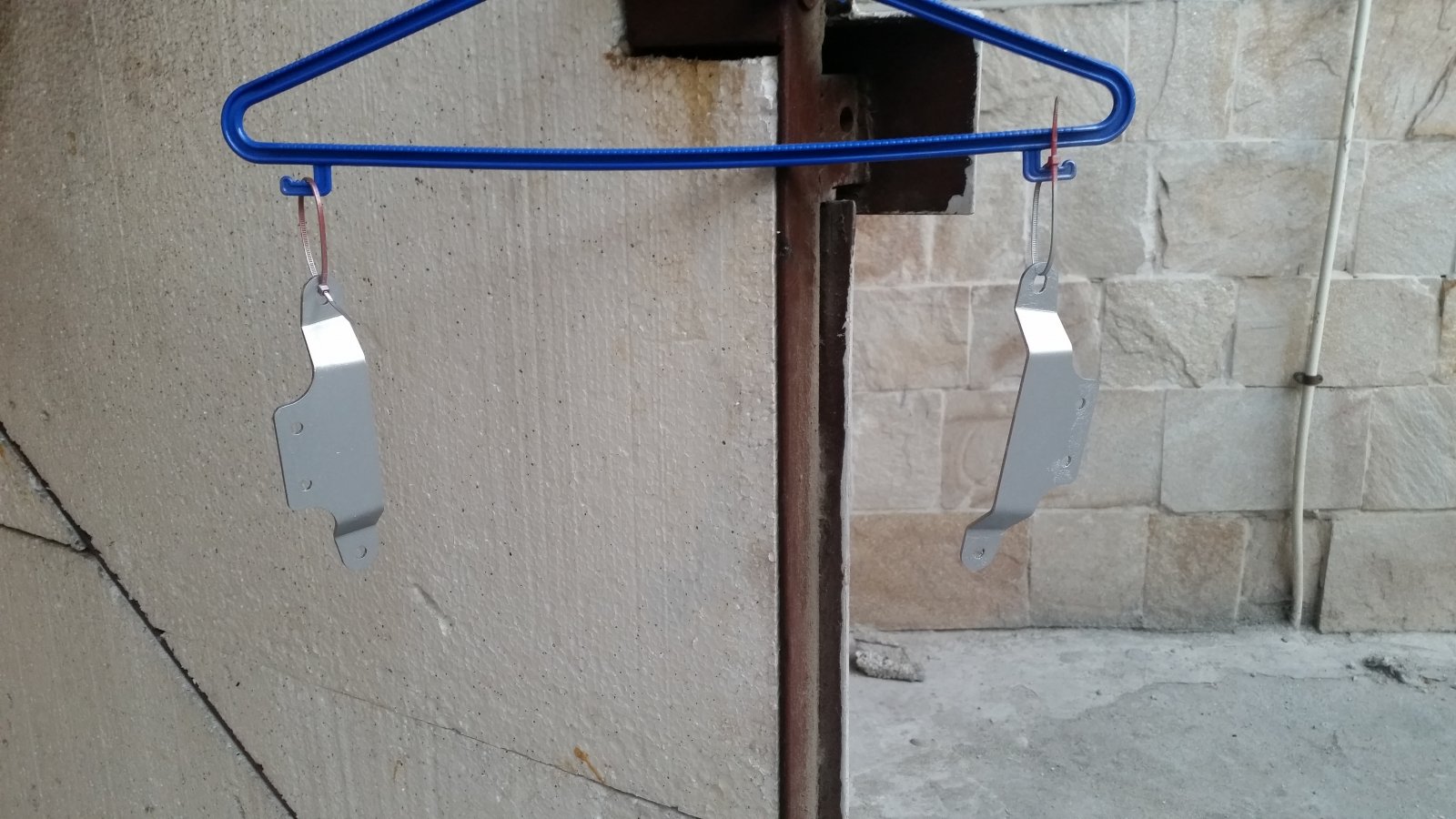

    First I cut with laser from regular 2mm steel (stainless steel wasn't available at the moment) the brackets, following the dimensions from Gaz's Autocad files. Then bent it with an abkant press (I have no idea if this is the right term of the machine). Then I mounted the rubber pads (OEM 86610111A - it's the same part as the tank pad) and here is the result:
    Placing the brackets and deciding where to drill the RW seat was a tricky process, which required some patience and prays, but in the end with some final manual adjustments everything fitted just fine:

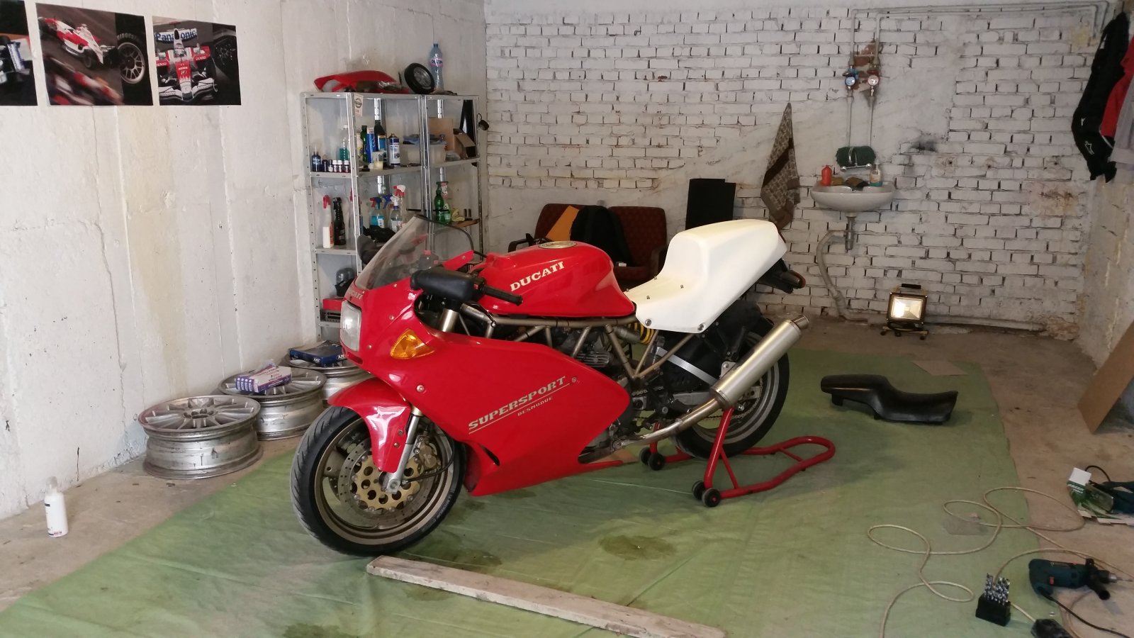

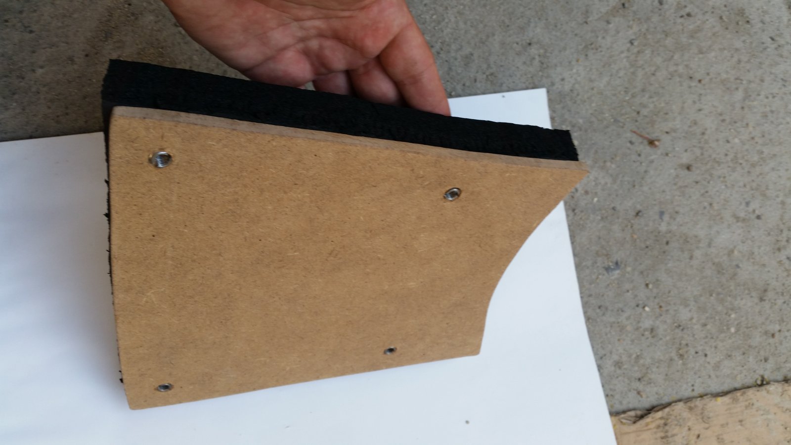

    Then I made an extra hyper turbo budget seat... not bad for a first attempt btw: 20150913_152618.jpg
    Painting the brackets...removing the 'rat' look :) :
    Mounting everything together and final check before painting the tail:
    And the final result:
    I would like to thank you all once again and especially Gaz, whose help and assistance were extremely valuable!

  6. Daniel,
    Realy please it worked, it looks like a bought one. Did you have any support to the rear of the seat or does it feel OK.
    I wonder if the bracket could be improved by joining the bits together to give a bit more strength.
    Cheers Gaz
  7. I haven't put anything on the rear for now. Everything fits really tight, so I will drive for a while before deciding whether to add any additional support or not. The first test drive for 150 km didn't show any problems ... apart from scratching the paint of the tail with my knee guards :(
