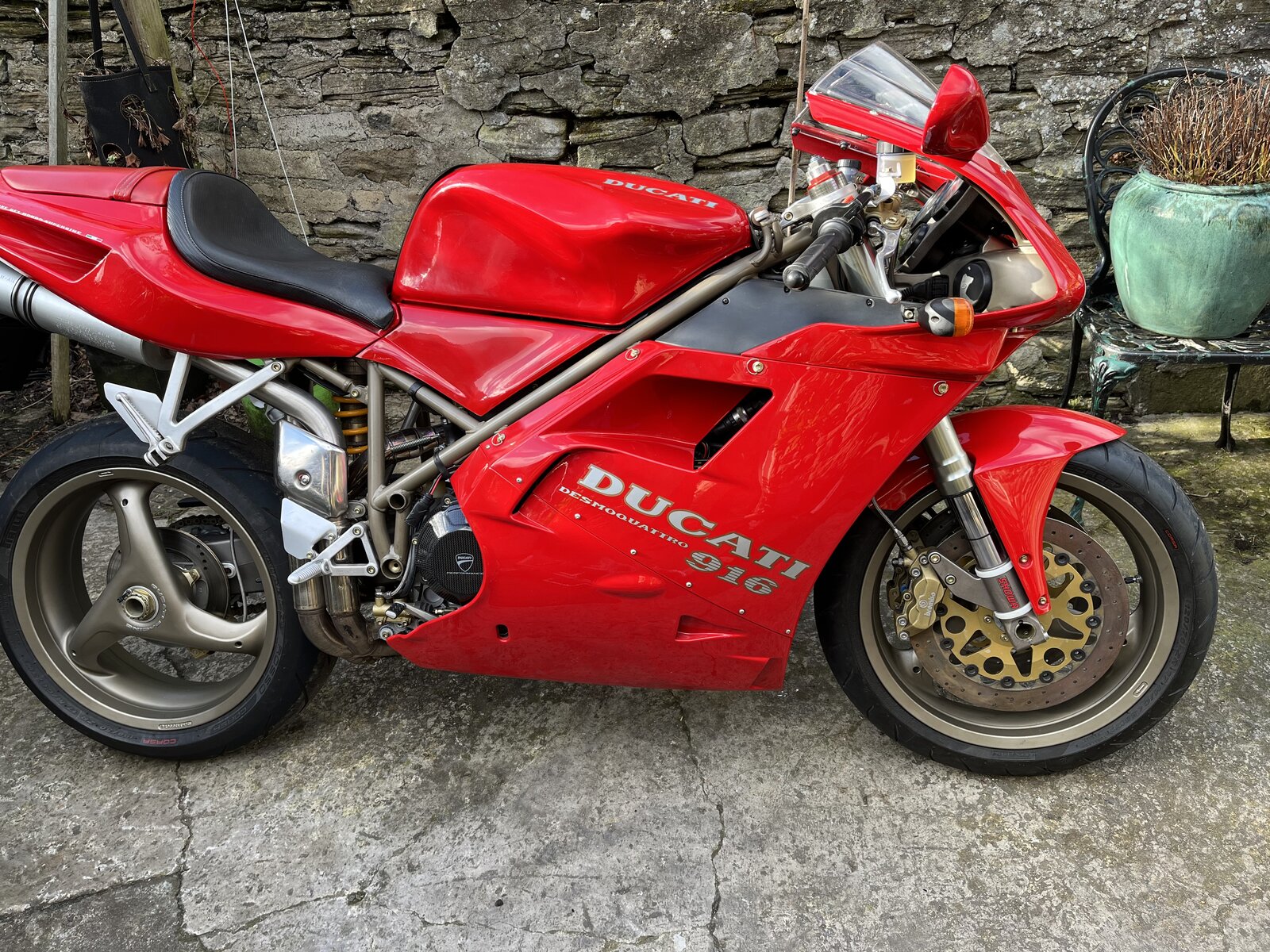

  8. 94AA8B1B-B245-4575-ADAE-DD83D584A95A.jpeg Fitted a pair of 90s era cast iron brembo disk rotors to my 916 to replace the slightly warped oem ones. Found PO hadn’t applied any grease to the front axle so it was a bit reluctant to come out. All greased up as per manual on reassembly
