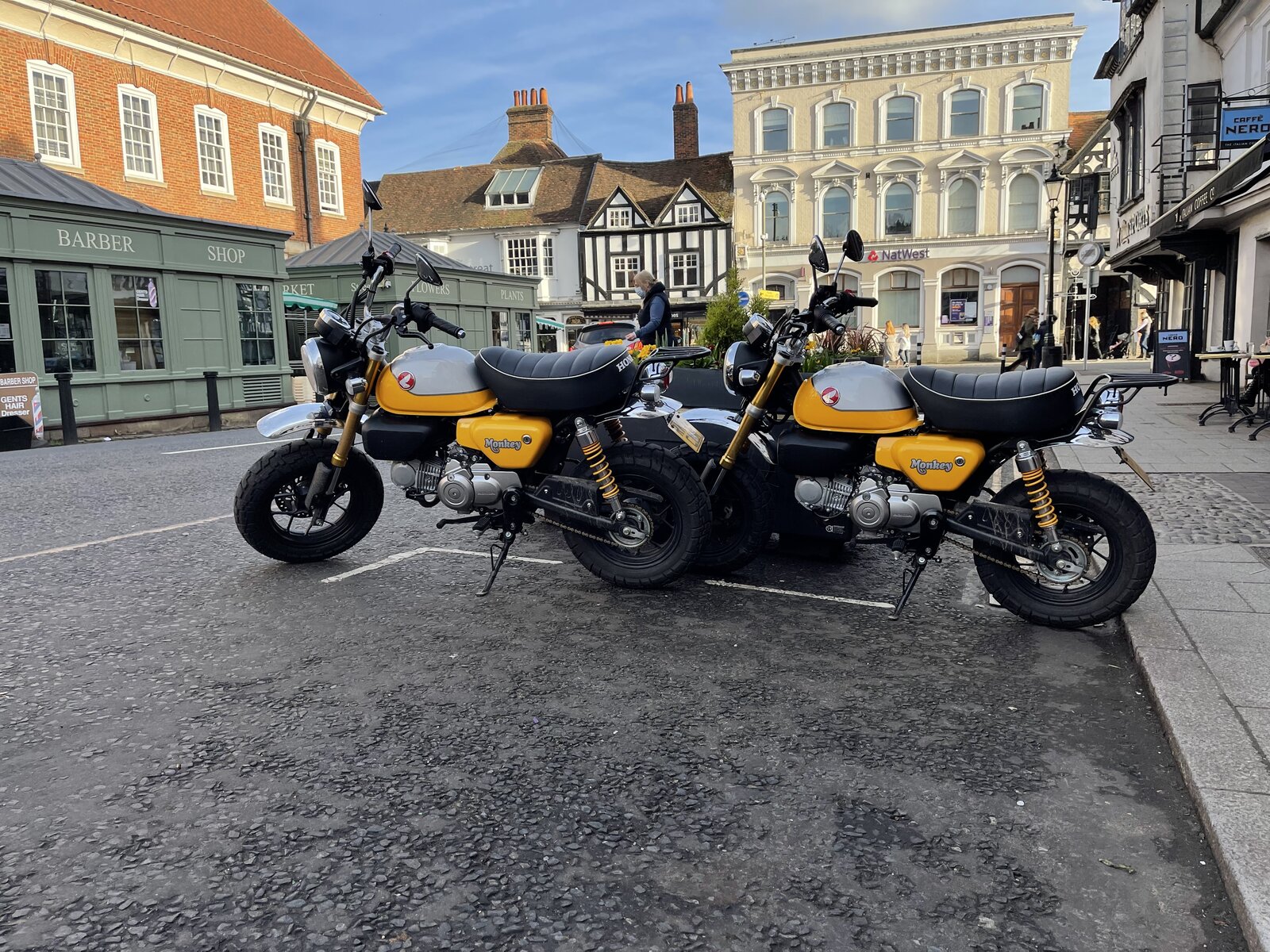

  1. Had PPF stuck to both bikes today, tank sides only. Then gave both my bikes a good clean and polish, works or art! :heart_eyes::cool:
  2. Had an hour out, with summer gloves on. Turned the heated grips down from high to medium. Roll on spring.

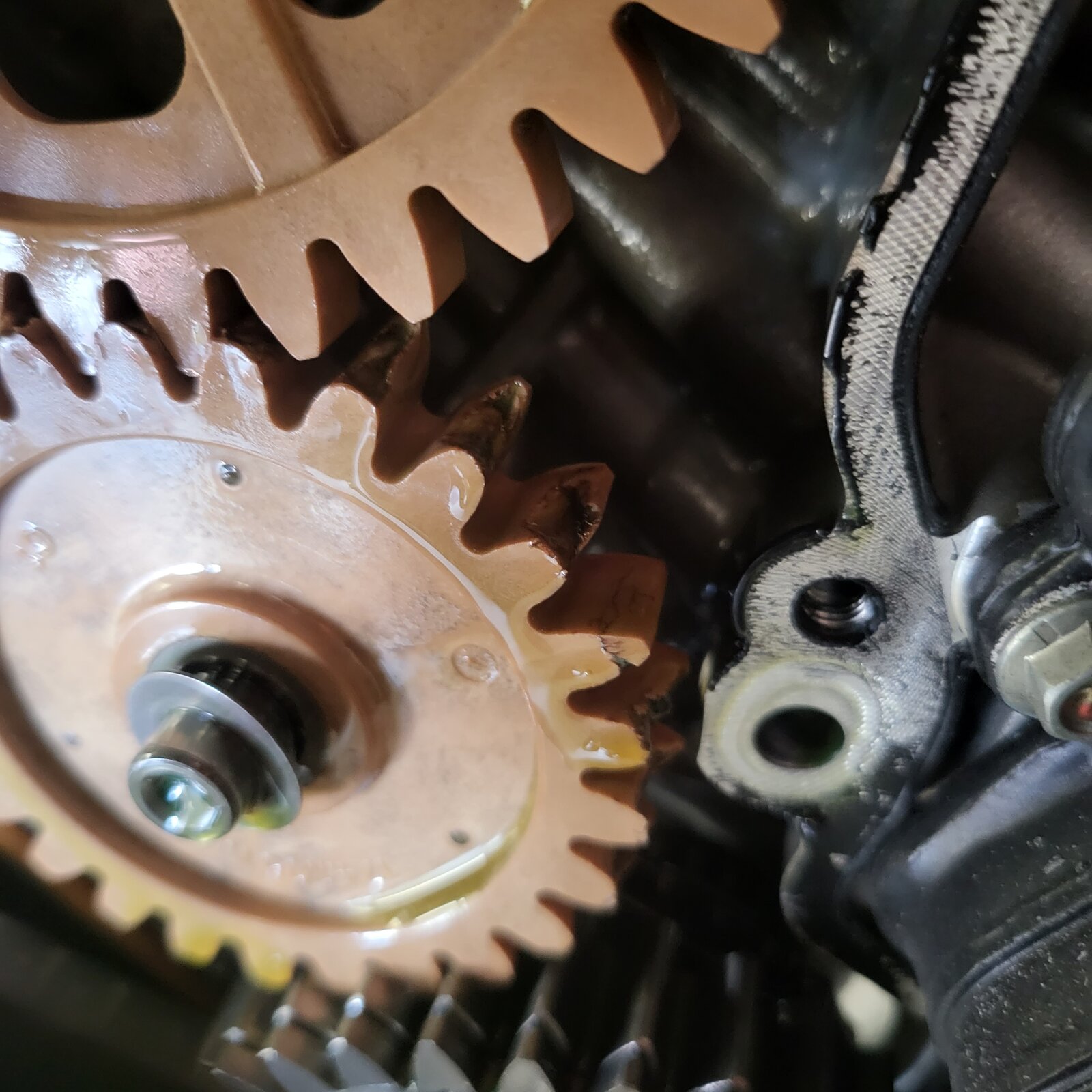

  12. My panigale this time. :mad::mad::mad::mad::mad:
    • Useful Useful x 2
  13. Oh dear but at least it looks like you caught it before it self destructed totally. Andy
  14. Fully expecting to find bits when I changed the oil. Less than an hour to get it stripped :joy::joy::joy:
    Steel gears and a new water pump time I think.
  15. Ordered a Profi Cat, line laser, chain alignment aid/tool from Bikemart in Cornwall. Did the business on-line about an hour ago and just got email notification that it is in the post. Looks like I'll be checking the Scrambler's chain alignment later in the week :D Andy
  16. what were symptoms if any?
  17. Nothing except yellow plastic bits in the sump.
    I would say that you get no warning until the gears fall apart. And if they haven't done so by now, they will eventually.
  18. lucky escape then, doesn't look like it was good for many more miles. I remember similar with inferior timing-belt tensioners on Vauxhall twin-cam engine.

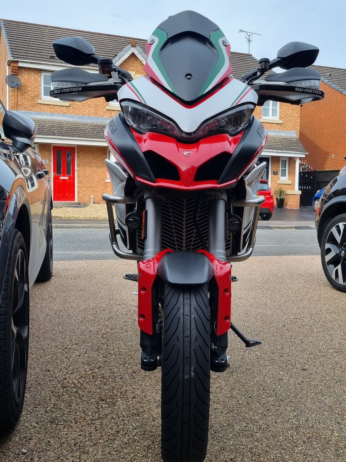

  19. Fitted a Puig Touring Screen to the Multi 950.
    Seems a lot better turbulence wise. The whole front unit is quite noisy though which is annoying....
  20. Just done the opposite, removed my puig touring screen and fitted short carbon fibre screen. Think it looks more aggressive/better.
