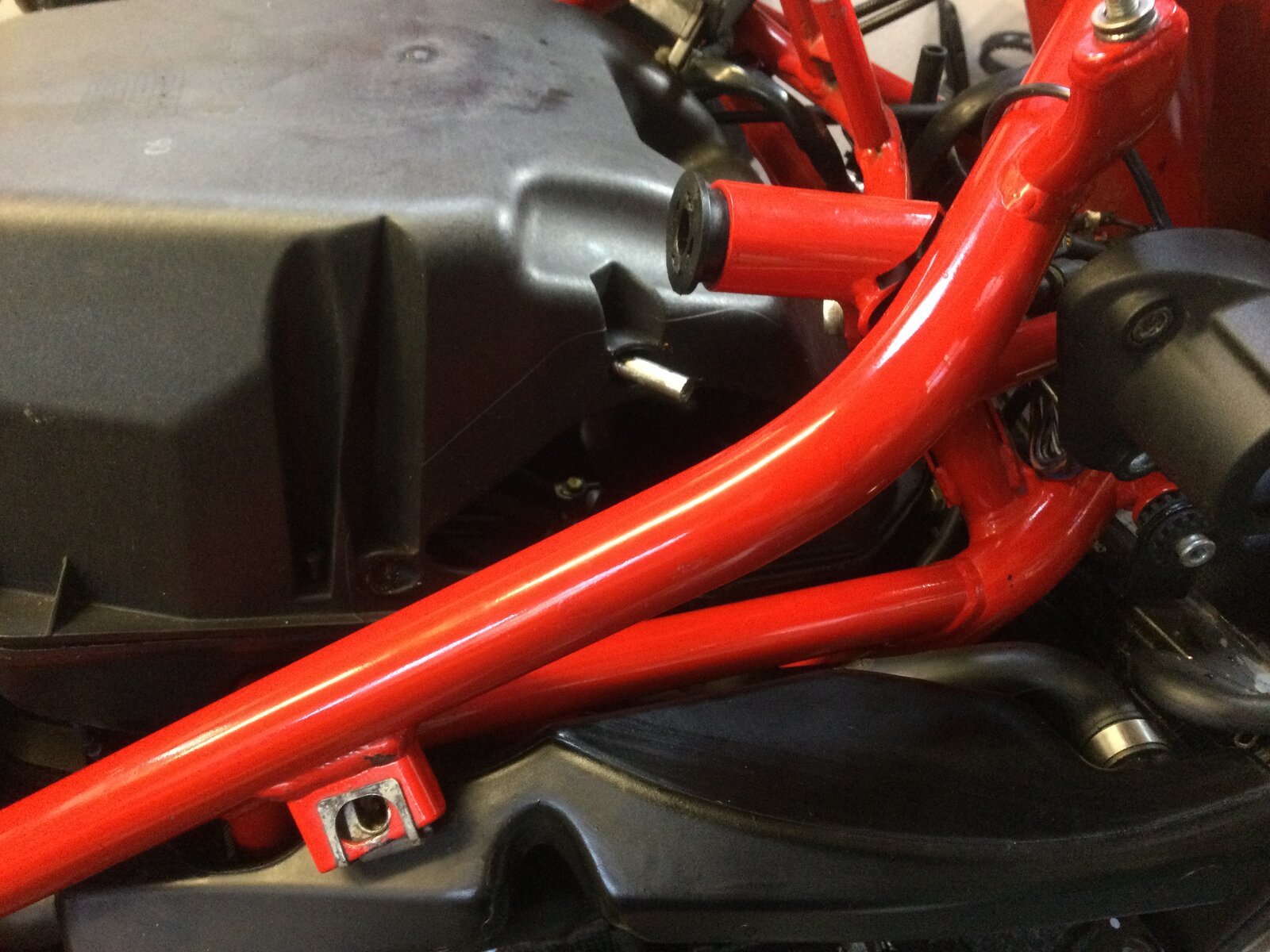

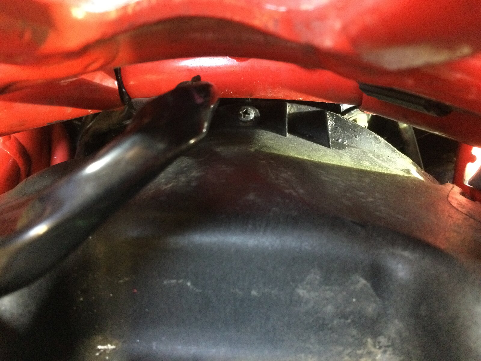

  7. Had a moment to spare so thought I’d clean the air filters on my 749.
    Don’t you just love Ducatis? 5 of the 6 air tube bolts removed…one had the dreaded brass insert rotation so wouldn’t come out…
    Get drill, drilled head off leaving the bolt still installed in the insert but at least the air tube and filter were off.
    Thought - I know, it’s not a 1098 so I’ll remove the air box lid and tackle the insert on the bench…
    All the screws removed apart from the farking ridiculous one at the front…
    Tried a stubby screwdriver- no chance.
    Tried a super long screwdriver but the ignition switch was in the way.
    Just remove that then…what a hassle, the domed nuts came off a breeze but the studs…shit a brick…previous owner/dealer/twat had rounded off the hex and loctited them in good and proper so had to resort to mole grips to get them off.
    Once off…super long screwdriver still won’t engage on the screw due to slight angle!
    Question - how does one get that bastard screw out??
    6CBFB36E-4EDC-423B-8AD2-2255E3269A9E.jpeg 7910E661-D68C-445C-B933-CB9C6A7AB8C5.jpeg

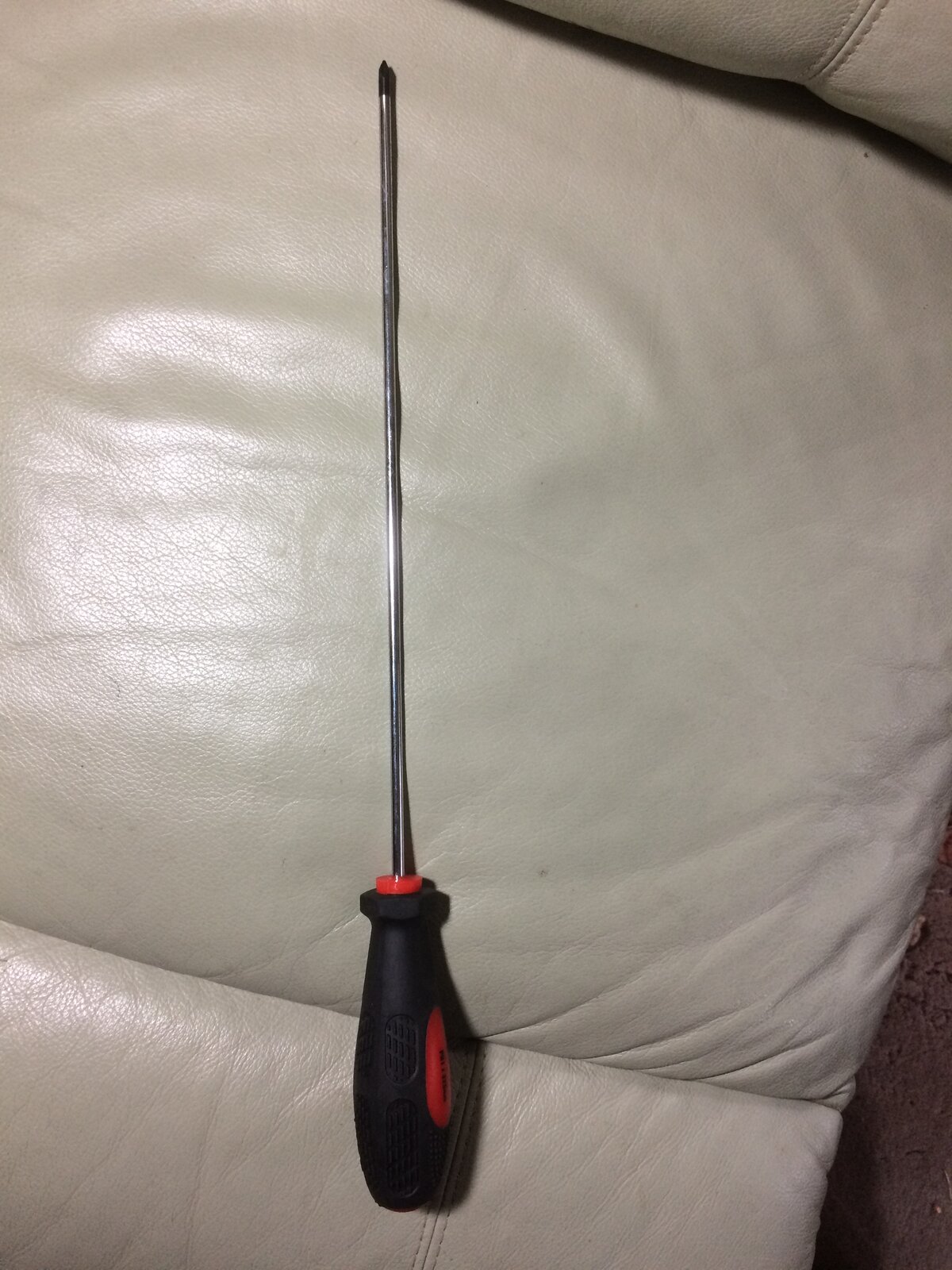

  8. 7D7CE86C-8B03-42C6-AB6E-6853715BBA3F.jpeg looks like head not chewed yet R, surprised you can't shift that looking at it, probably don't need to ask but would be double-checking on myself:- does screwdriver tip "fit like a glove"? I think I would be tempted to protect the red frame paintwork, and have a few, light to medium tapitty taps on the end of the screwdriver for starters unless it really is that misaligned.. might be worse than it looks in picture. When you say that you can’t get it on squarely enough, is it because the body of the screwdriver is still fouling on the frame or is it a fuck off big long one like this?

  10. Screwdriver tip engages but won't turn the screw as it's not in line with screw and I don't want to mash the recesses in the screw.
  11. understood, you saw my added note? Best see what others suggest or new thread even.

  14. It’s a fuck off big long one like that. No fouling of screwdriver handle on frame.
  15. in lieu of other suggestions.. :thinkingface: if you find a screwdriver "bit" that is a really snug fit in screwhead, and you have a nice "stiff" 1/4 drive extension, or even one of those bendy spiral wound attachments, you could try it out to see if you can act on the screw without slipping. (after a few taps LOL)
