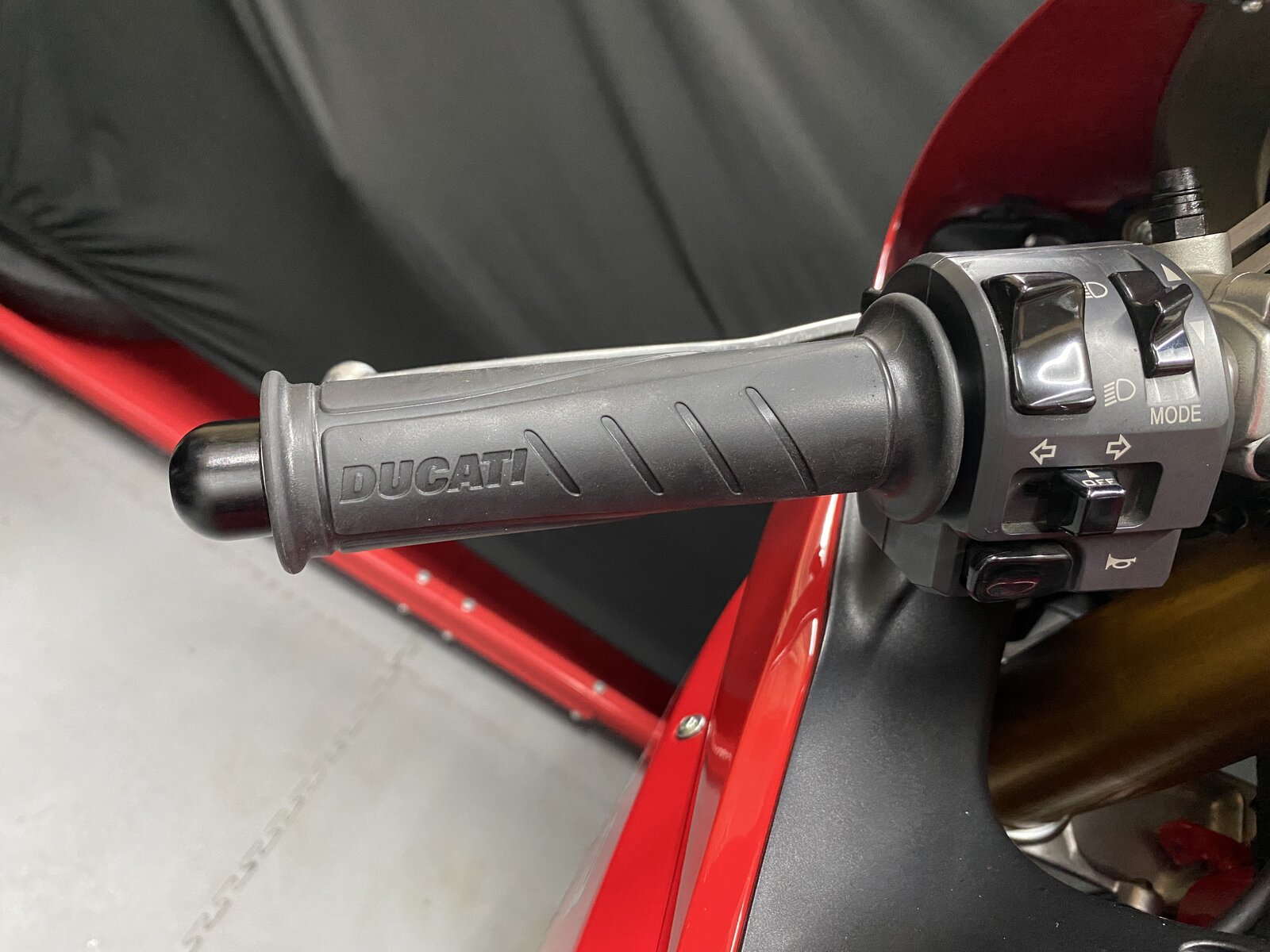

  9. Fitted new grips to Mrs Slingy’s 848 compliments of @Andy800 . Old grips were starting to wear and Ducati want to sell you a complete throttle assy for the 848. Turns out any 22mm Ducati Grips fit for a lot less than the £90 off Duc want !
  10. #bitobvsreally
  11. Absolutely, I asked a couple of dealers and they insisted the grips from other models wouldn’t fit and I needed the correct part numbers which was whole shebang. I was pretty confident that any 22mm grip would fit so sorted some from Andy, and waddaya know …they fit as expected !

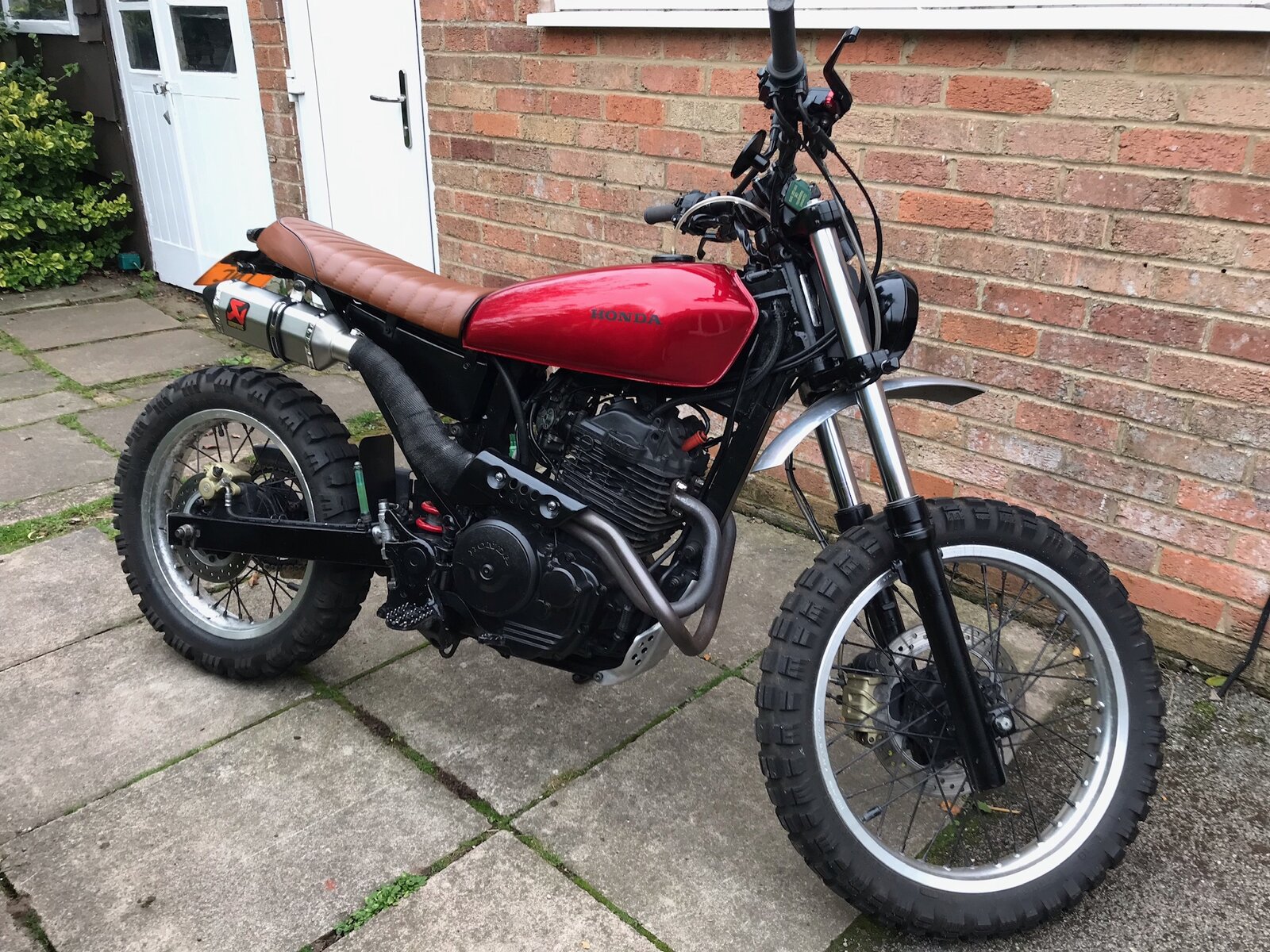

  13. Nice :upyeah: and what was/is it originally please?
  14. It’s a Honda 650 Dominator (well actually a Vigor but essentially the same bike). I love the Domi engine but wanted something that had a classic look so I built this. Sounds amazing!
