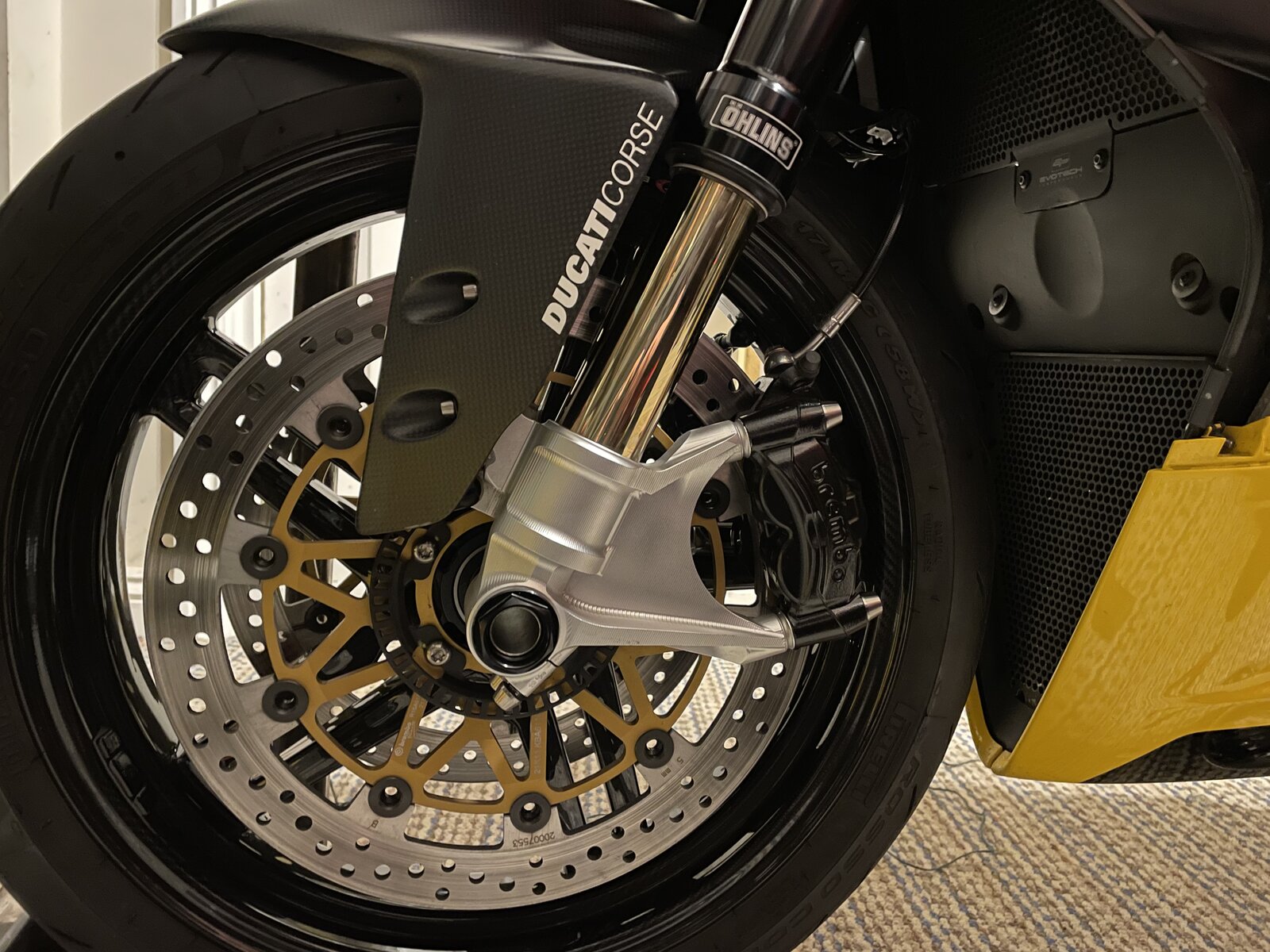

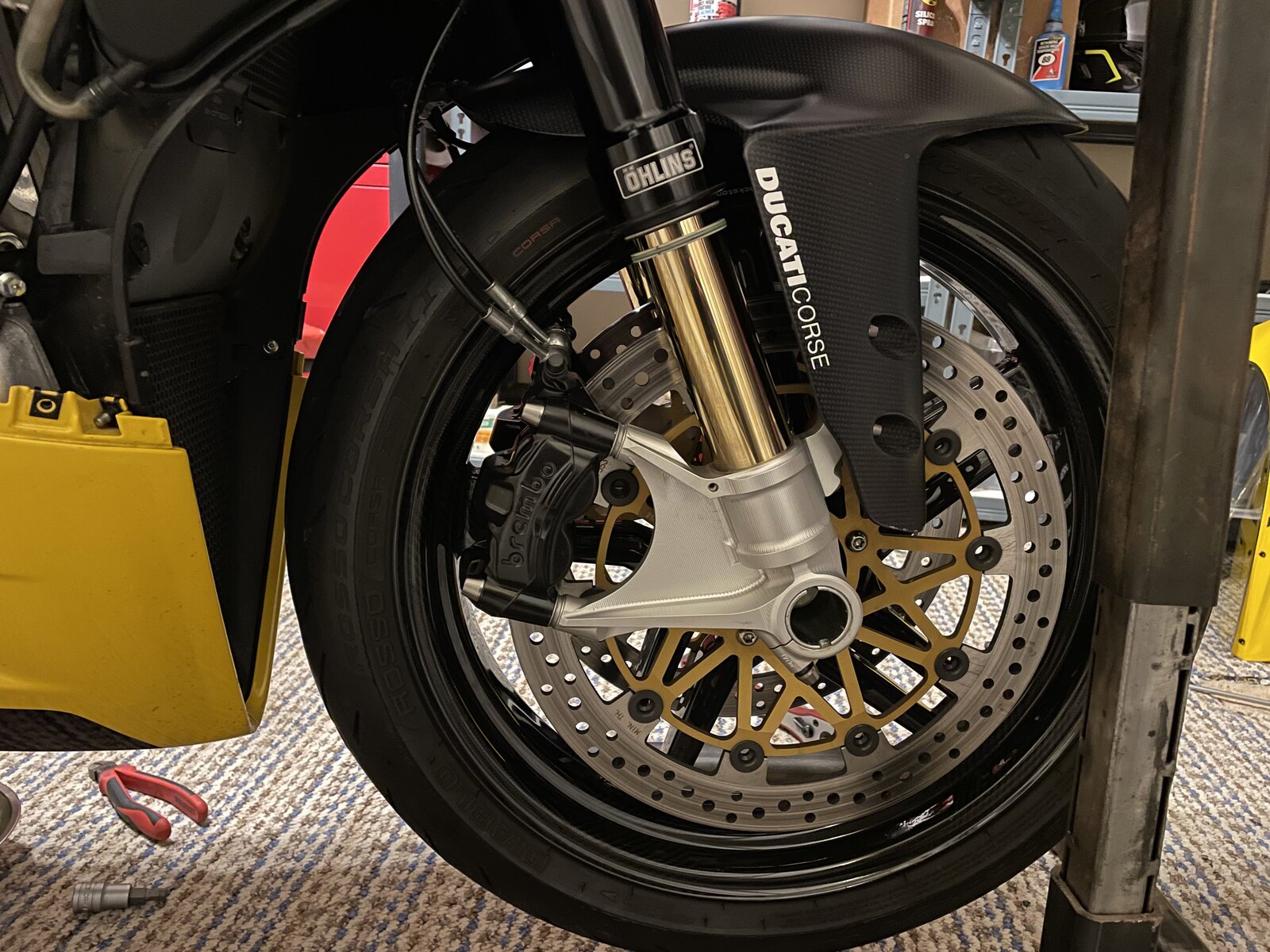

  1. Cheers Andy. Bike off the stand now so bouncing it up and down ready for the pinch bolts and calipers! Excellent spot btw! :punch:
  2. Nor as my mate did and overtighten them with a resulting snap Allen bolt.o_O
  3. No worries mate. Ohlins seemed to have learned their lesson and have upped the bolt diameter to M8. And these even have 19Nm stamped on the fork bottoms. :upyeah:
  4. FWIW, after a small number of reports of cracked Öhlins fork bottoms on pre Panigale Ducatis, general advice and feedback recommended 12Nm max. You know what you are doing Ian but 19Nm sounds a tad excessive. Andy
  5. Cheers Andy. But these are M8. IIRC the workshop manual says 21Nm. I’ll go easy and thanks. :upyeah:
  6. I remember all the horror stories about cracked öhlins fork bottoms on the older bikes but they were a lot less meaty and used M6, I think…
  7. My mate doesn’t do Torque wrenching preferring to feel his way…………..
  8. Nothing wrong with that on low torque value bolts.
  9. Yeah but he’s a habit of snapping low torque bolts, as on his Tuono.

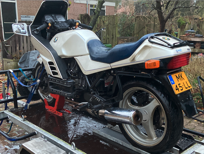

  18. Bought this bike brand new April 1990, sold 55.000 km later early 1994, brought her home last week wit 110k km after 29! years, in great condition. Feels special.
    I knew because the plates stay with the bike, not the person.
    • Like Like x 12
  19. That’s A good looking Beemer.:upyeah:
  20. I'll clean her up and put her in my living room next to the 996, after all, she is 33 years old in couple of months, and in original condition, no farkles,, nothing.
