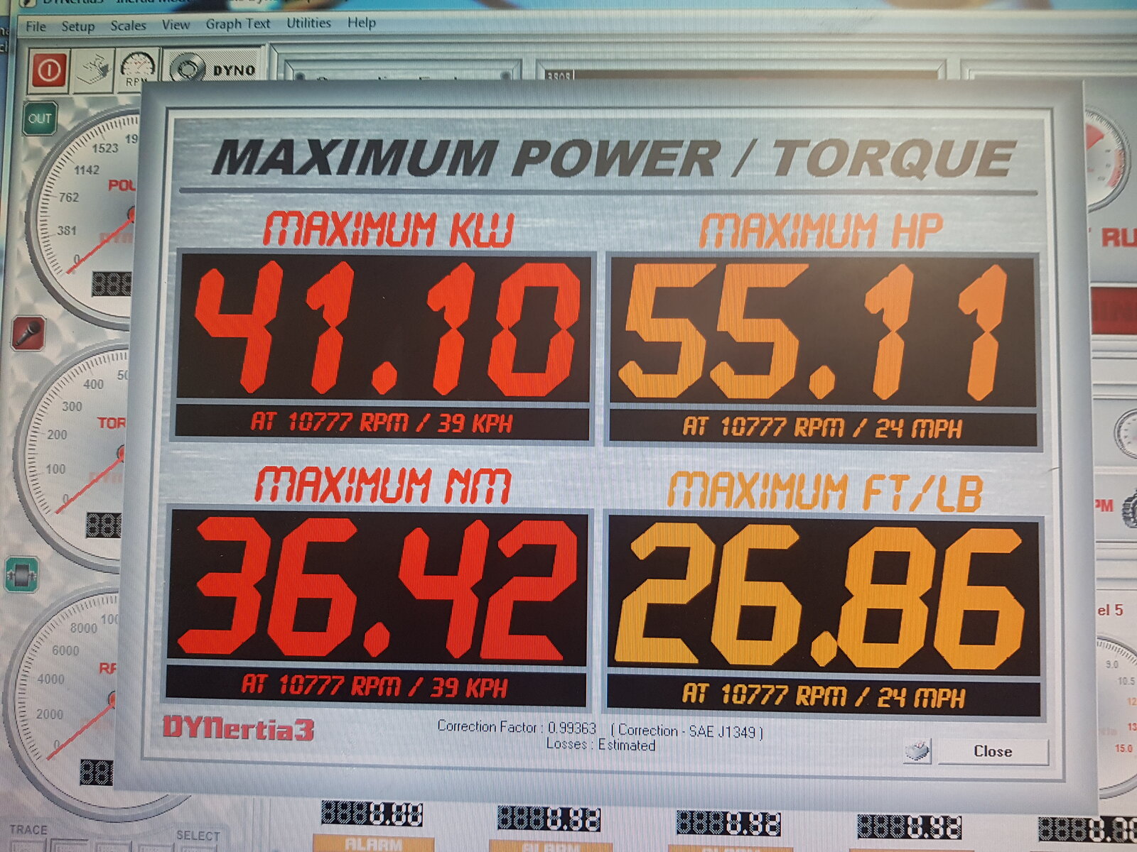

  6. My little RGV...:)
    What a noise when the power valves open

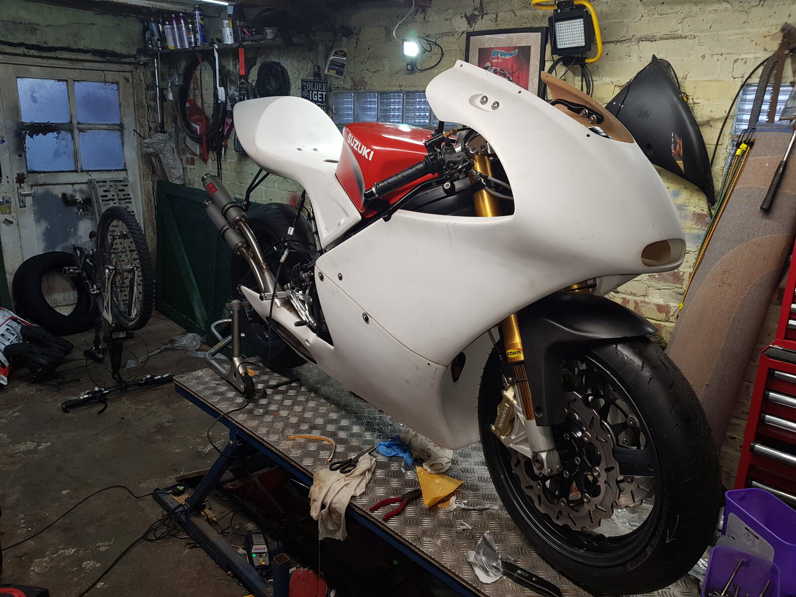

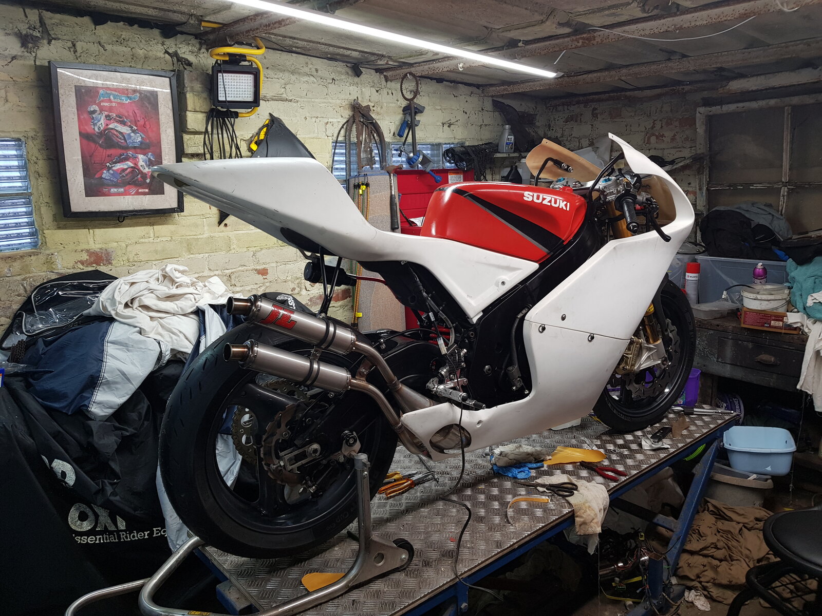

  12. Luckily I had drained the pure water out of the RGV yesterday ready for some antifreeze cos it was bloody cold in the garage this morning, and the water I had spilt was frozen...
    So filled it up with antifreeze, realigned the front brake lever, put heat shield in various places inside the fairing and finally put the fairing on.
    Cant find the bloody screen though :mad::mad:
    After nearly 4 years, and starting from a heap of corruption its ready for the track.
    If I can bend my legs to fit it...

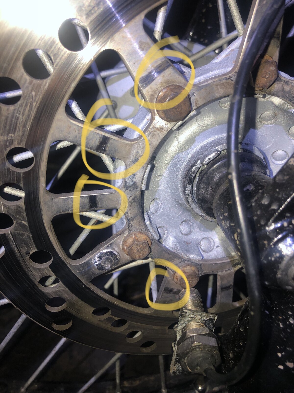

  14. Very productive day today:
    Got the Bandit/Gixxer cafe racer track bike up and running (no great shakes - it just needed a charged battery and a bit of coaxing)
    Carried on checking over the "bought blind" DT125R. Yesterday's fiddling with the carb has worked wonders because today it started from stone cold on the first kick and sounds and responds much sharper than it had previously.

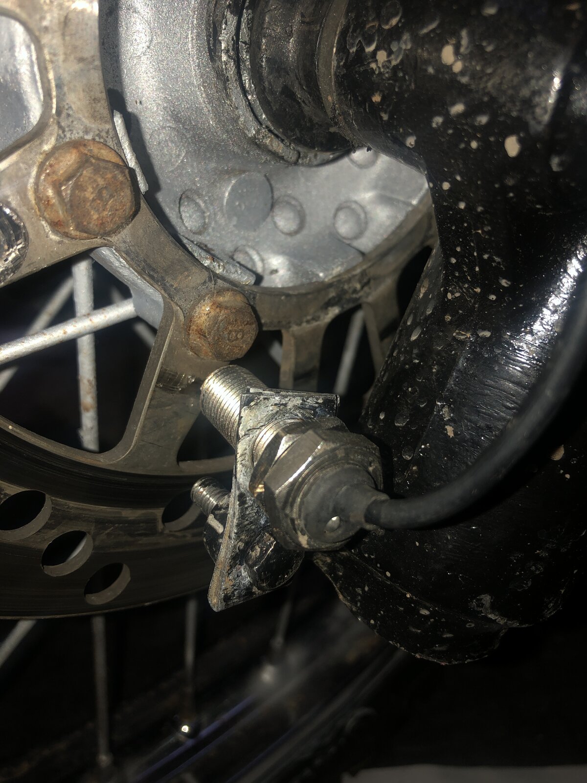

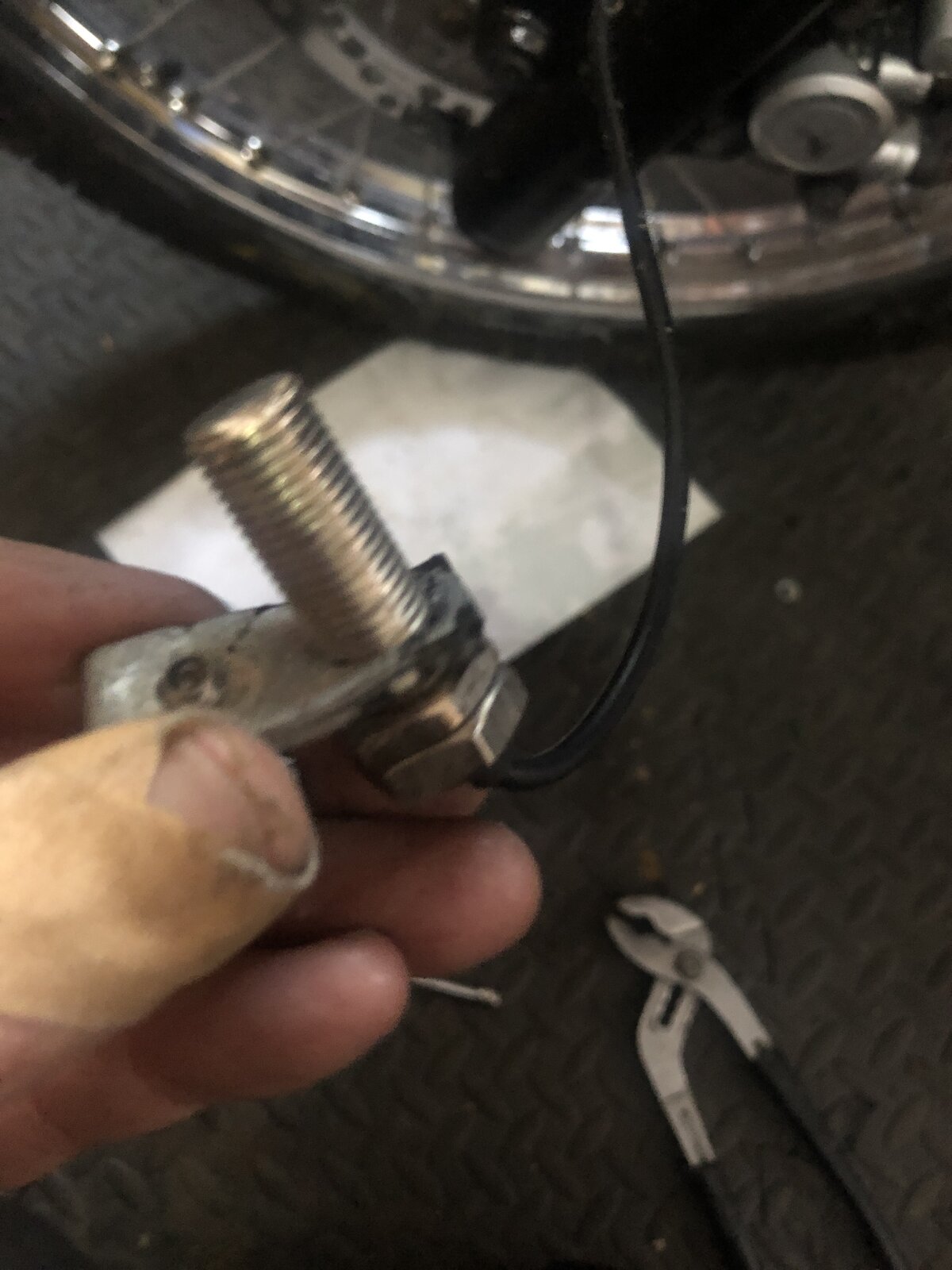

    Also carried on checking for and rectifying some frankly astonishing and dangerous bodges on the bike. A particular eye-opener was discovering that when the previous owner who "rebuilt" (ahem) the bike fitted a magnetic speedo pickup to the bottom of the offside fork leg he hadn't used a lock nut, so it was winding its way through the barely threaded hole in the piece of sh!t metal from which he'd made a bracket. It had reached the point where it was brushing the disc and was microns way from starting to machine it, or, more likely, catching in one of the gaps and locking the front end, with predictable and potentially fatal results. Removed the bracket, heated it up, bashed it flat, tidied it up with a grinder and file and then painted it. Unfortunately I didn't have another nut of the right size to lock off the pickup so it's now lashed to the bottom yoke with a cable tie.
    Then I disconnected the autolube pump because there is so much play in the cable that it was chucking too much oil into the engine, causing clouds and clouds of smoke and dripping black goo everywhere. The bike is now running on premix and is not smoking like a steam train.
    Took it out for a blast round the local lanes, which to my surprise, didn't result in the usual flurry of "call the police!!!!" messages in the village WhatsApp group whenever anyone rides through it on a dirt bike.

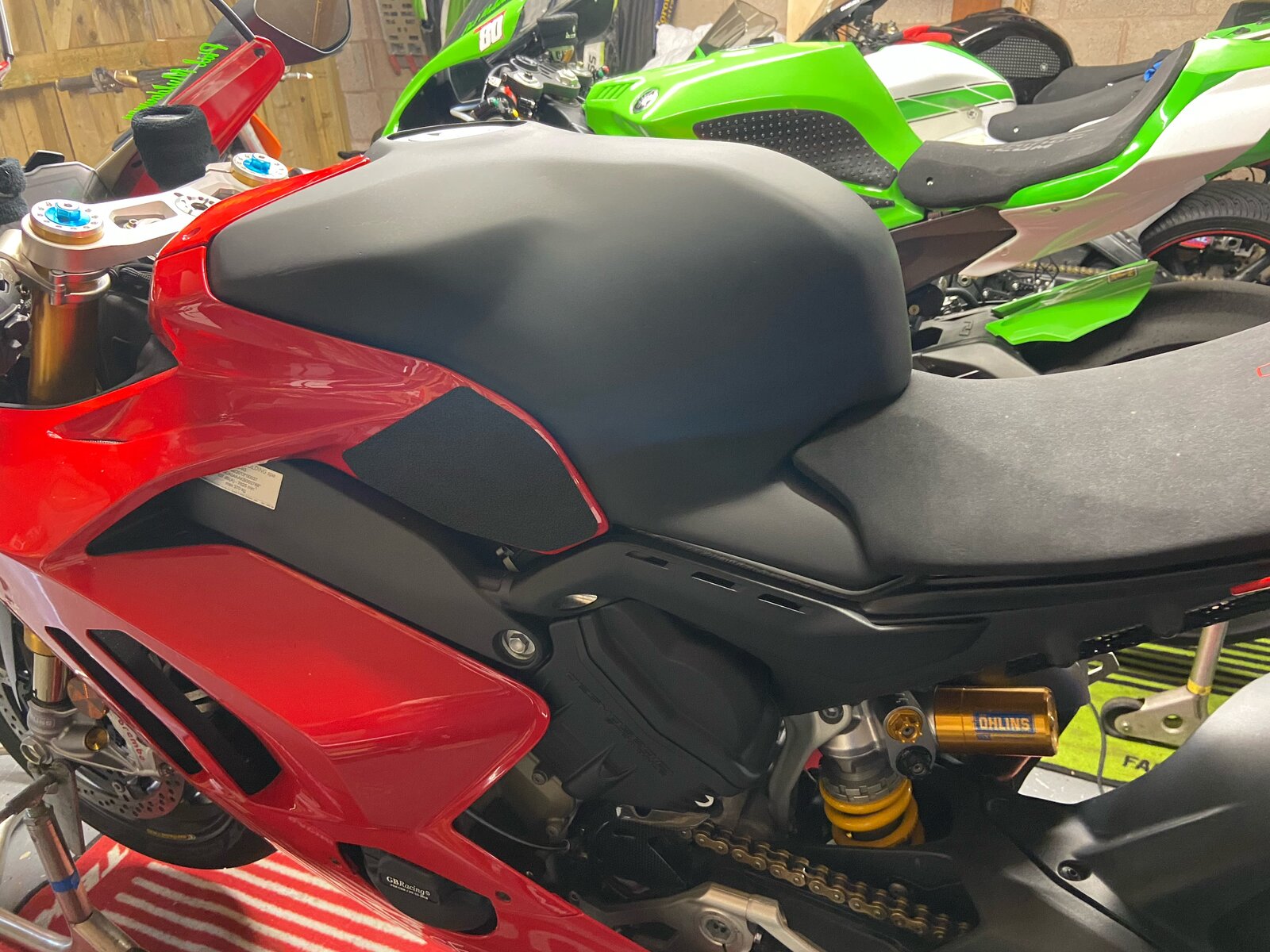

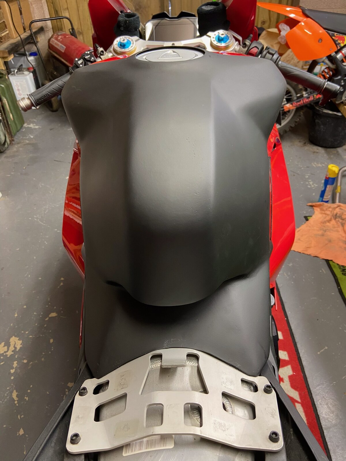

  15. Test fitted the new tank cover for the viffer! Have to say I’m mega impressed! Slotted straight on and a perfect fit! No trimming required! Just have to fit the rest of fairings now!!!
  16. Thats awful...

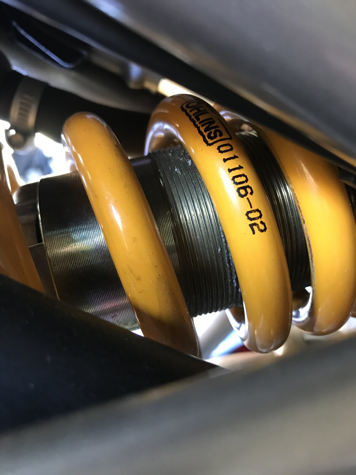

  18. Going to order a softer spring for my 1000ss as the standard one is a touch on the hard side.
  19. Yep. Tbh, when I saw the state of his house in the background of a photo he sent me of his ID and also some of the photos of the bike were taken on what looked like a demolition site, I did wonder how neat his work would be. However, nothing prepared me for range of types, sizes and rustiness of the fasteners he had used or the shocking bodges he had attempted, but at least me and the boy are getting to know every single nut and bolt on the bike as a result of the strip down. By the looks of the bolts on the engine and gearbox he didn't open the casings (thank God) so it is just a case of taking it back to a bare frame, inspecting the bearings, callipers and suspension and then putting it all back together.
    The throttle cable arrived earlier so once it gets late enough in the evening to convince myself that I have done a day's work and haven't in fact spent it dossing around on DFUK and playing with the dog, I'll pop out to the workshop to fit that.
