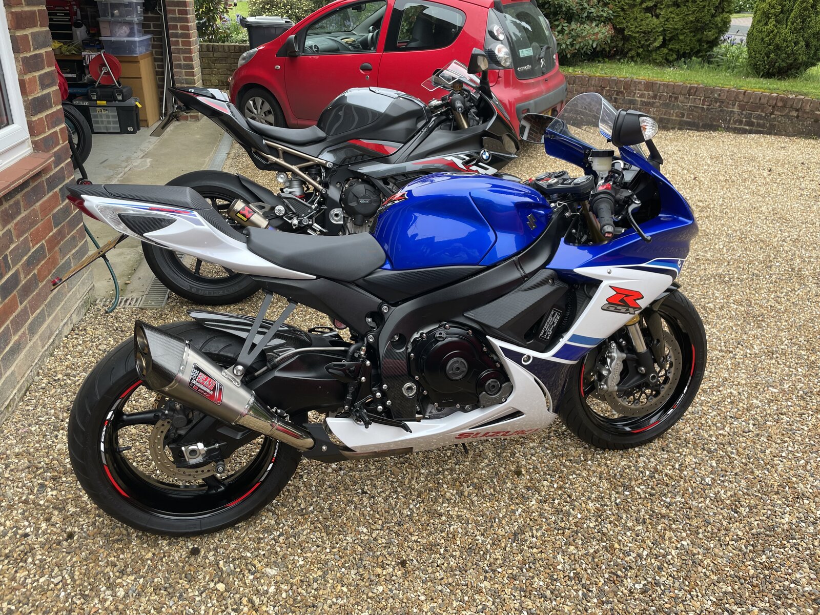

  15. Made some room in the garage by selling my trusty GSXR 750 track bike to my neighbours son. Scrubbed up really well and it’s been an absolutely amazing bike for the last couple of years.
    Now, what’s going to take its place (not track, that’s already sorted).

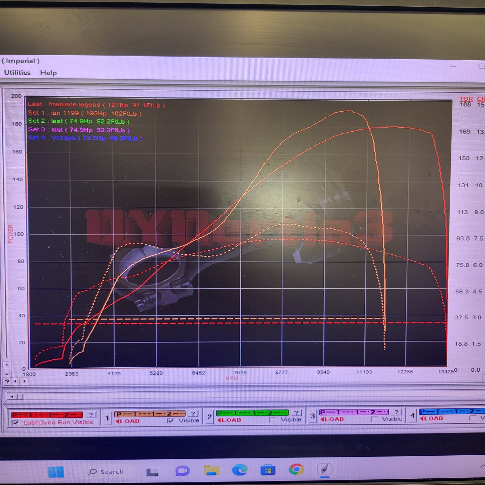

  19. Ran a lovely standard Fireblade TT legends on the dyno, great curve, put my 1199 graph on for a laugh. Which one is the most fun?
