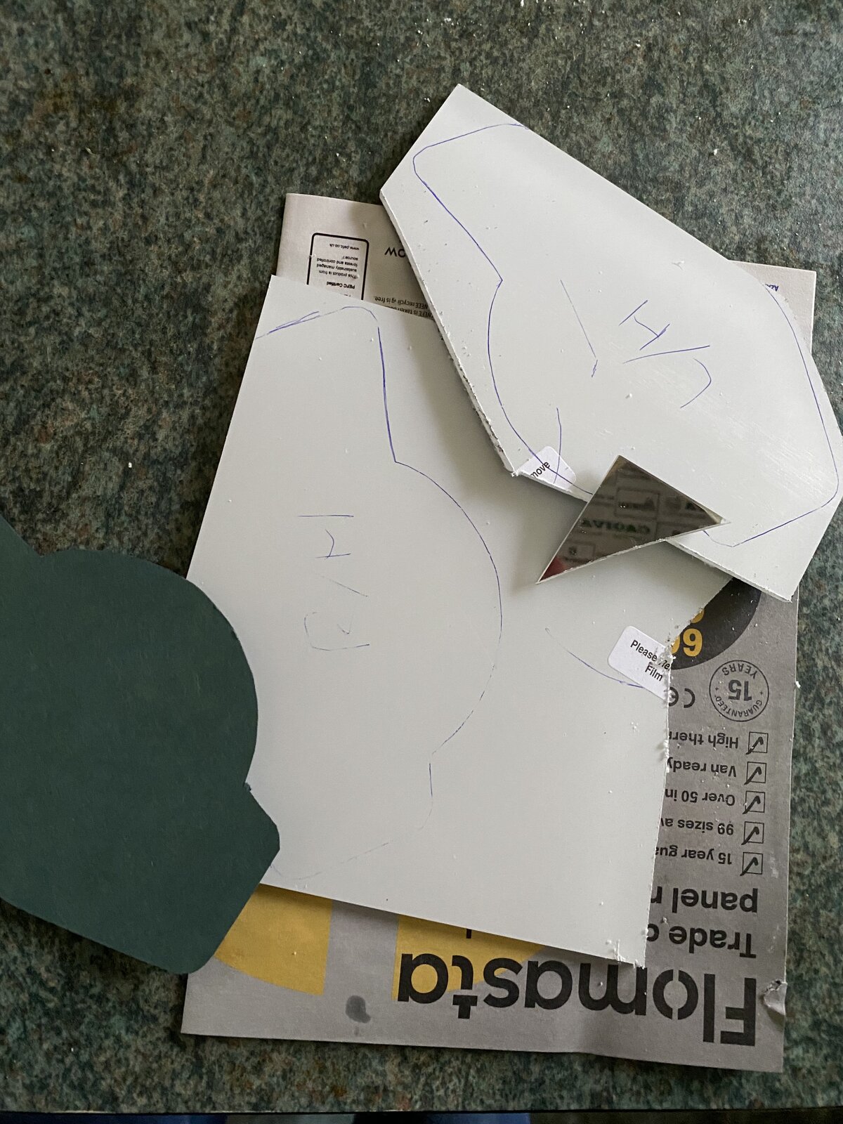

  1. wing mirror "glass" fell off my recently MOT'd ugly last time out, and after struggling to find a replacement decided to make my own, happy to help others if necessary. :upyeah:
  2. @Chris
    I guess you grew up with Blue Peter.;)

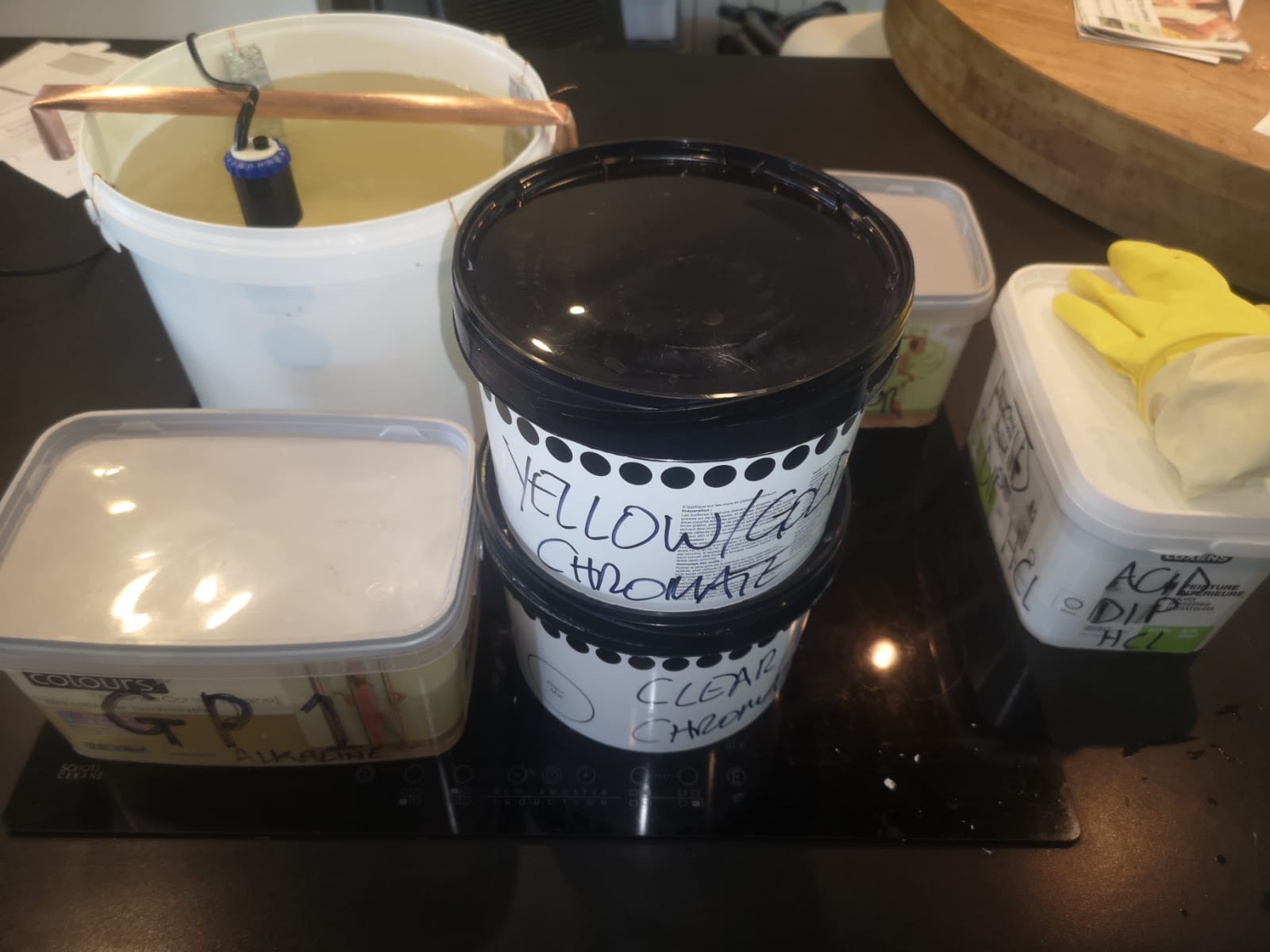

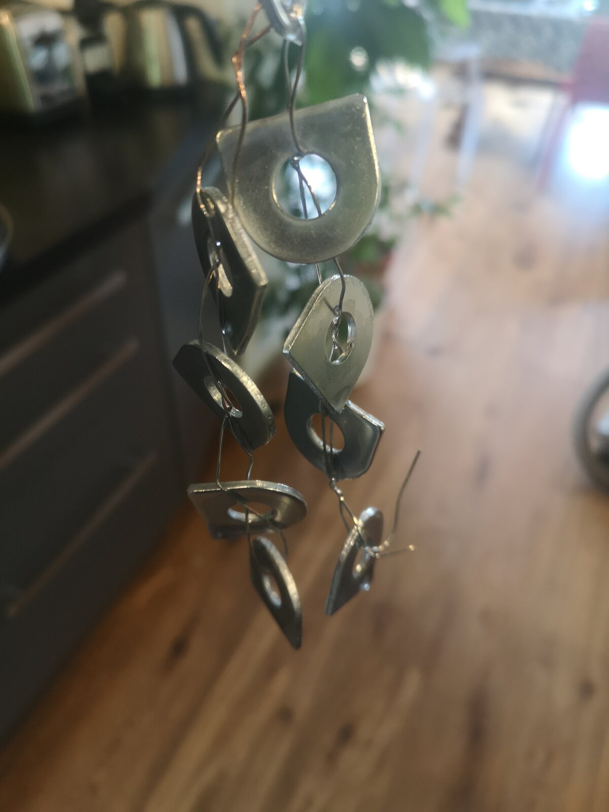

  3. The postman finally delivered my bolts & spacers, so I finished installing the skid plate on the Hyper.
  4. Finally drew up the courage to mix up the Gateros Electroplating kit...wife was out so kitchen was used!
  5. ^^^^ for best results wear latex gloves for protection and also to stop any oil from your skin contacting the parts/bolts which will contaminate the surface finish. Degrease the parts thoroughly with detergent and a toothbrush or brass wire brush, rinse them and dry them with hair drier/heat gun. Wearing gloves, lace bolts/parts onto copper wire and acid wash with HCl (brick cleaning acid) and rinse whilst still strung up on copper wire. Allow to dry or use a hair drier/ heat gun then into the plating bath. The amperage and the duration will come with experience - too little and they will surface corrode in a couple of days - too much and the plating medium (zinc or nickel) will blacken and be difficult to get a good finish. Its time consuming but quite satisfying when it turns out OK, also saving the planet by not buying new bolts etc.

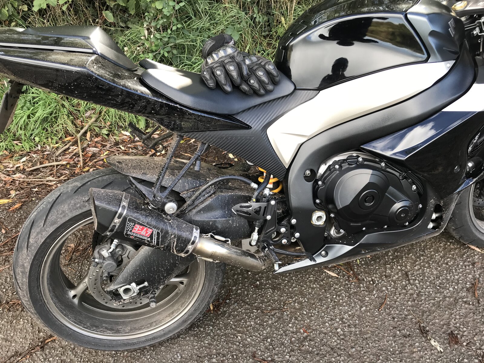

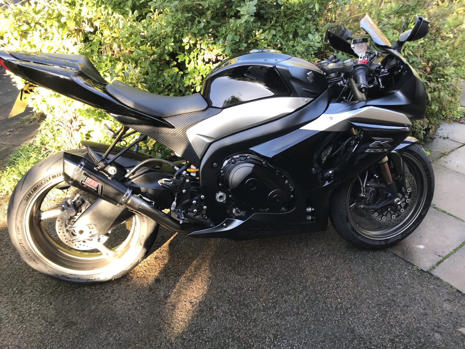

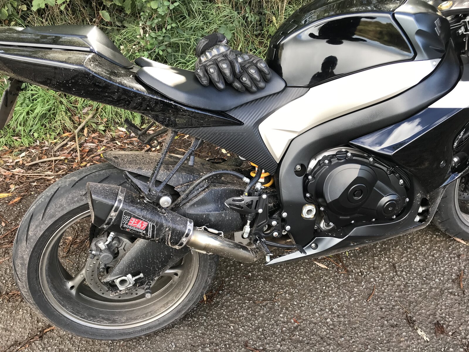

  7. Cleaned the Gsxr1000 after my dry weather ride.
  8. Cheers. Just how the 2009 black ones came, I thought they were fairly common but thinking about it I can’t remember when I last saw another one ! :grinning:
  9. This was my K9, didn't keep it long, I preferred the K5
  10. I've turned into an uber geek... admittedly a chuffed one :D
    Hope the gold turns out as good!
