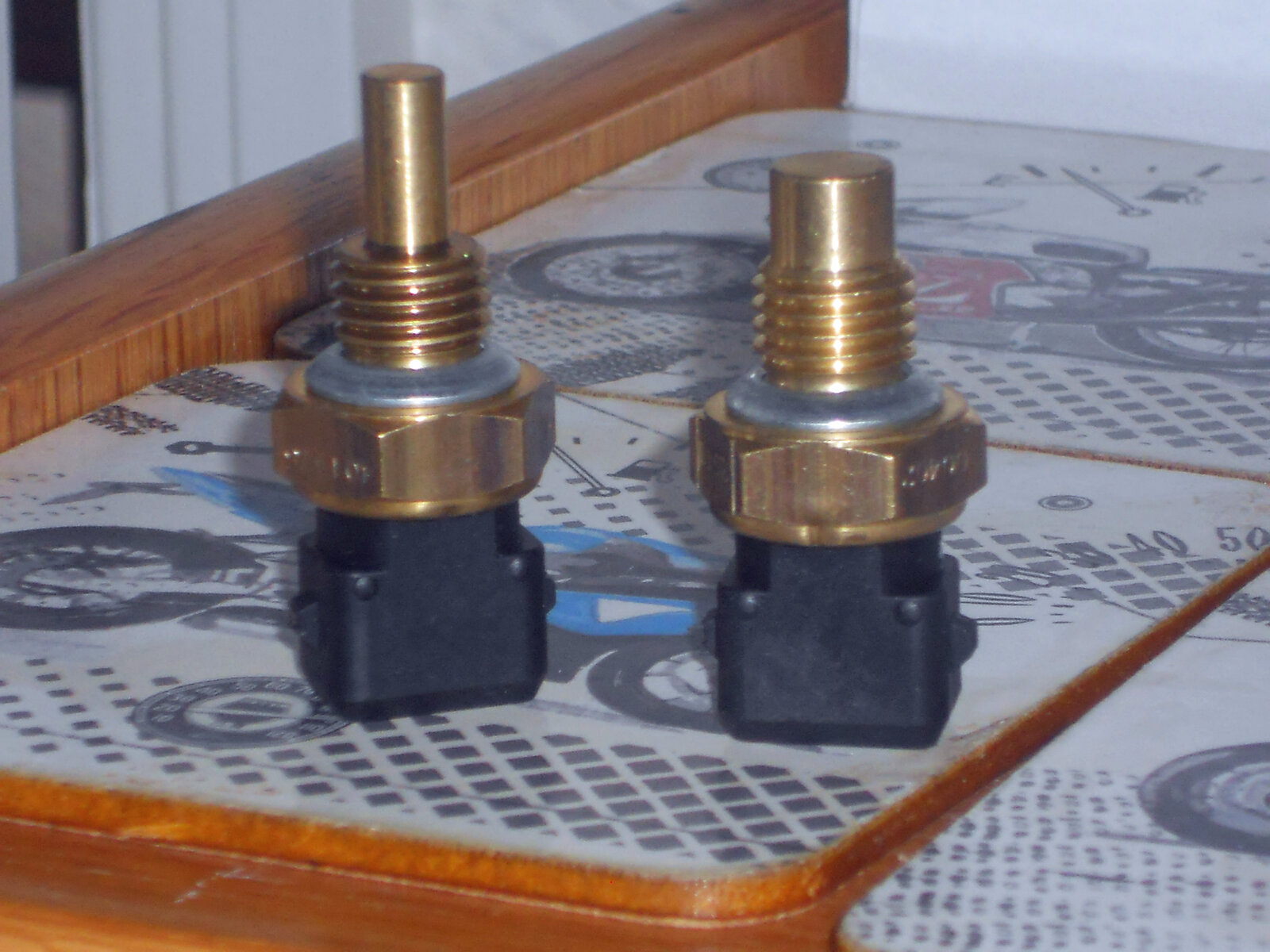

  7. I wanted to replace the water temperature sensor on my ST4 so, after a great deal of searching around, I found the part number and a seller in France. I ordered two and received them today. However, they are 'different'! see pic.
    Does anyone know it there are 'different' ones on the bike? I have removed the one for water temeperature on my bike and it is the same as the one with the long sensor end. I have not seen the one with the short/wide end.
    Any ideas???
    Thanks
  8. The one in my 888 is just like to one on the right (let's call him "Mr Stubby") ;)
  9. I used to love tinkering around with these, and they do remind me/look very similar to the Italian water temp sensors on cars from the 60's onwards.
    First of all i'm surprised that all the numbers stamped on the hex flats are the same for both? - they used to incorporate a temp number on here, and voltage also I think.

  12. Numbers on the hex flats are not the same:
    Long one has: WTS/09 blank 401970 01/02 blank 2977
    short one has: WTS/09 00402 blank 2618 /01 blank
    I did wonder if they would both work but I have queried the difference with the supplier. Waiting on reply.

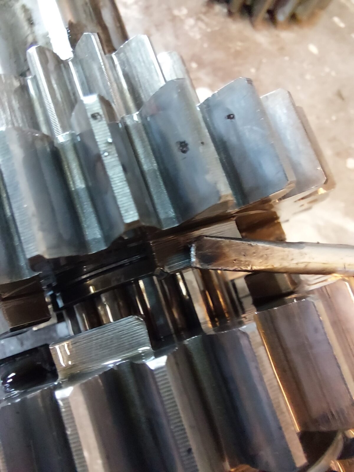

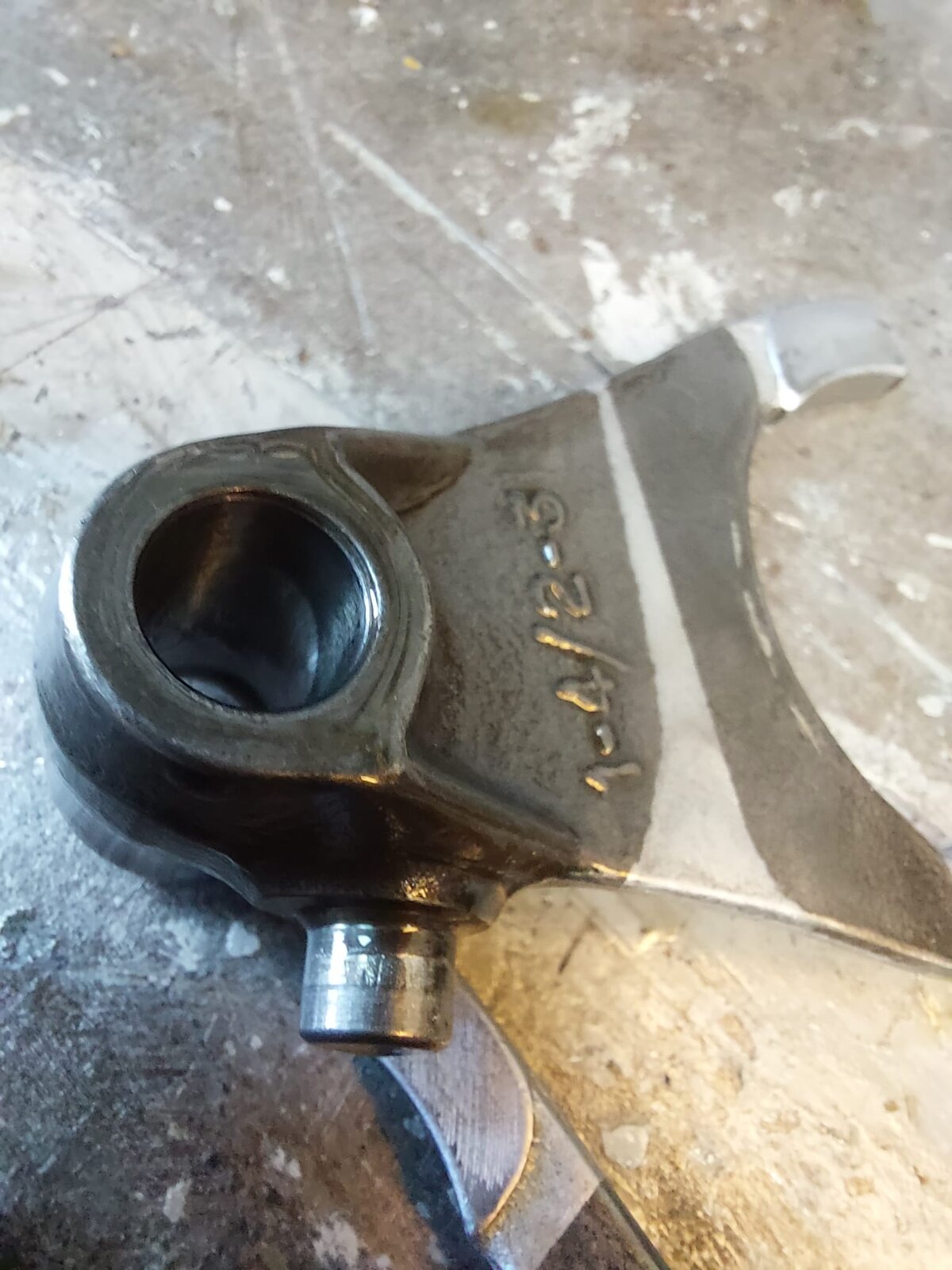

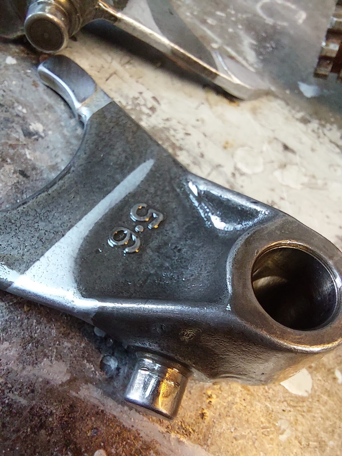

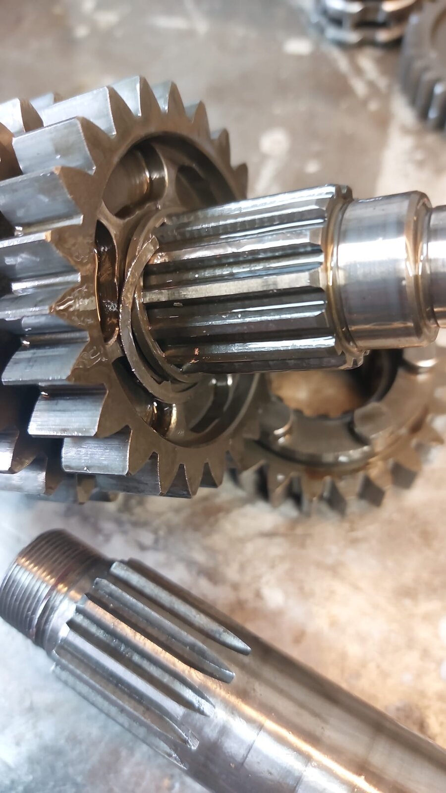

  14. A few issues with my gearbox,
    now explained. :bucktooth:
  15. that's a shame they are not as user-friendly anymore, amongst all those numbers can't be a temperature as you would have a smaller, raised "degree" symbol.
  16. Have just swapped the water heat sensors over so ...
    New one has: WTS/09 blank 401976 01/02 blank 2977
    Old one has : WTS/09 blank 401976 01/02 blank 3228
    haven't run it up to full heat yet but everything does seem to work so far. :grinning:
  17. i would have done the same ^. :upyeah:
    it's originally a Jaeger ref number apparently which fits in with my memories. but here follows a rabbit warren that may or may not be helpful. My main aim was to find actuating temperature via a part number suffix but no luck here so far - further searching I believe would reveal this eventually.
    https://www.yoyopart.com/oem/639854/jaeger-401976.html
    I'm assuming it's a 2-pin type?

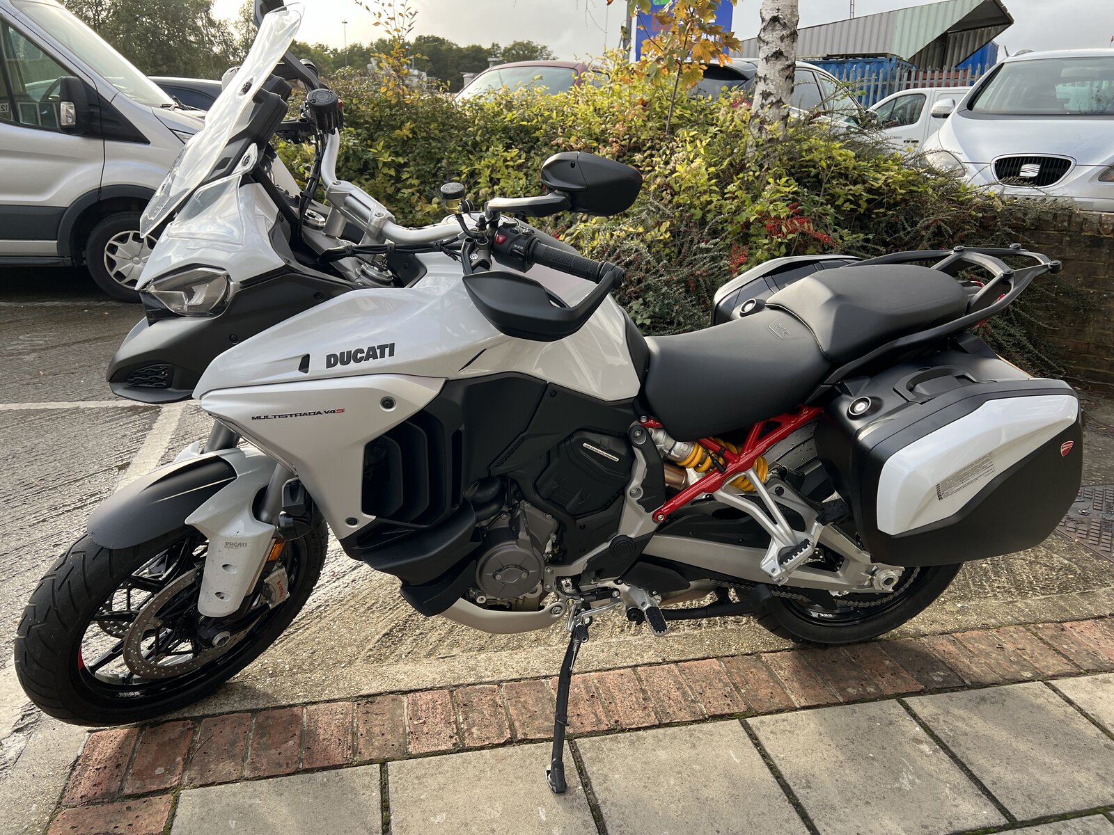

  18. Picked up my new multi :)
    #5159 Twin4me, Oct 19, 2023
    • Like Like x 8
  19. Yeah, 2-pin, original is made by jaeger (marked on plastic body) I didn't check the new one :rolleyes:. Thanks for the info anyway.
