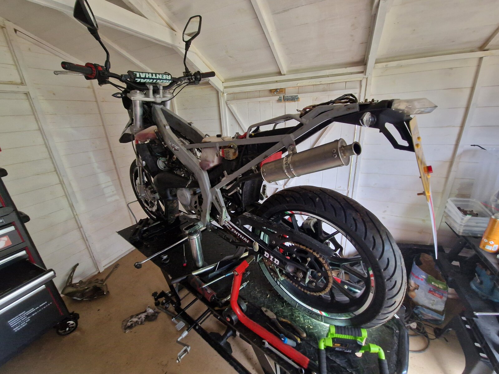

  7. Had to move the 996 out of the workshop, to get this piece of shit in, it needs a bit of work, and a few new parts, my youngest sons Aprilia SX50

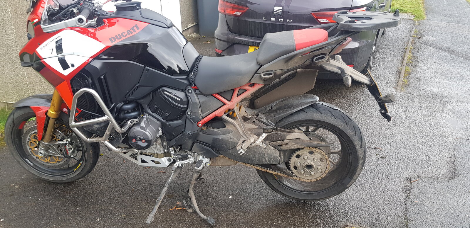

  8. Couldn't decide if this qualified as a random Ducati picture or if it it's a small bike thing. I went for a ride :D Andy

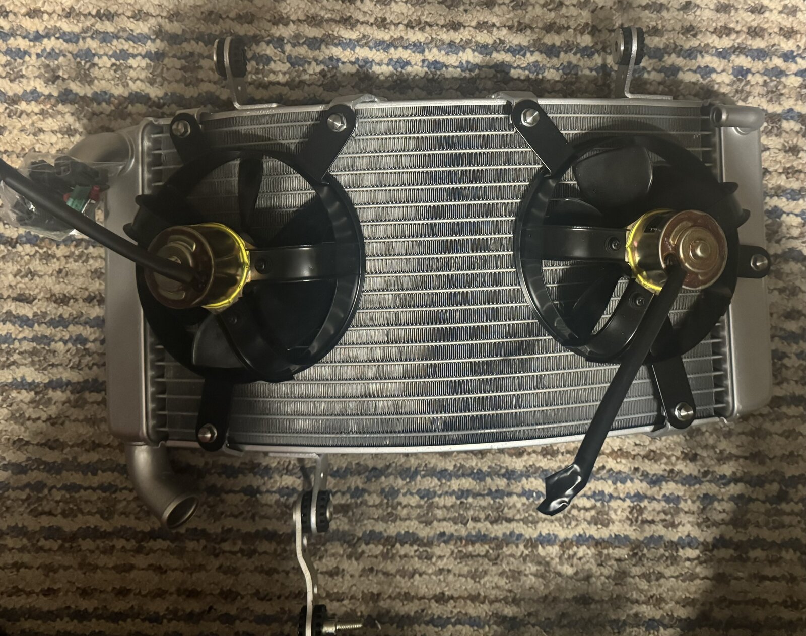

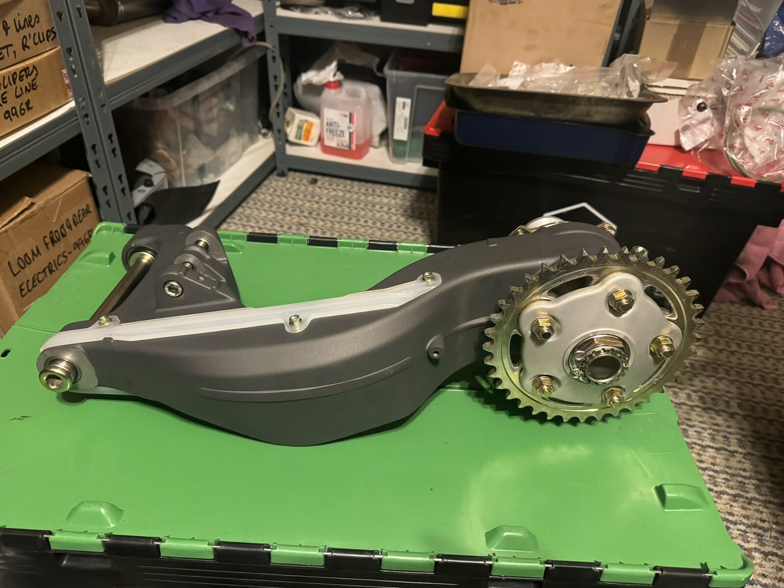

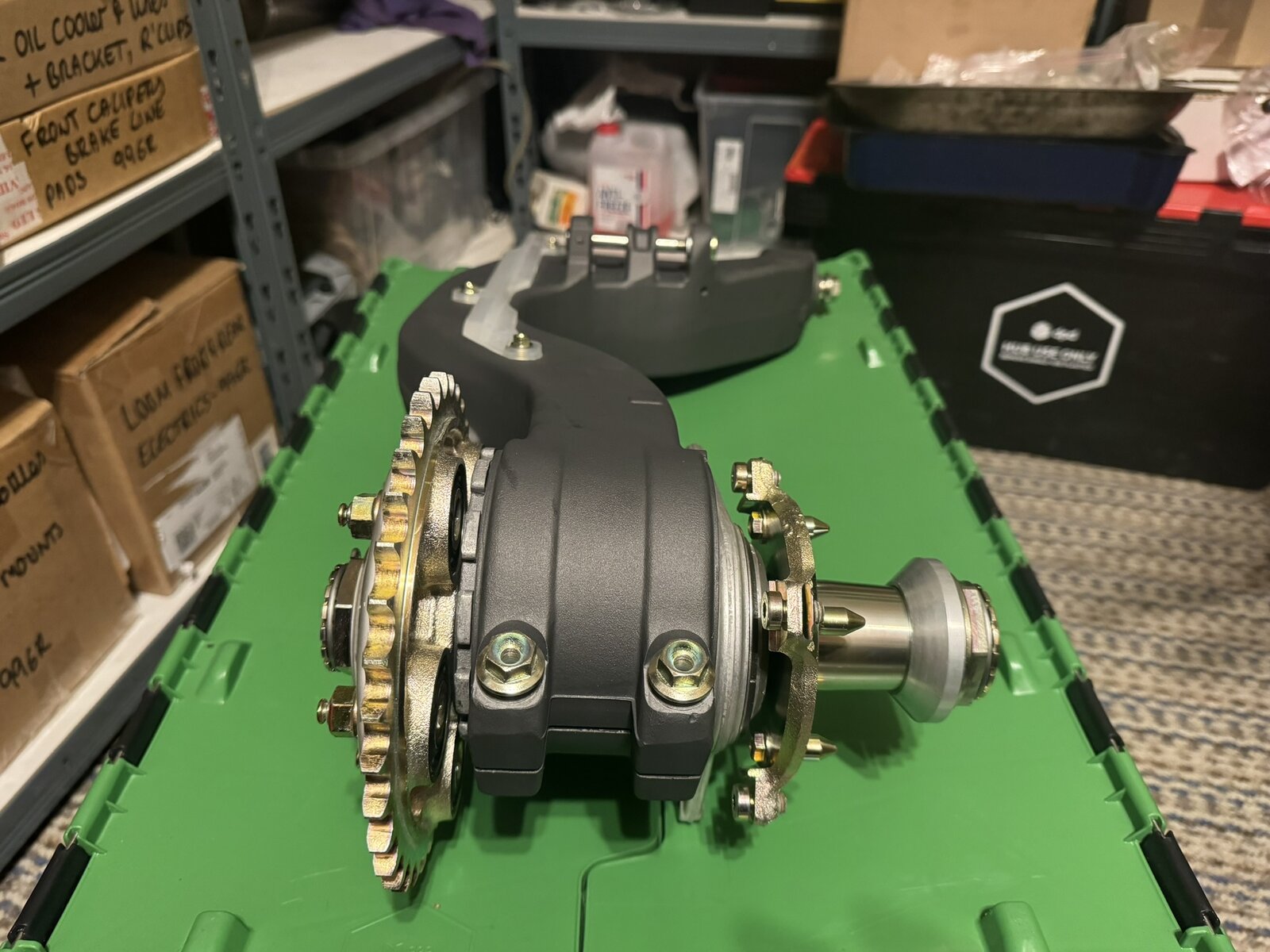

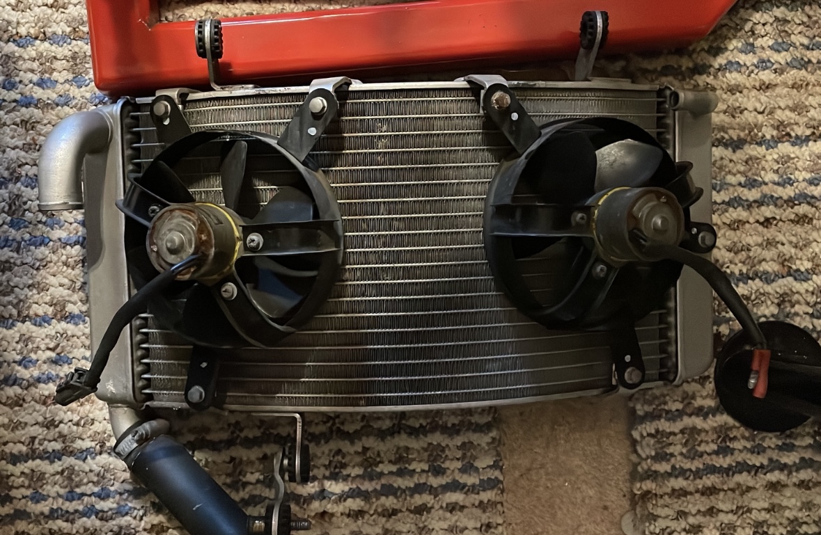

  9. Minted the 996R radiator and fans. Also finished assembling the swing arm.
    Before.
    After.
    CFEBECA6-44CB-4FD8-91AC-87A375786A73.jpeg 8D6FA50F-AEF7-423F-90BC-47924D9C66D5.jpeg

  10. when it comes to SX50's, calling it a piece of shit is becoming a it of a trend. i called my sons one the same. and much much more.

  12. My Sons SX50 was fine with just the usual indicator wiring issues and a HT cap not seated properly. It was unrestricted but he never rode it over 50mph, I did but not for very long.
    I’ll guess you’re aware of PJME in Wednesfield for some parts?
    He’s on a MX125 as he couldn’t bear the thought of riding a 4 stroke at such a tender age and before he smelt like an old person.

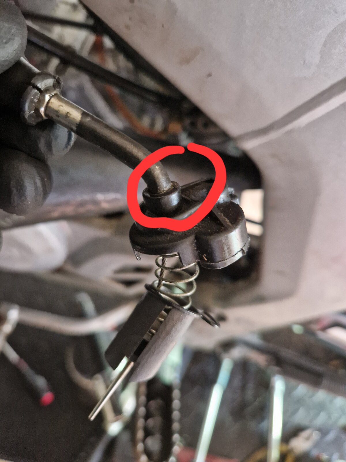

  13. My son should have been usingnit for his CBT today, but, unfortunately, it died, managed to get it back home, in the workshop, to have a look at it
    The bike has got a few non standard parts, according to the parts catalogue, it has different front caliper, different carb, and a few other bits
    The front brakes were, interesting, to say the least
    When removing parts, I noticed that the HT lead was not fully seated on the plug, the choke cable was not seated correctly in the metal tube, the metal ferrule on the end of the cable sleeve was sitting at an angle at the end of the tube it is supposed to sit in, thus, holding the choke on slightly, probable cause of it dying
    Also, where the throttle cable goes in to the top of the carb, the plastic top cover was broken off, where the metal tube screws in (circled)
    The throttle seems a bit stiff, and doesn't return to tickler when releasing, possible cable issue
