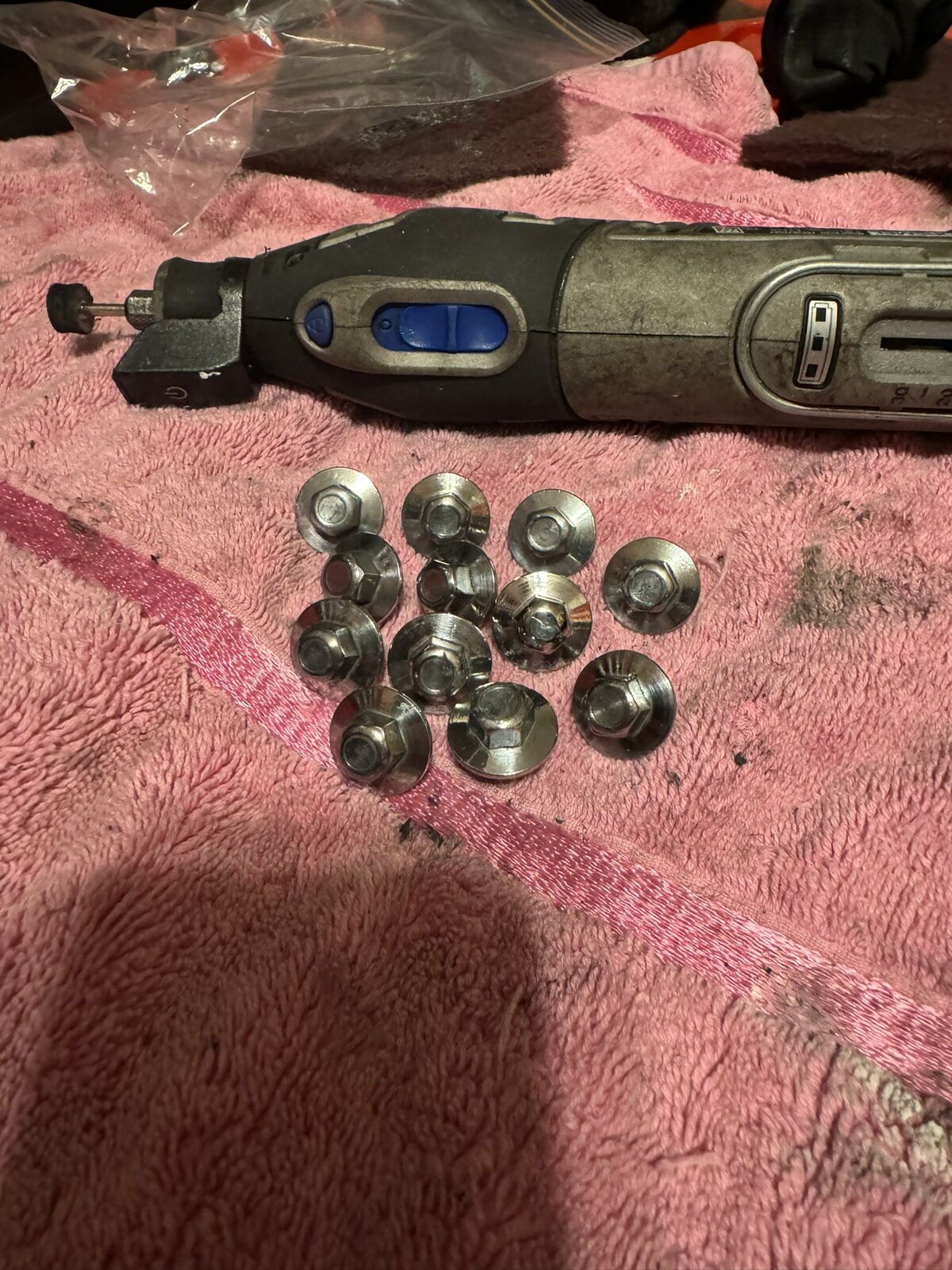

  2. All 12 reunited and looking rather smart! :cool:

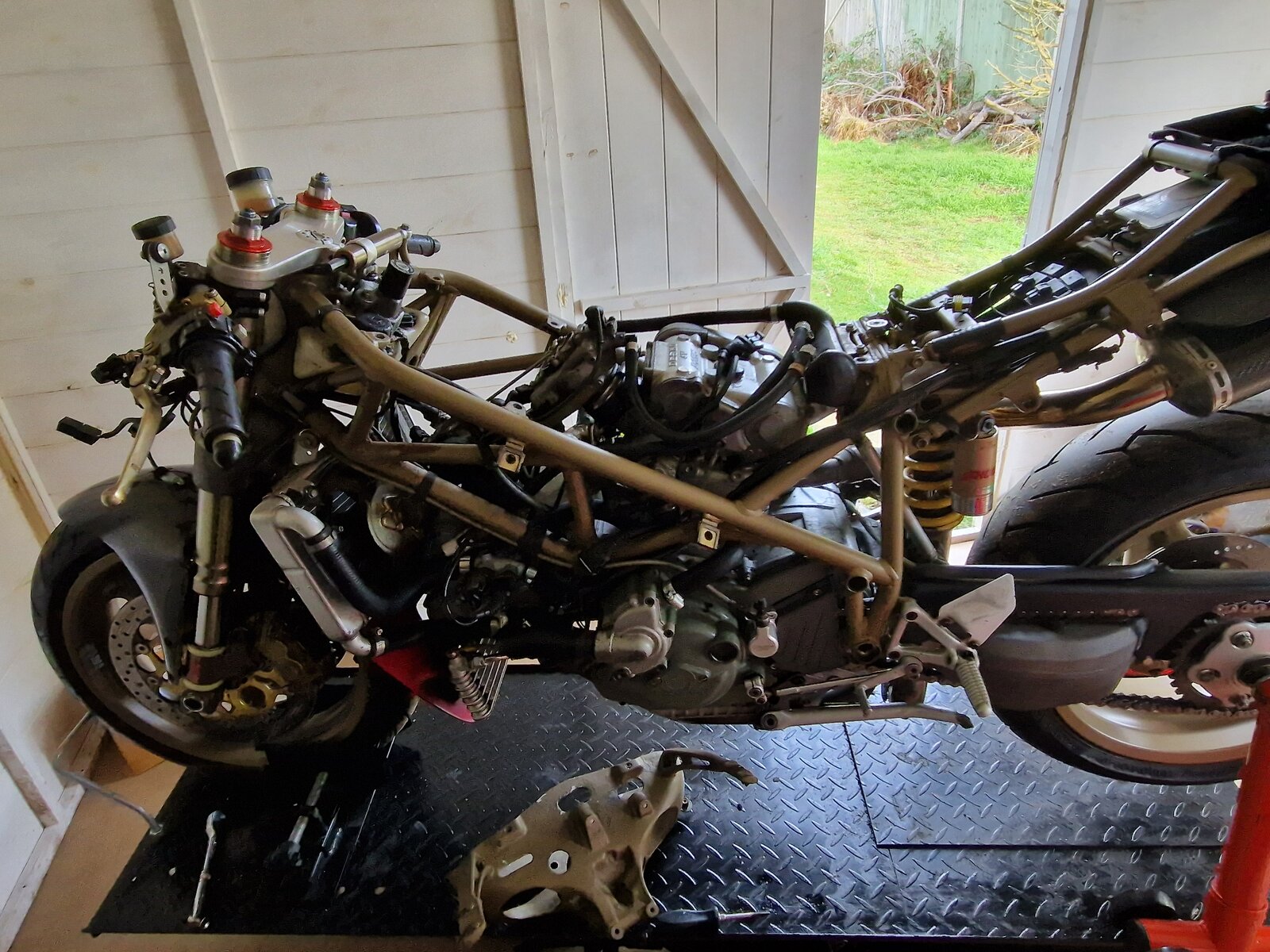

  5. My 996 is in the workshop, in bits at the minute, needed the table for the SX50, hence the bike shuffle

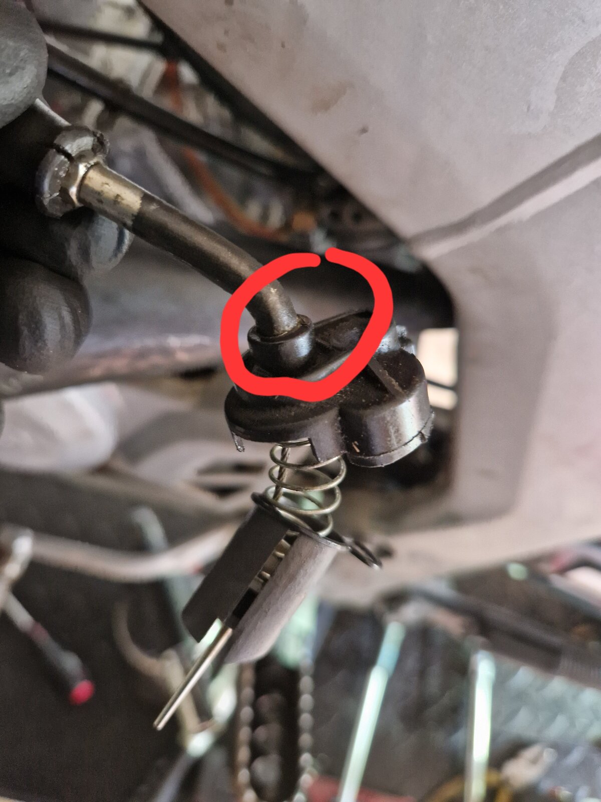

  18. My youngest had his CBT on 4th Feb, planned on him using his Aprilia for that, my wife took him to the centre, and my eldest son took the bike, half way there, it broke down, and wouldn't restart
    Eventually got it going again, git to the training school, but, there now appeared to be a slight fuel leak, so, it was decided that he would use the rev and go, previously pictured
    We got the aprilia back home, and took it apart, found that the clutch cable sleeve was not seated correctly on the metal tube on the carburettor, thus, holding the choke on about half way
    Also found that the carb top cover was broken, where the throttle cable goes through it, the plastic nut (circled) had broken off the rest of the top cover, new top cover ordered for just over £5, fitted, was a pig to start at first, now it starts straight away every time
