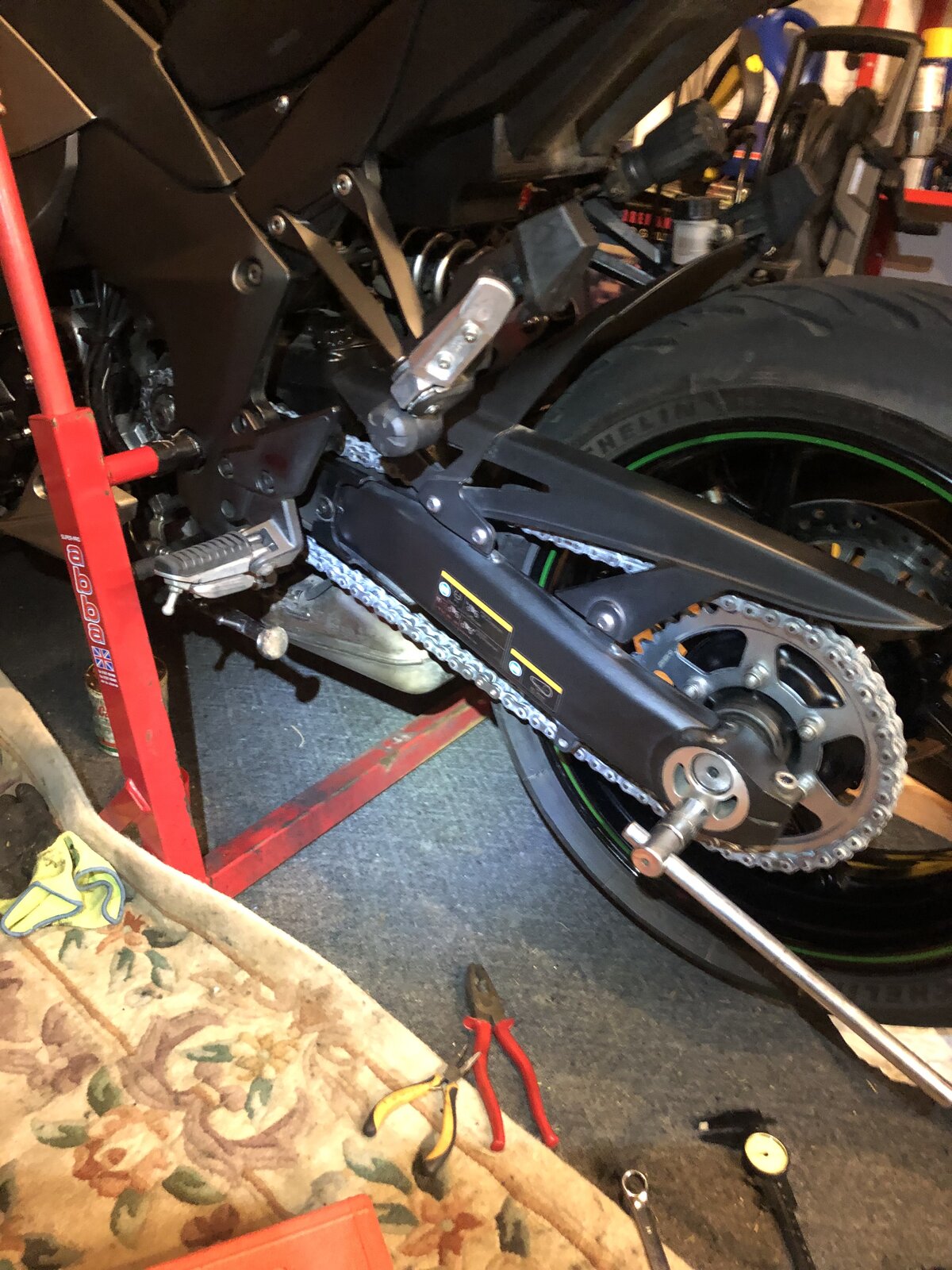

  1. Fitted a new chain and sprocket kit to the Kawasaki workhorse today,..

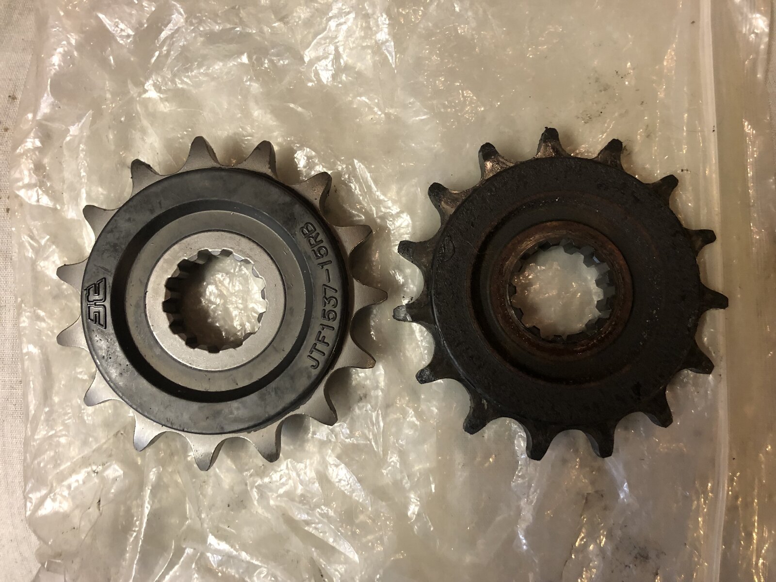

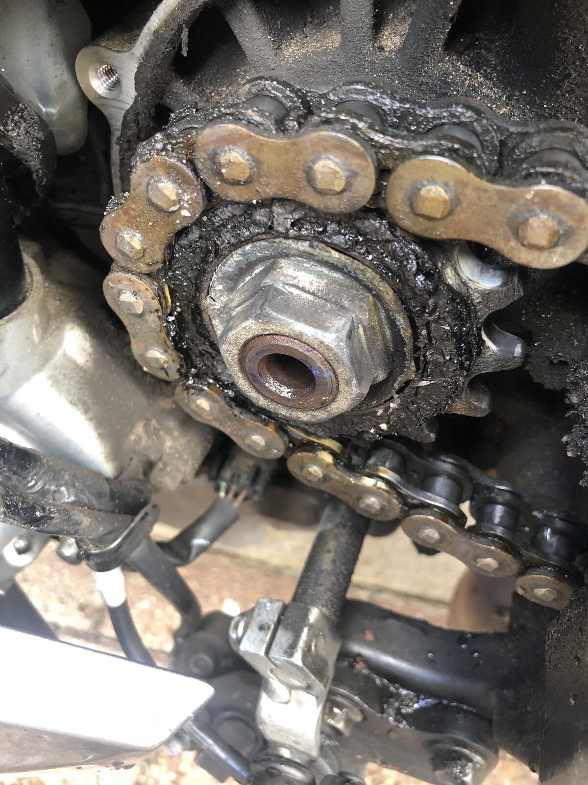

    Original set has done 20k miles now, no complaints with it, for a standard OEM fit chain it’s done well, an EK chain, but I suspected that the front sprocket would be getting a bit worn by now, so off it comes..
    When I finally got the front sprocket nut undone that is :astonished::astonished: ..Jeez, I’ve had tight nuts before ( if you’ll pardon the expression ;) ) but this was just in a different league, took two of us, a lot of heat, and a 2ft breaker bar to get it moving,..wtf are Kawasaki using for Loctite these days :thinkingface: ?
    Plain sailing once the nut was loose, this is what 20k of mileage wear on the front sprocket looks like
    Almost done, have to say I’m not overly keen on the wonky eccentric chain adjusters on the Ninja :confused:

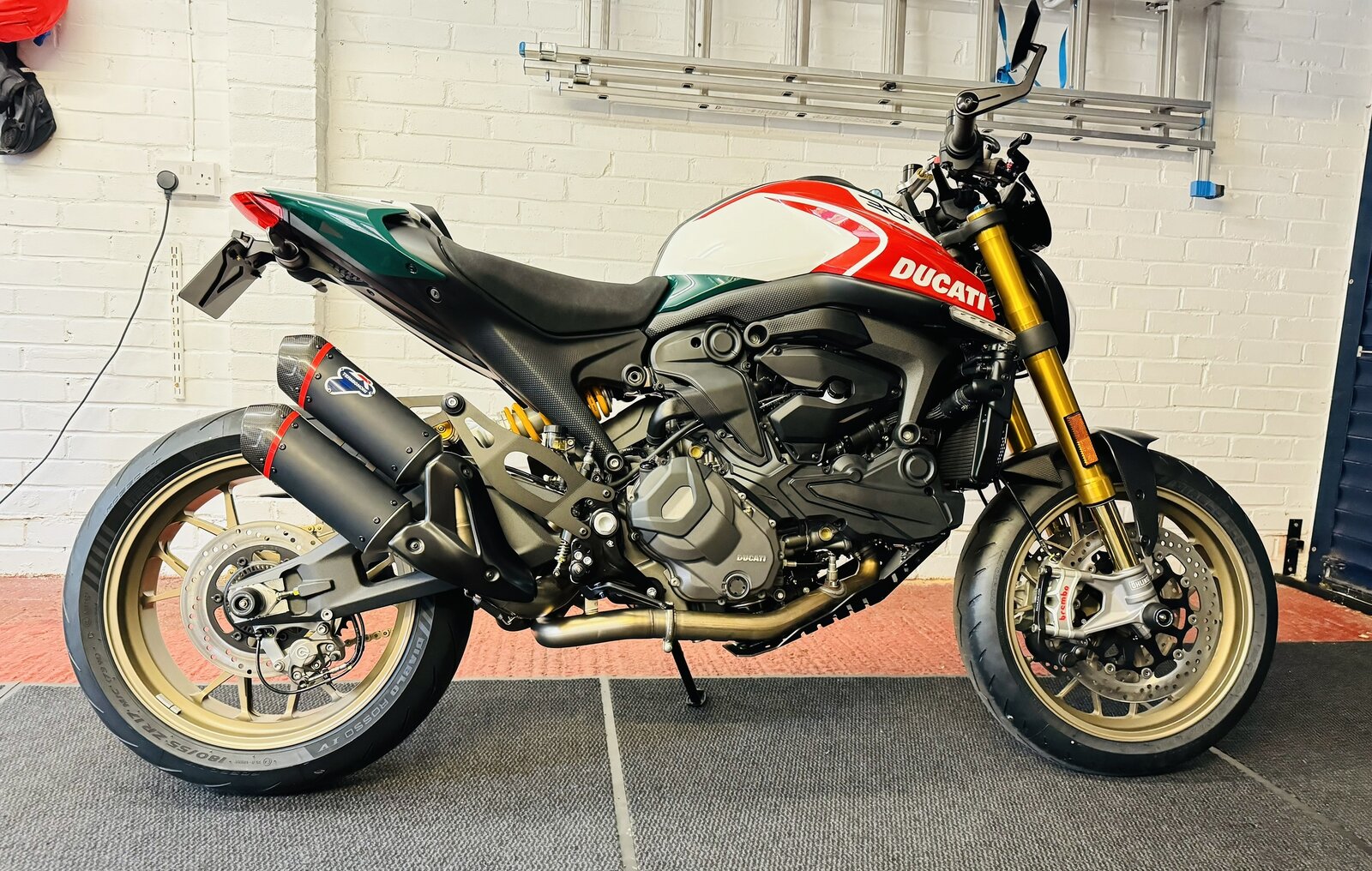

    I really rate these RK chains mind, I fitted a “Blackscale ZW ring” one onto the Ducati a while ago and it’s been great, far better than the last two DID ones that was on it before, they both developed tight spots at about 10k miles and were shelling “O” rings out like peas.
    This RX ring one is about £60 cheaper than the Blackscale chain, but it’s plenty good enough for the workhorse.
    This is what I rate about them,…the ring designs, both the ZW and this RW are really chunky cross sections that don’t break easily and have lots of areas that trap the grease :upyeah:

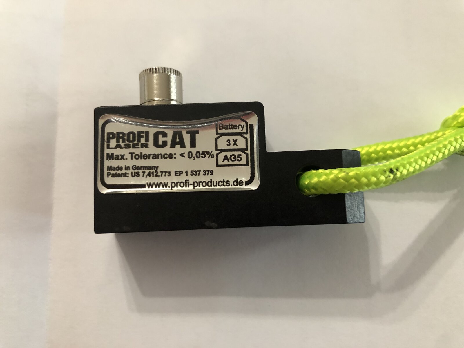

    I don’t however rate this bloody thing :confused:… laser alignment tool,…just never works when I want to use it !
    If it’s worked about 3 times since I got it, it’ll be lucky :triumph: …have ordered some new batteries for it and if they don’t get it working it’s going in the bin , bloody waste of money and it wasn’t cheap, grrrrr :imp: !!

  2. Same for me with the chain alignment tool, it’s garbage.
    Mines somewhere in my garage but I don’t care to look for it.

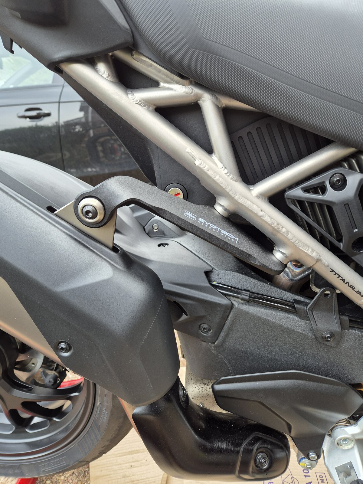

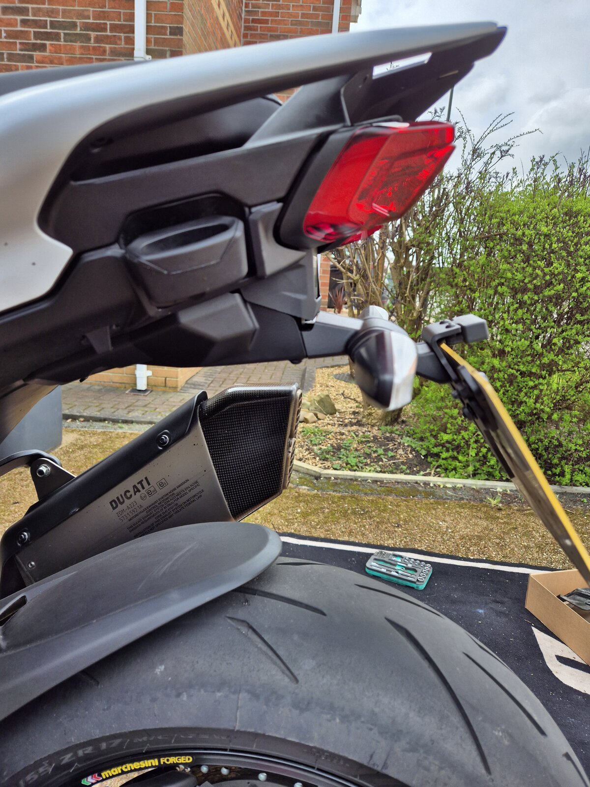

  5. Fitted a couple of bits to tidy it up.
    Carbon Fibre matching wind deflectors.
    Pillion pegs delete.
    Tailtidy.

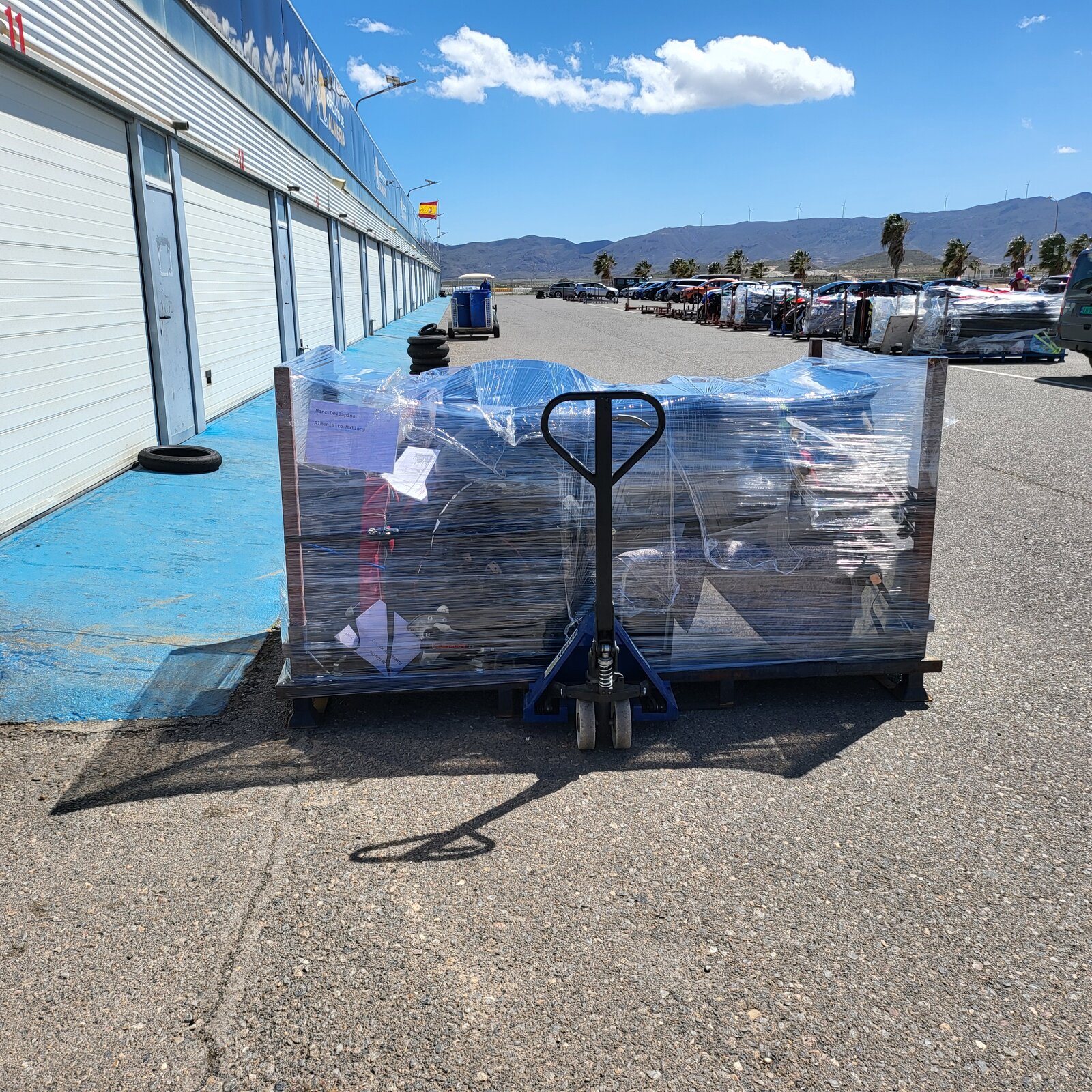

  6. Packed the bikes up after 5 days at Almería. Weather has been like a Croft day sun, rain, hail, and a a hurricane.
    Buddy likes it so much here he will wait until his lung inflates again before coming back....

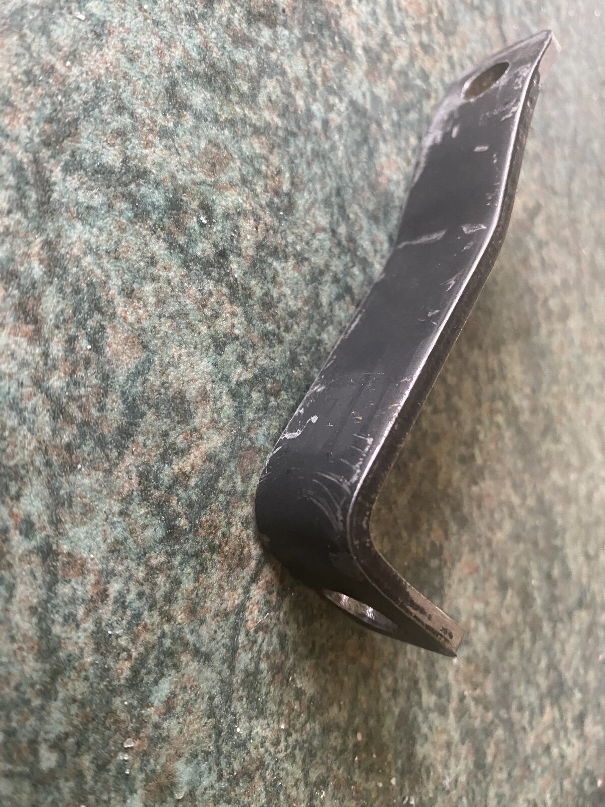

  7. made a crude bracket for attaching rear light loom tube as well as crash bung.
