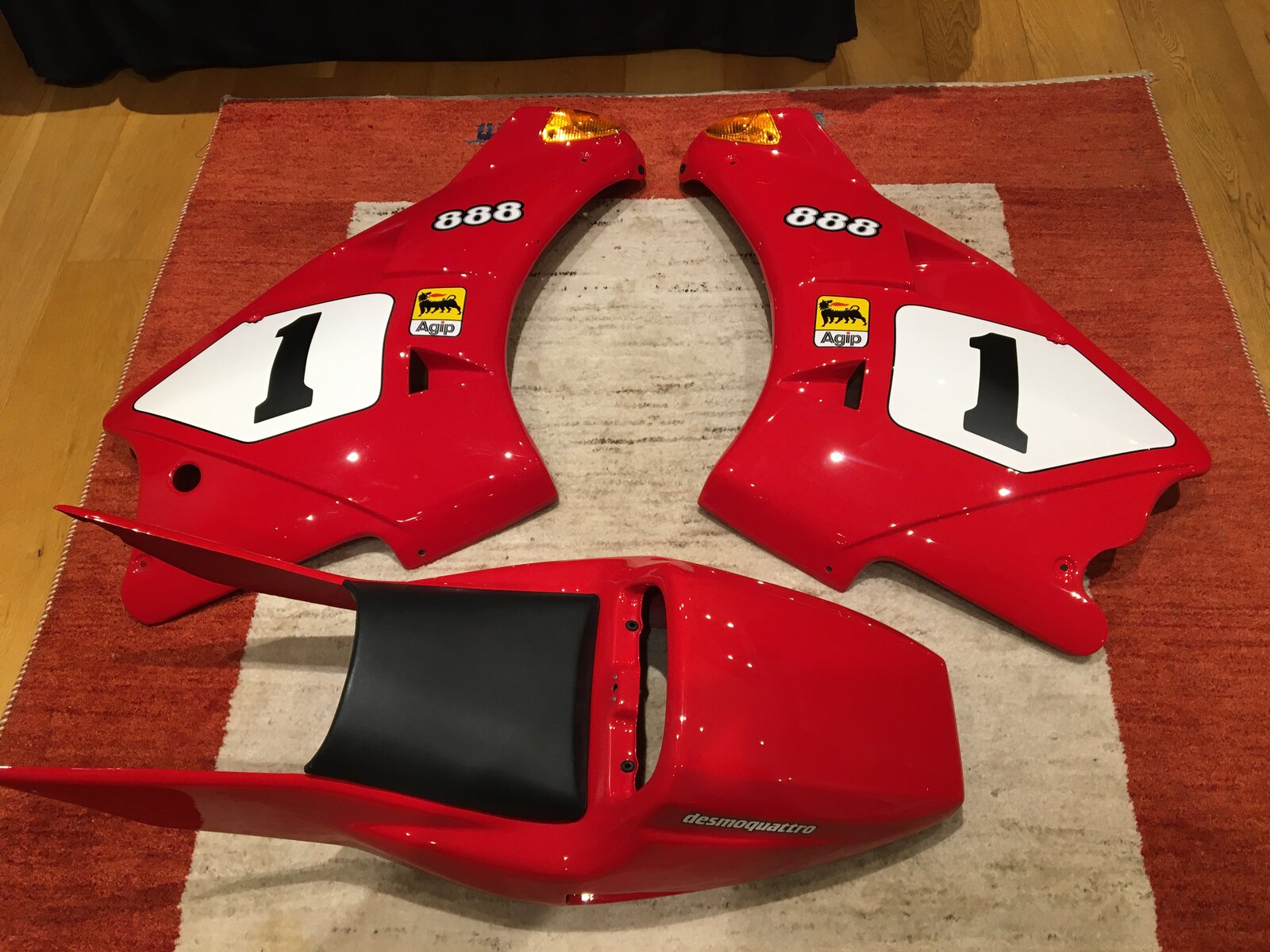

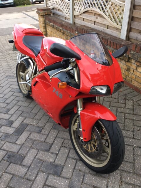

  17. Nearly ready for PPF...

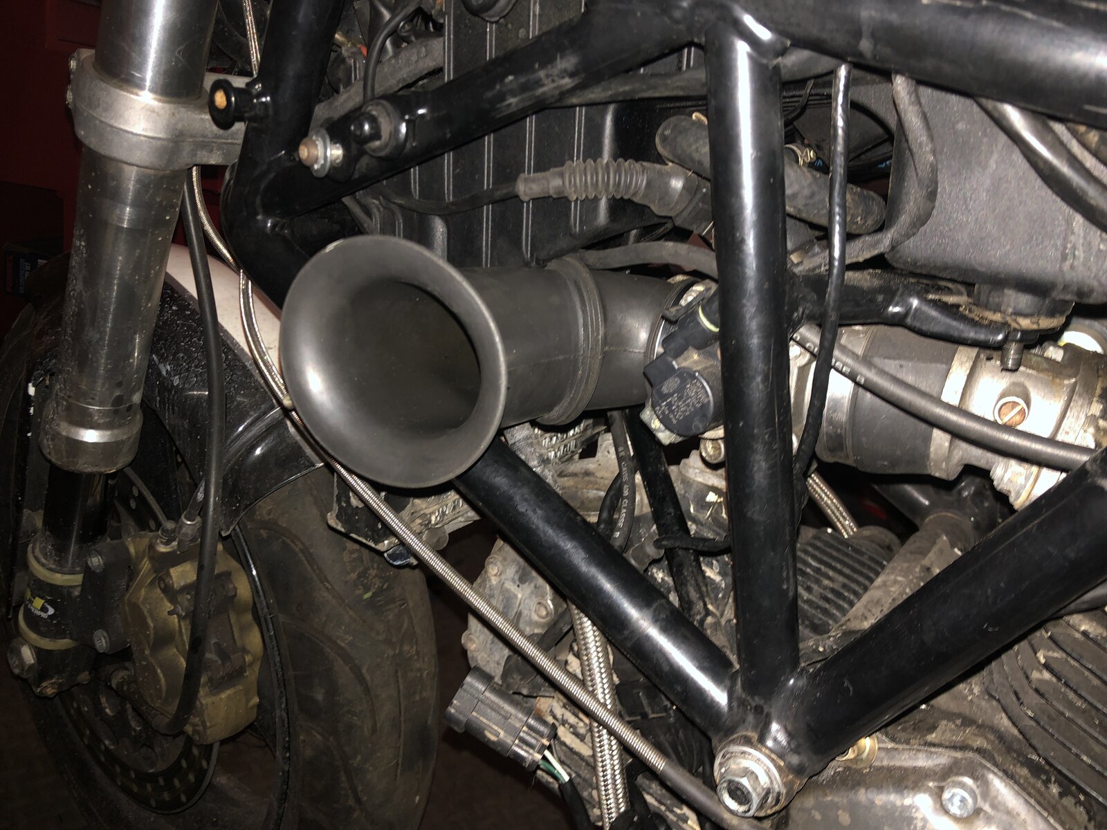

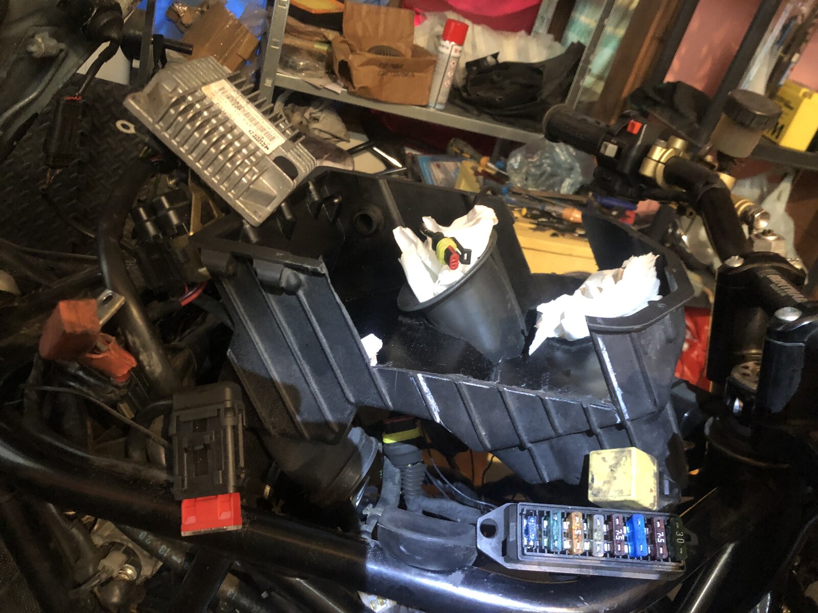

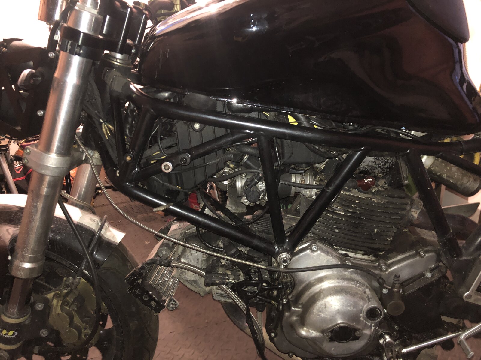

  19. Completed the job of modding the airbox on the 900ss bobber to be used as a hidey hole for the wiring, coils, fuses, relays etc.
    Discovered that my Dremel is missing it's chuck so I had to do all the cutting hand with a variety of junior hacksaws and bare blades, which was chucking annoying, but it turned out ok. Spent hours of trial and error working out how to get it all in and snapped a few wires in the process, but the bikes still runs although it now has no lights or indicators at the moment. I'll sort that out tomorrow.
    Looks a hell of a lot lot neater now. There's no room inside the box for cones and all the electrics etc so I removed the rubber trumpets and used their holes to feed in some of the wiring. Tbh, now I know that, I think I will now get another airbox but won't cut the sides and just feed all the wiring in through the air intake holes in the bottom.
    Now to find a way of fitting some form of air filters onto the throttle bodies. The rear cylinder is fairly easy as the rubber trumpet can be fed out at 90º and it'll be easy to mount a cone on the end, but the top of the front cylinder TB is very close to the underside of the airbox and so some other solution is needed.
    81D4CC6B-4C09-41A2-946F-D77BEF5CC9DF.jpeg EF3A16AD-B26A-4B3F-AB0B-68DF859B864F.jpeg
    Before
    After
