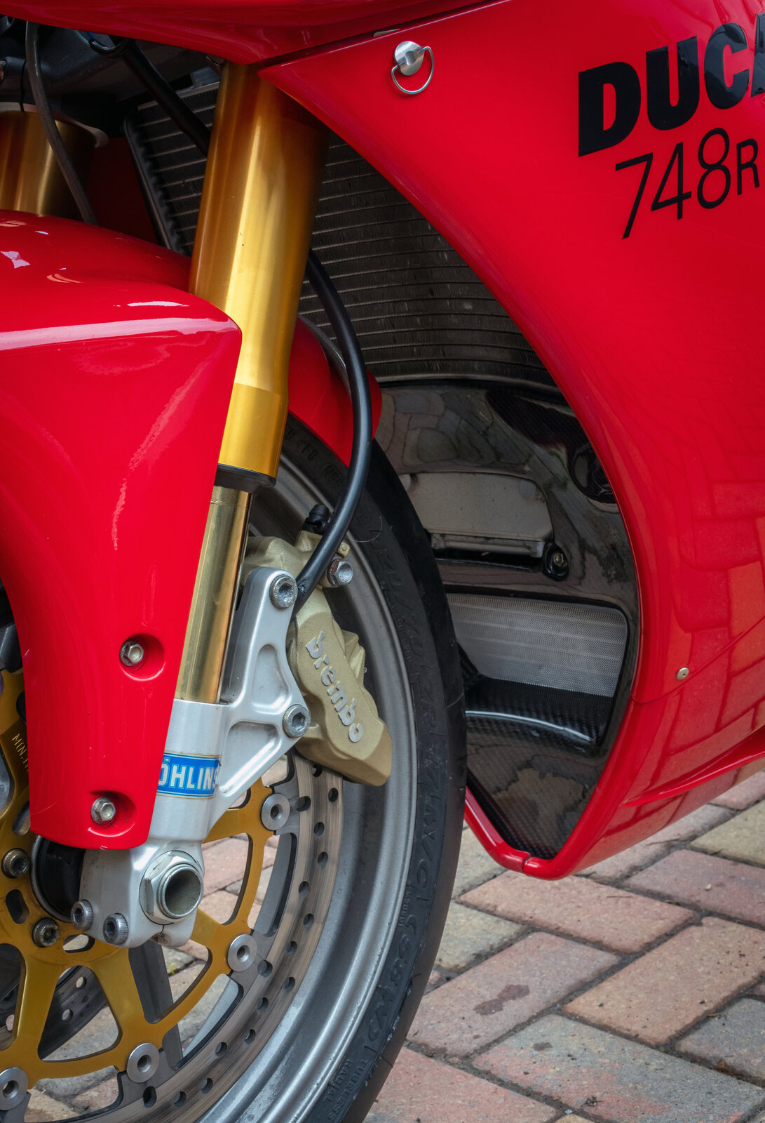

  4. Dropped off the bike at Ducati Mcr for new fork seals, the last pair have lasted only two years!
  5. Not sure whether to give you a like or dislike, maybe if they're Ohlins but just normal 900ss showa seals what's going on.?
  6. Haven’t a clue, I had the fork stanchions re-chromed at the same time as the new seals were fitted, but recently they decided to let go.
    The left one was especially bad with oil dripping on to the brake calliper.

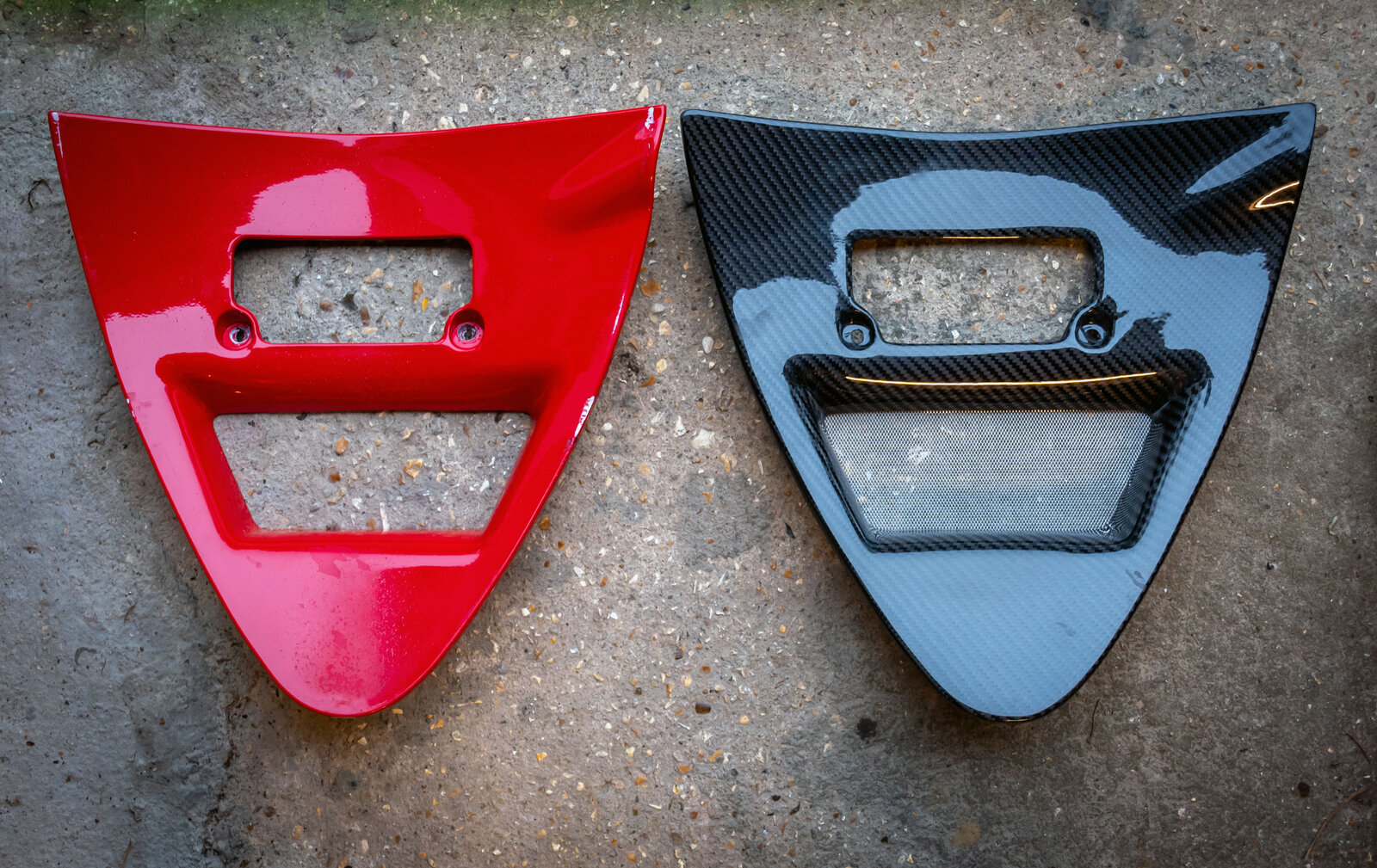

  7. Fitted a carbon fibre fairing v panel thingy. Bike now weighs 136 grams than previously :joy:
