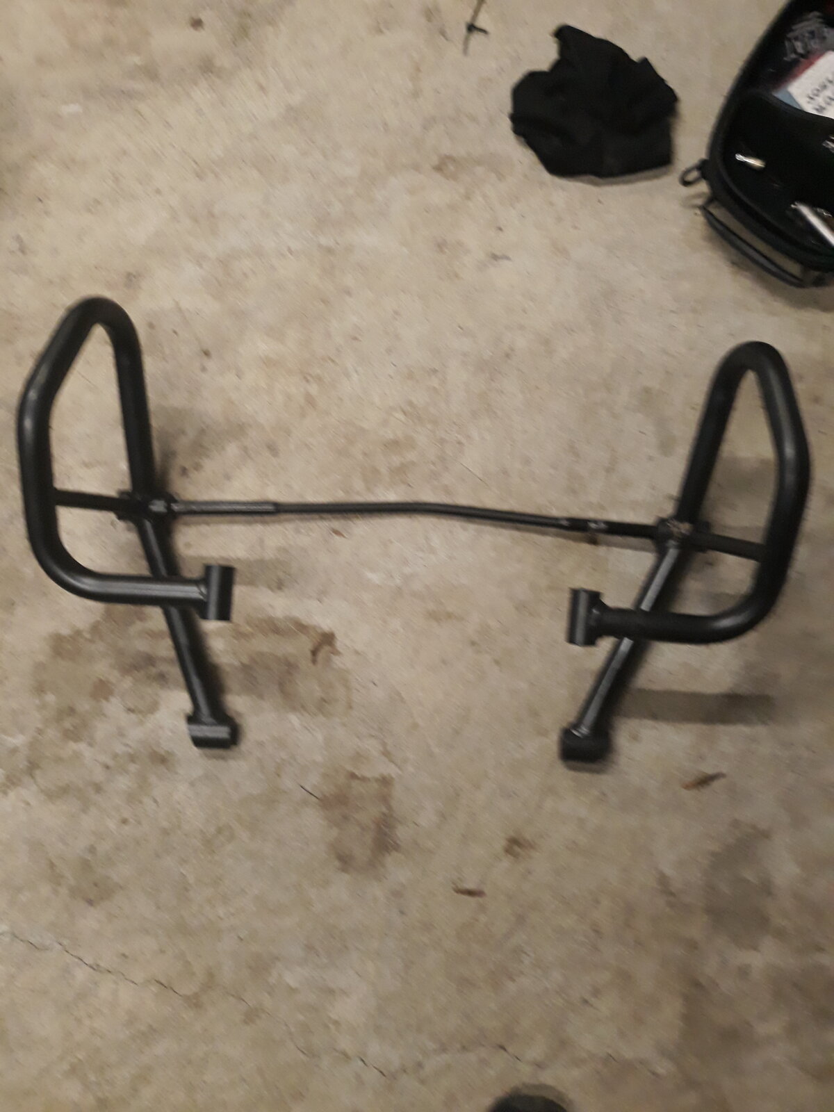

  5. I would expect the bolts to be straight. Never heard of a bolt that was manufactured bent by design.
    Post up a pic of the bolt :yum
    The offending bar is the one between the crash bars. I reckon it should be straight.
  8. I guess the next question is, does it affect how the rest of the bars sit against their mounting points.
    Personally I would expect it to be straight, because any attempt to tighten the ends will be trying to pull the bend out of it.
    The only reason it would be bent is if it is to clear something, so having a good look where it goes might give you a clue.
    Apart from that, ask the dealer. If they have fitted some they are likely to know.
    If its not going to hit / interfere with anything if you straighten it, I would do so.
  9. I fitted these exact bars to my bike myself, and I can confirm that the offending cross bar is supposed to be straight. Looking at the amount it's bent, the crash bars did not move much, I would just persuade it back straight again and bolt it back together.
  10. Cheers mate thanks, I'll get the lump hammer out!
  11. use a bit of heat on it if you can (blow lamp, hot air gun, put in the oven), will help it straighten without fracturing.
  12. I'm bringing it to an engineering company, they'll do a proper job on it.
