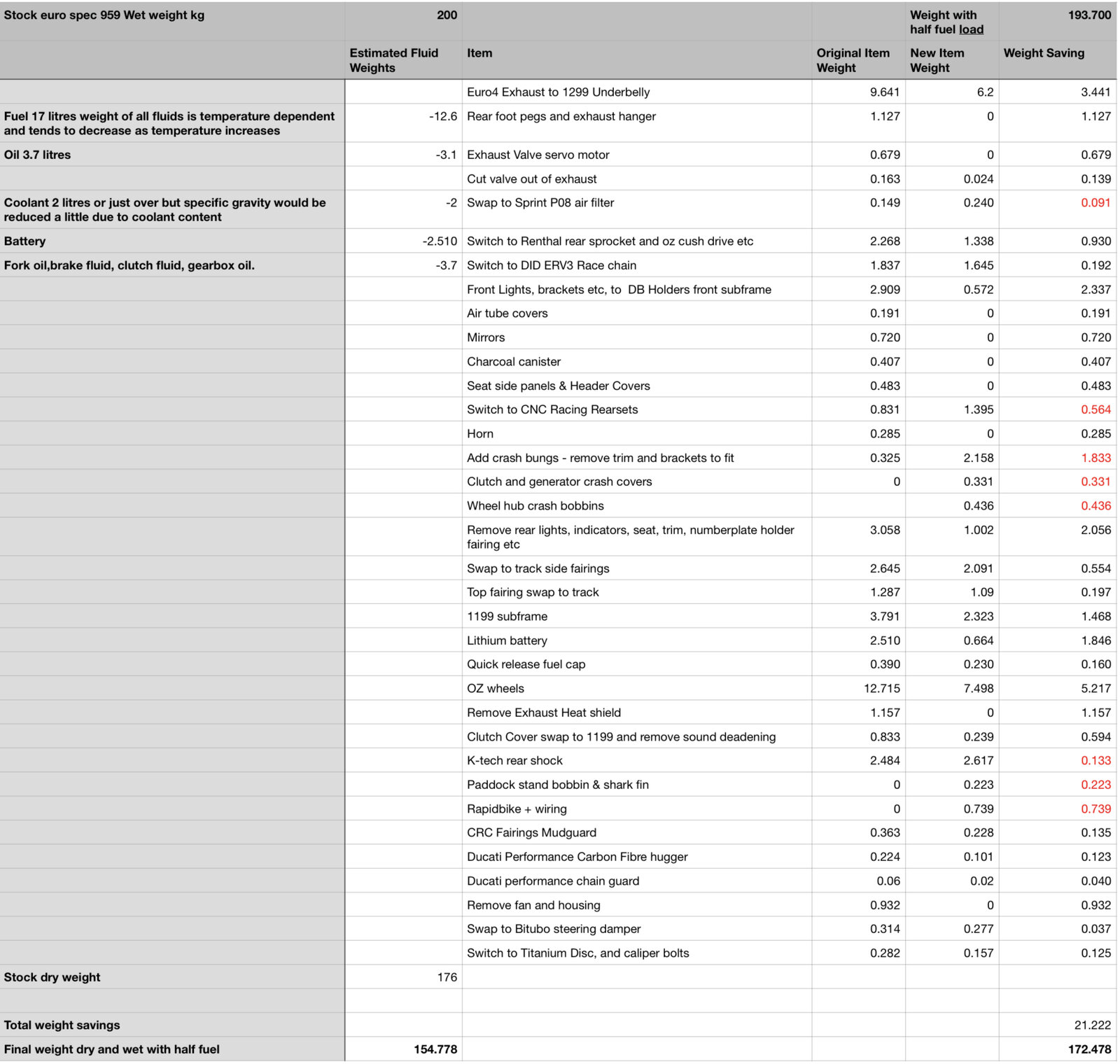

  6. Holy crap I wish this was for an 848/1098 frame and not a panigale frame - I'd bite your hand off for a copy of this spreadsheet! :)

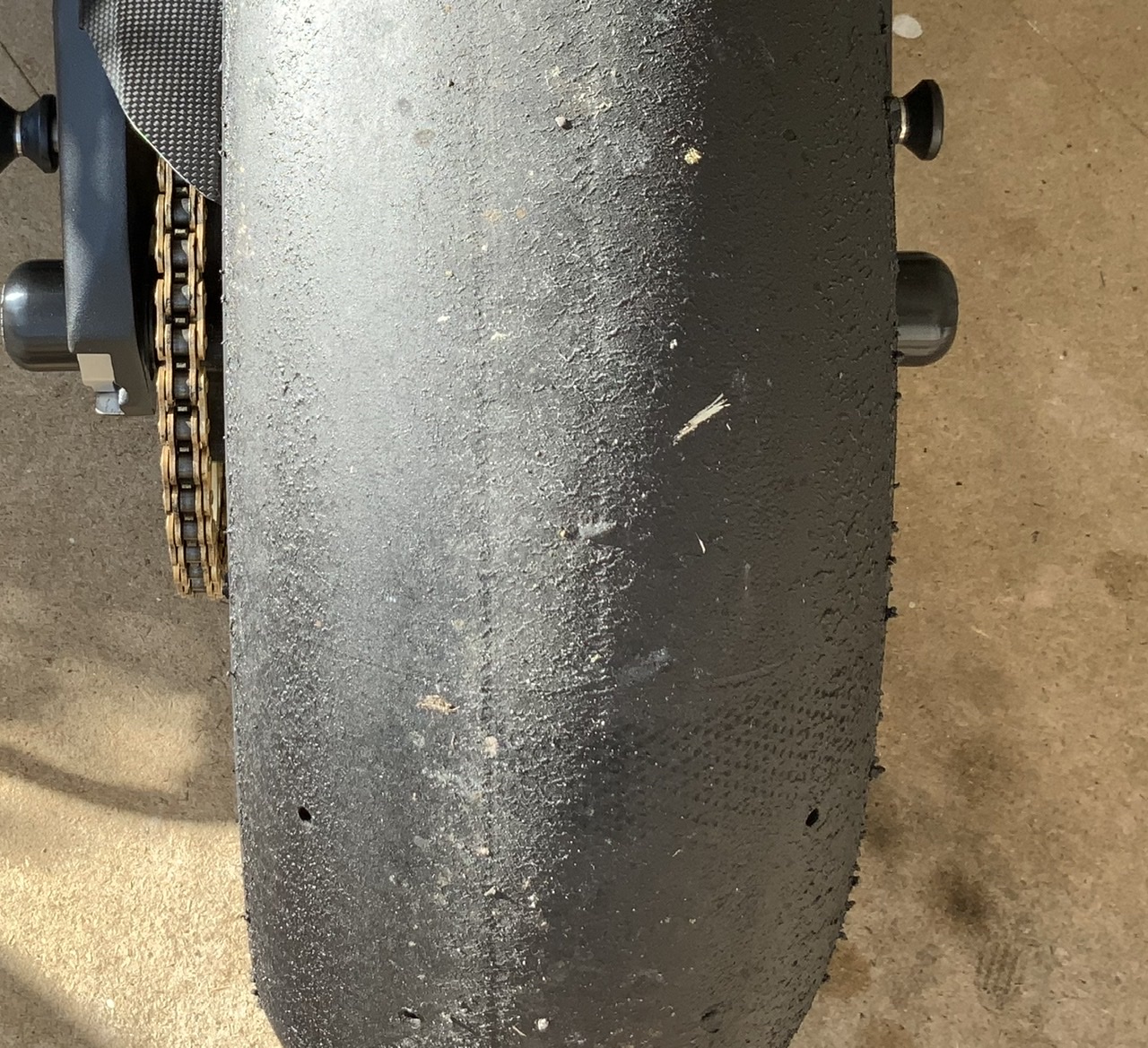

    Overall the bike is pretty incredible. It accelerates faster, brakes harder and turns much quicker than the stock bike. The new CompK slicks were very sticky and gave 100% confidence in the corners.

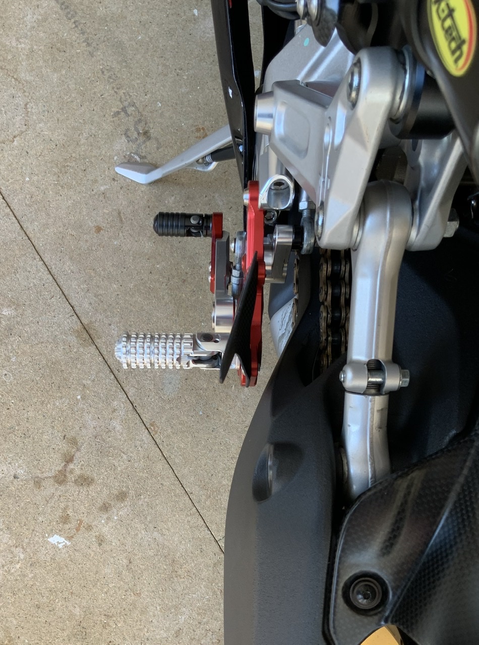

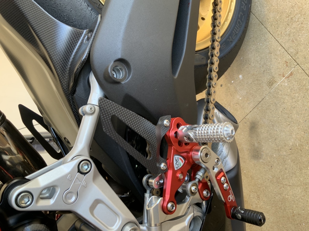

    A previous issue with the stock bike reared it’s head as well - my sidi boots kept catching on the heel guard. I had this before with the stock rearsets - they hook into the stitching on the left hand heel of the boot and catch on it. The CNC racing carbon one is actually worse - on the brake side it’s fine - much bigger and angled inwards - on the shifter side it’s much smaller and angled out - I now wonder if it’s the one that came with the rearsets as it’s a terrible design. The combination of the design of the boot and the heel guard is dangerous and very off putting - kept catching it each time I moved my foot forward to change gear - went grass tracking at the bottom of the mountain because of it!
    Brake side for comparison

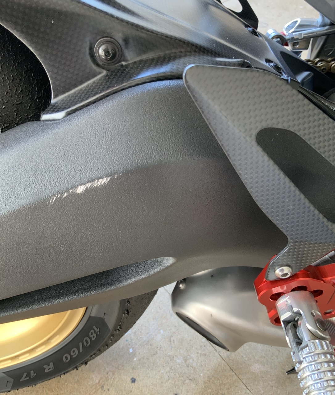

    A separate issue - boots scraped the swingarm - need some protection pads.

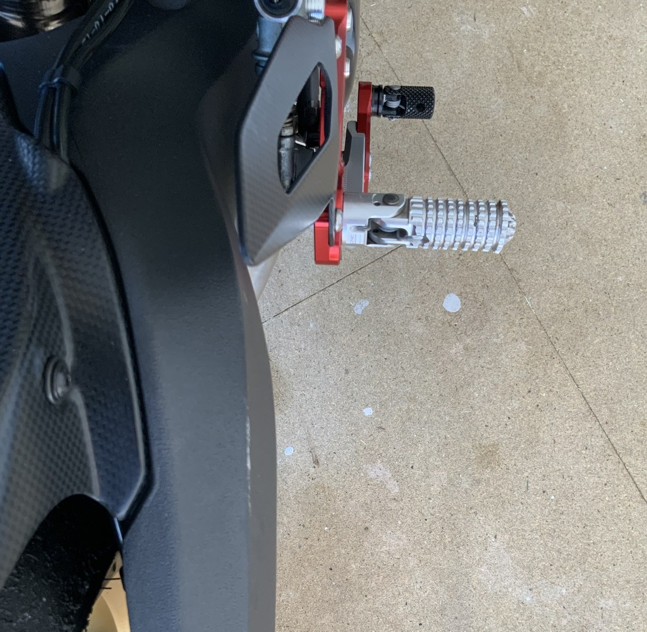

    Much smaller heel guard on the other side - angled so far out no scratches on swingarm - but dangerously catching on boots!
    Had the boots re-stitched last year but the new heel guard has slit the stitches again.
    Only really scrubbed the tyres in with all of the issues - but based on the feel and grip would recommend.

  11. Nice write up! Ditch the heel guard, not worth the head space. Or put a stock ali one.

  15. I shaped and polished the stock one on the other bike to fix the issue so I think for the moment I will fit that and put a fresh stock one on it to sell.
    I have seen the same issue reported on other forums - with the same boots! Wish I had read it before I paid close to £300 for them!

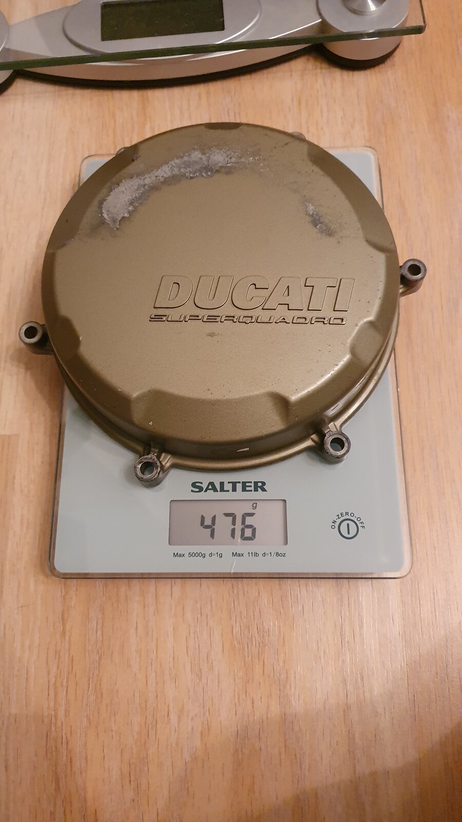

  16. I wondered who bought my mag clutch cover!! Did you also have my 1199 subframe; via flebay?

  18. Was that you? Yes I think I did! I reckon most of the parts are from members then! :grinning:
