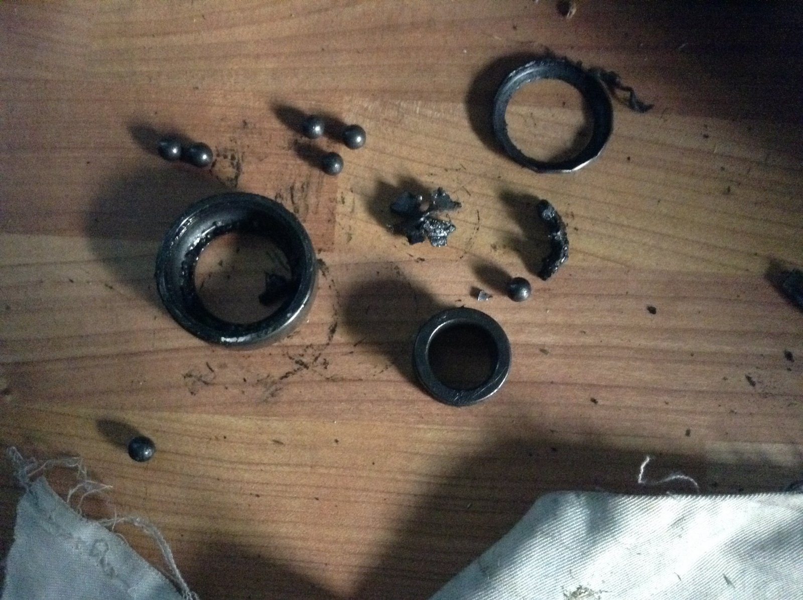

  12. Just to add insult to injury, I finally tracked down the strange noise the bike had developed since the first accident. The sprocket side wheel bearing had taken a beating when the chain came off. It look alright visually, but it must have suffered internal damage, and this is what it looked like 50 miles later.
    • Dislike Dislike x 1
  13. Araldite it, should be fine then!
