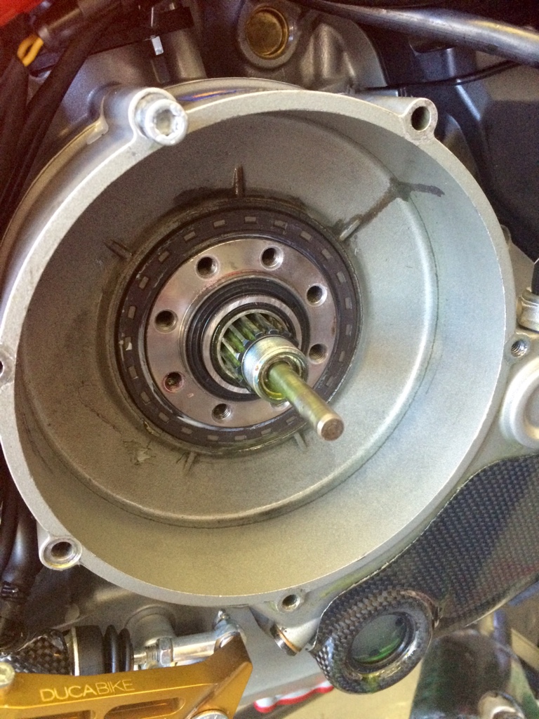

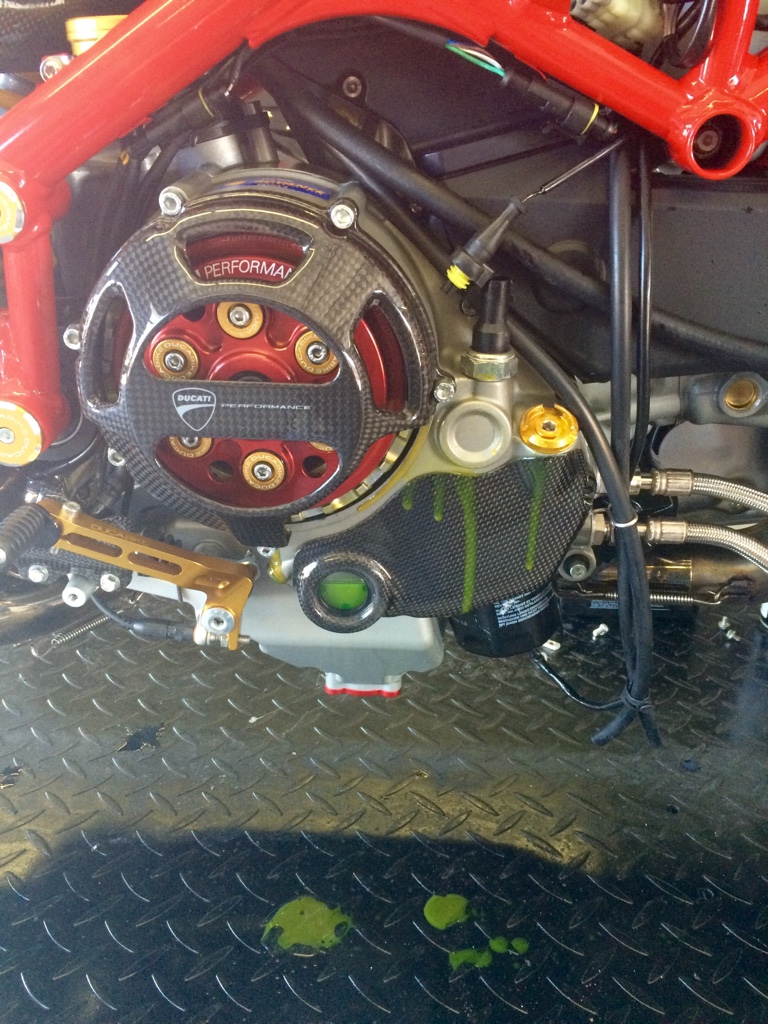

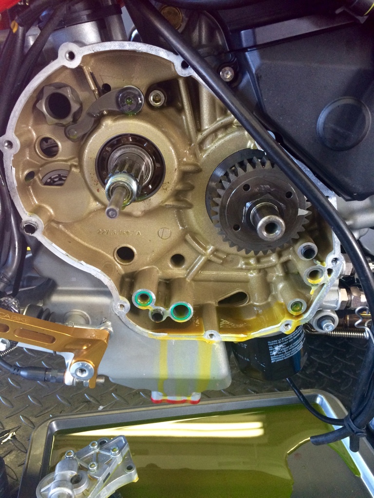

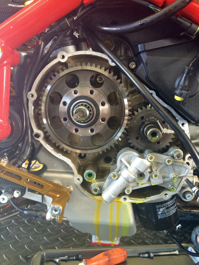

  15. Ok! The problem has been solved, filled it up with fresh oil & fired it up for 20 seconds & BAM!!!...it is the dry clutch conversion kit, luckily I already have the Ducabike wet clutch set up at home ready to go...so today this is all coming apart & tomorrow the new clutch will be installed!
    I am going to miss the dry clutch that's for sure...but here is the problem...
    Started to rip it apart & this is where its leaking from...

  19. I don't know on the dry clutch kits for other bikes would leak or not...but on the 848 from what I have read it wasn't a very good product, the leak is from the big nut that goes on the shaft & you can't replace that nut seal alone, DP doesn't sell replacement parts for this kit, you would have to dish out for another complete kit just for that seal!
    For me the only way I would go back to the dry clutch would be if I blow the motor then I would either install a 1098 or 1198 engine in there, I haven't heard any problems about those clutches!
    I have had this clutch leak on me in the last 2 years...I tried to fix it numerous times but with no success so it's going back to the wet clutch set up as of tomorrow, no more headaches!
