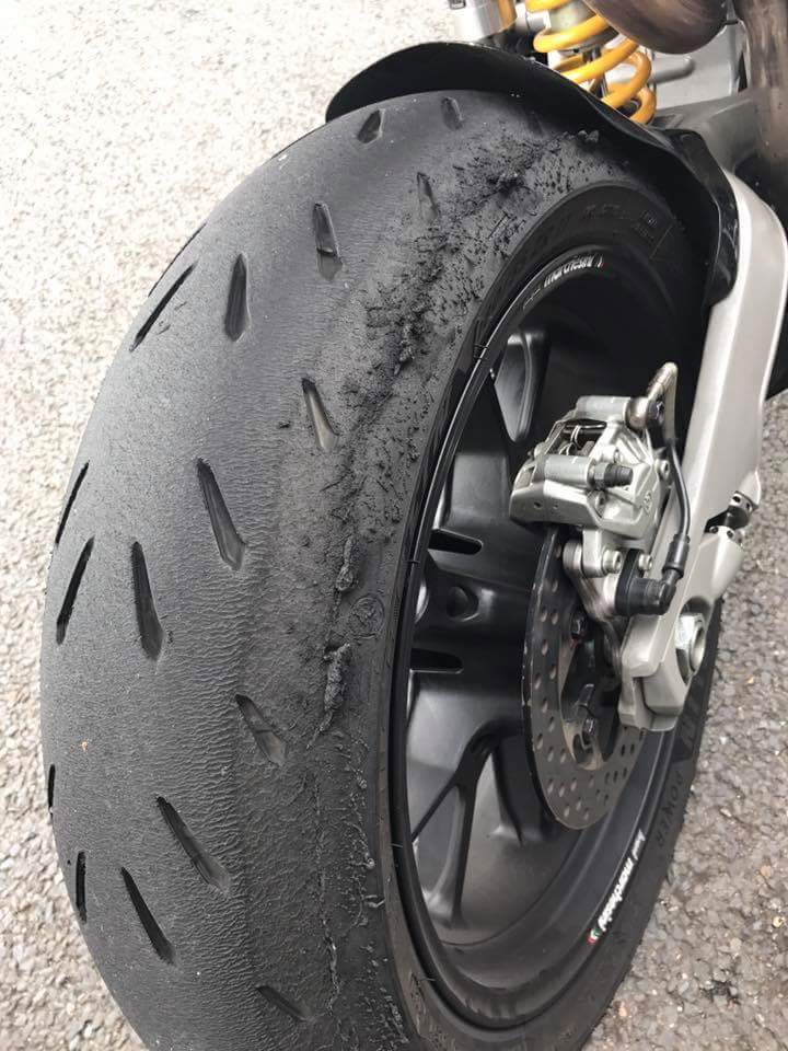

  7. It didn't clean up then. Buy some warmers and get the missus to drive the car with your kit in it ;) and what pressure were you running this time...
  8. It's not rubbing something it it? Didn't you put a different sprocket on and bring the wheel forward?
  9. 28 cold. Tyres guy said its delaminated and will never come back. They weren't keen on me riding home but had no choice.
  10. Wasn't infamous Steph was it....looks badly cut for sure

  12. Yep
  13. I'm so far from an expert, especially next to him, that looks like it been torn to shreds by heat/pressure incompatiblilty and over-zealous right hand and possibly some suspension issue with rebound. Looks more worn that falling off in chunks. Did he have some for sale at all?
    Note could be talking right out of my arse. Again. :sun:

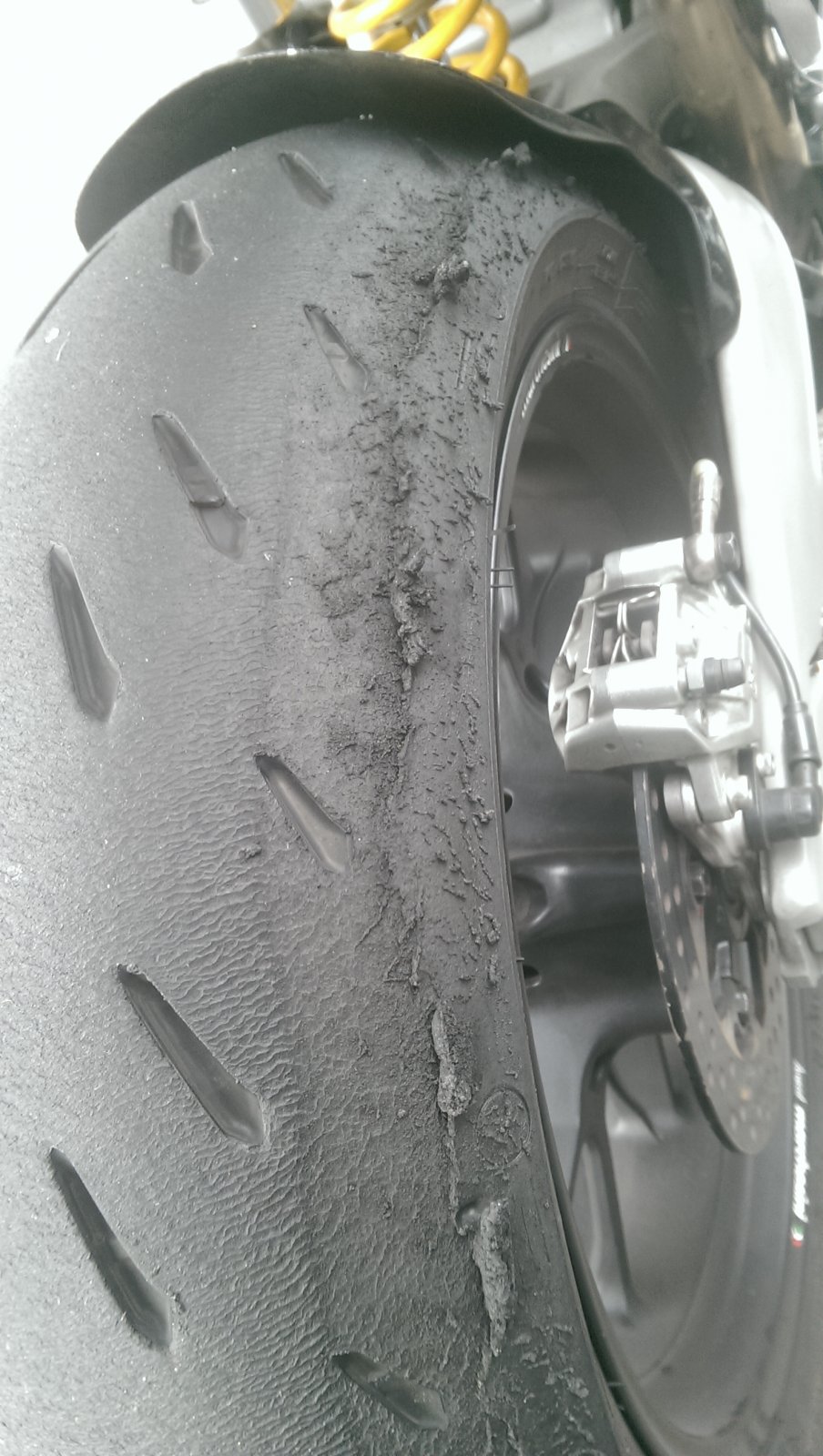

    Steve

  15. Well, didn't happen when I had my Pirelli on and most of the damage was done at Silverstone before I played with my sag.
    Ok, so maybe I was running 30 not 28 cold but that level of damage for 2psi seems excessive to me.
    I've messaged Michelin for their opinion and went to take it back to the tyre fitters but they were closed.

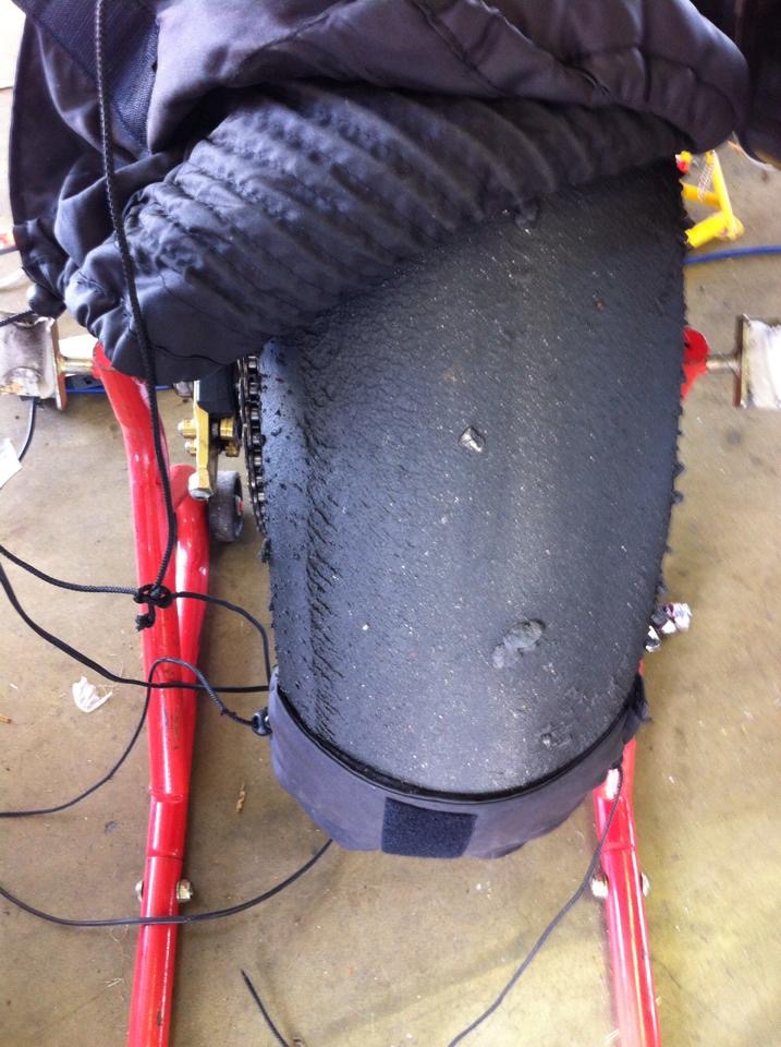

  16. IMG_2363.JPG Pressure and suspension problem, 2 sessions brand new tyre. Looks like the start of yours from Silverstone
  17. That's odd, for the rest of the tyre, the pressure looks spot on. The wear on the outer band, about 2", seems a lot heavier as if the tyre is not heating up uniformaly. You are going to hate me, but my money is on the suspension set up. From your earlier post about losing fillings on the ride to Bedford, my guess is too firm. There is also something at the back of my mind I think bradders said a couple of days ago, your ride height might be out. Sorry you got sent home, the tyre looks like you were havng fun. Andy
