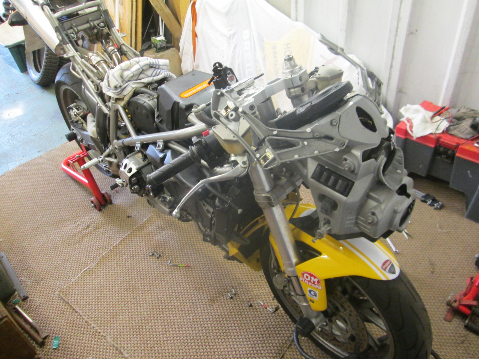

    I also sort of, got to the bottom of my Ducati complete electrical failure last week, turn the key and nothing works except for the rear light, no dash lights, headlight or bar controls. The old girl got me home safe before running out of electricity so no complaints. It was a bad connection somewhere around the headstock, I`d checked all the connectors on the left side of the bike and nothing, still no life. I moved the bars to full left lock to check the ones on the right side and the dash lights up and everything works again, hurrah!!!
    I can`t get the fault to happen again so I`ve just checked all the connectors on the right side and call it done. The bike is going to V-Duo in a couple of weeks for belts and I`ve asked Adam to also strip and clean the big bowl of spaghetti that is the battery box, I`ll ask him to double check all the wiring as well. I hate electrics.
    Now to crack on with the basic service stuff. Already cleaned the air filters, just oil, filter, oil screen this time as well, strip and clean the clutch and brakes.
