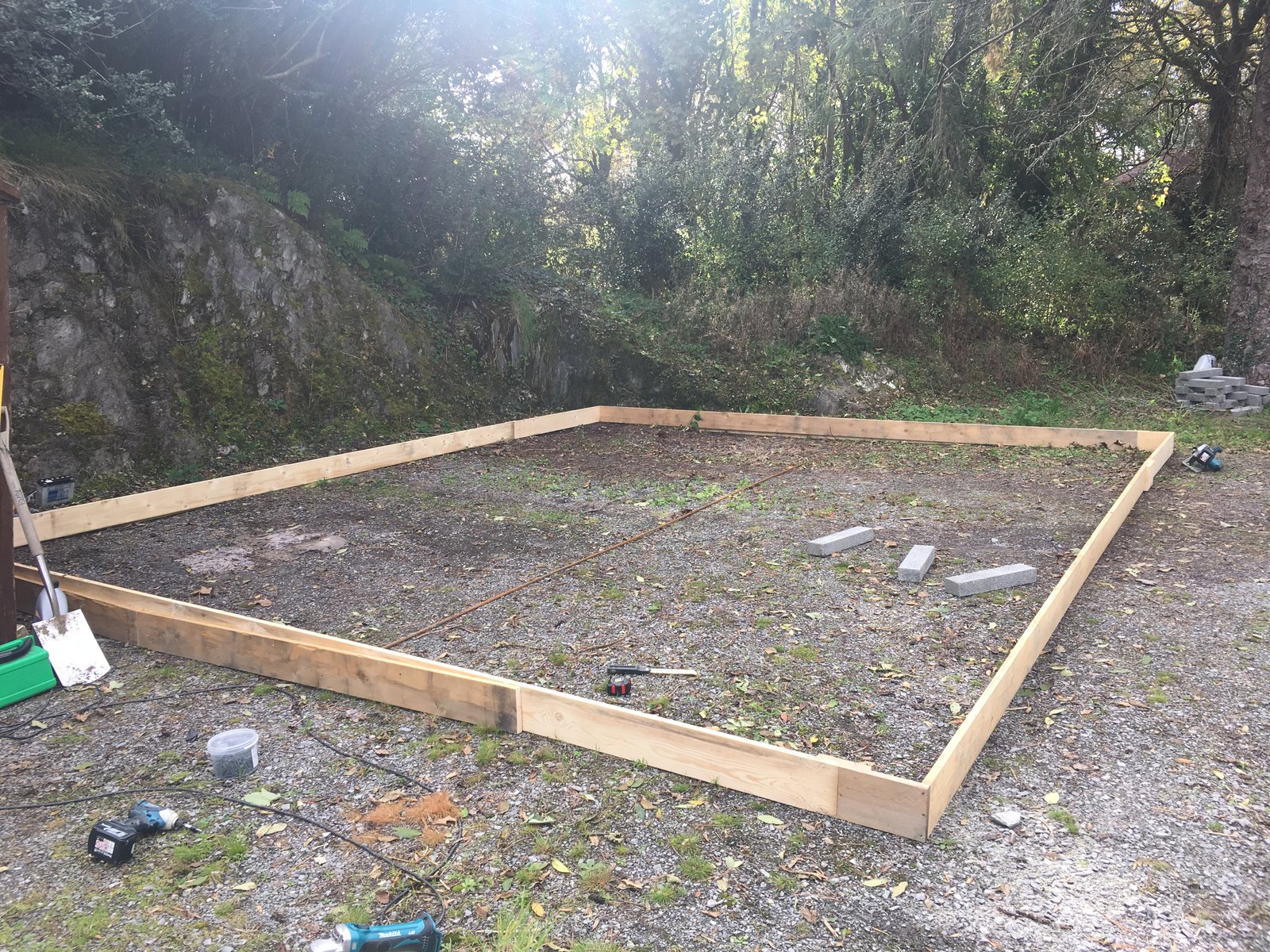

  3. That looks to be about 5m x 4m on a 200mm slab, I would definitely put reinforcing mesh into a concrete slab that size

  8. Not far off, 6x5 actually. The concrete is coming Friday morning so earlier that day I’ll be setting out plastic DPM, blocks and rebar mesh. I can’t do it before in case it rains and becomes a paddling pool. Also there’s so much dew in the mornings at present I’d still probably have 1/2 inch water in there if left a couple nights.

  9. You will need steel pins banged into the ground alongside the wood (every 600/1000mm)or the weight of concrete will push out:upyeah:

  11. Thanks, that’s today’s job, if I can find the angle grinder!
  12. Good luck:upyeah:

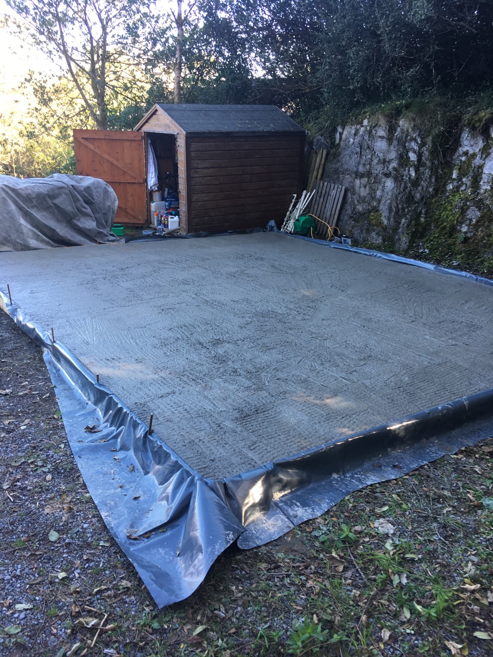

  18. Laid the concrete slab for the garage today as I had a call telling me they'd deliver a day earlier! Panic to get the prep work finished. Not perfect, but not bad for a first time effort :D. Never done it before in my life.
    ps. That's the 748 hiding under the shroud, whose home this is to be.:upyeah:
    pps. Before anyone comments, my plan is to finish it with self levelling compound.
