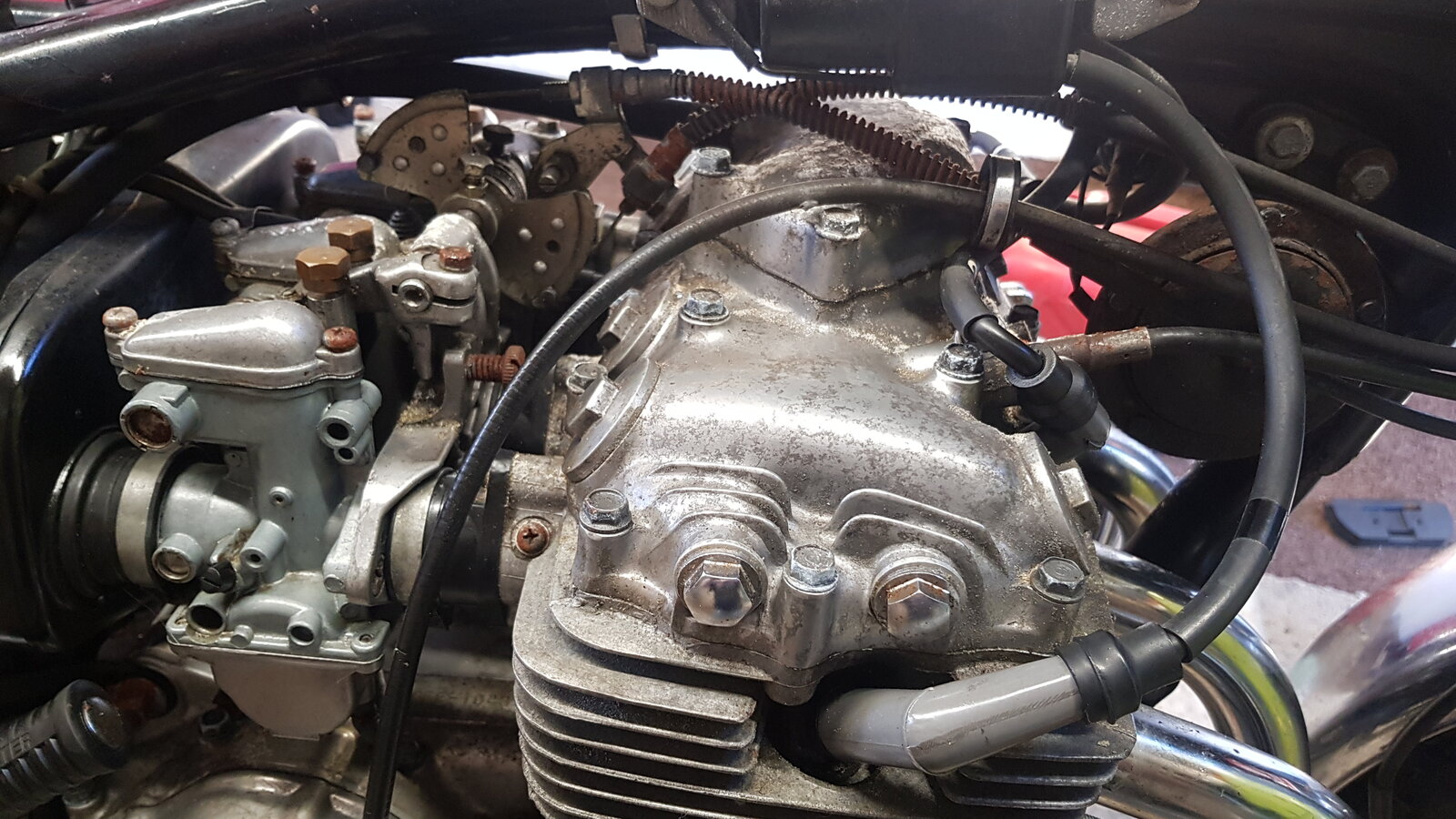

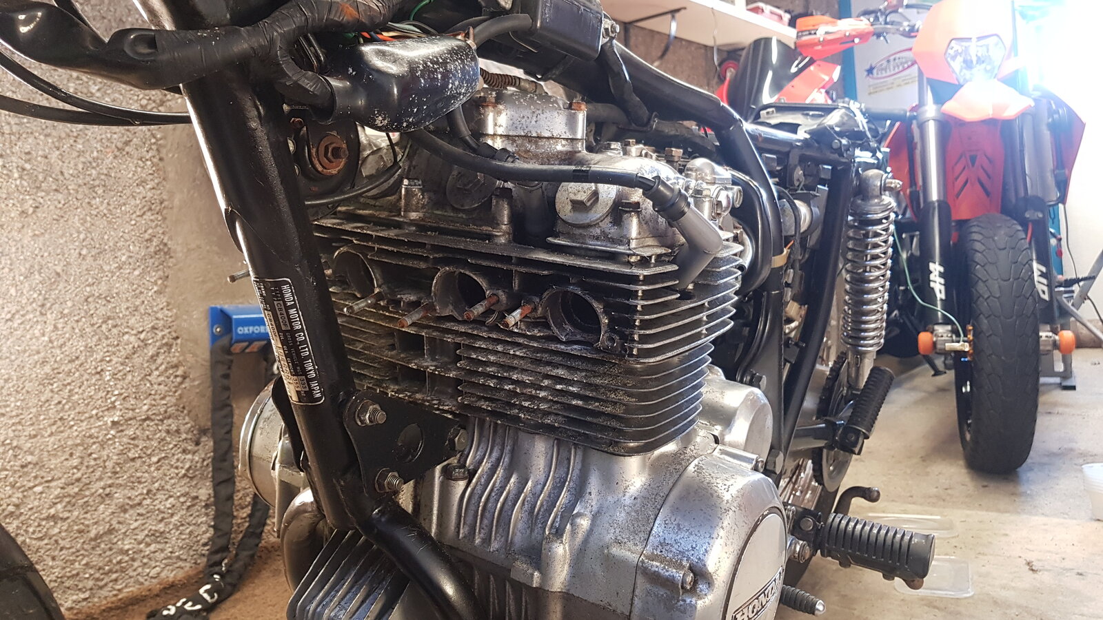

    Re cleaning the engine can’t you just mask off the inlet & exhaust openings and then have it soda blasted?
  2. As Paul mentions above, keep it complete and blast it but if you do use a company that is very used to doing motorcycle engines, this way will be the most cost/labour effective,
    Only other way is as you know complete strip and aqua blast ever piece which i would think would cost around £150?.
    It would take you a lot of hours to try and do it by hand and still probably wouldn't look that good, if you went this way you could take the side engine cases off and get them aqua blasted and maybe the top cam cover which would help with the over all look of the engine,
    Should you try yourself, use those thick ladies nail files to get in-between the fins and yes start a thread.
  3. Could the engine be aqua-blasted complete??? - be nice if it could..
  4. I would like to say yes, but wouldn't fancy taking a chance with blasting with water and i think glass not getting in somewhere, i know in theory
    as long as its sealed off it should be fine but i would think water will get in.
    Try a few companies first and see what they suggest, soda doesn't use water i think so should be better for complete engine but I've never had complete engine blasted I've always stripped them.

  12. Dremmel using wire brushes, followed by dremmel & nylon brushes with autosol? There are a massive variety on eBay.
    The wire type fall to bits quite quickly, and the small wire strands get in your hands and clothes so wear gloves and crap jeans & hoover up afterwards. Its laborious but it does work...

  14. soda's good but some also use crushed walnut shells
  15. There is a company up my way in Bridlington that does Soda blasting. Claim to have done motorcycle engines complete without any problems. Bit far for you I realise
