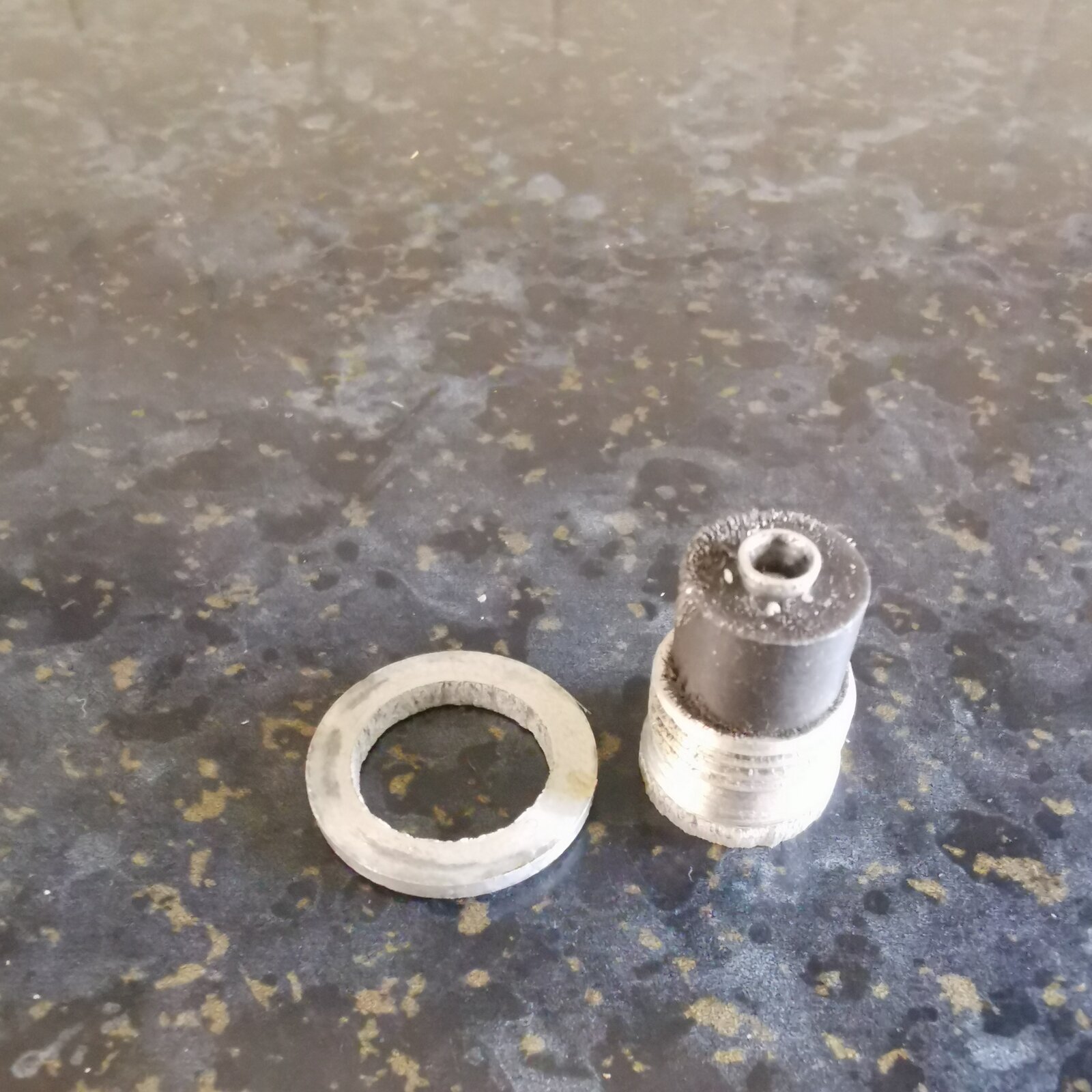

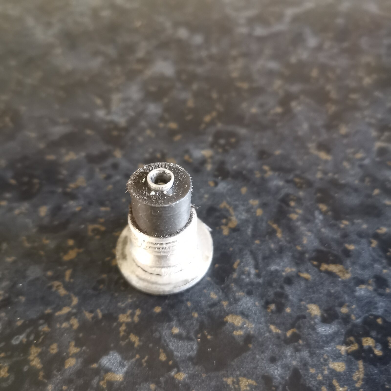

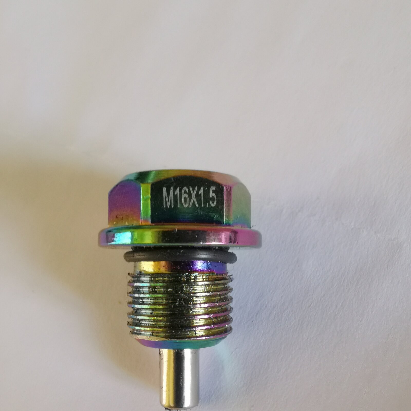

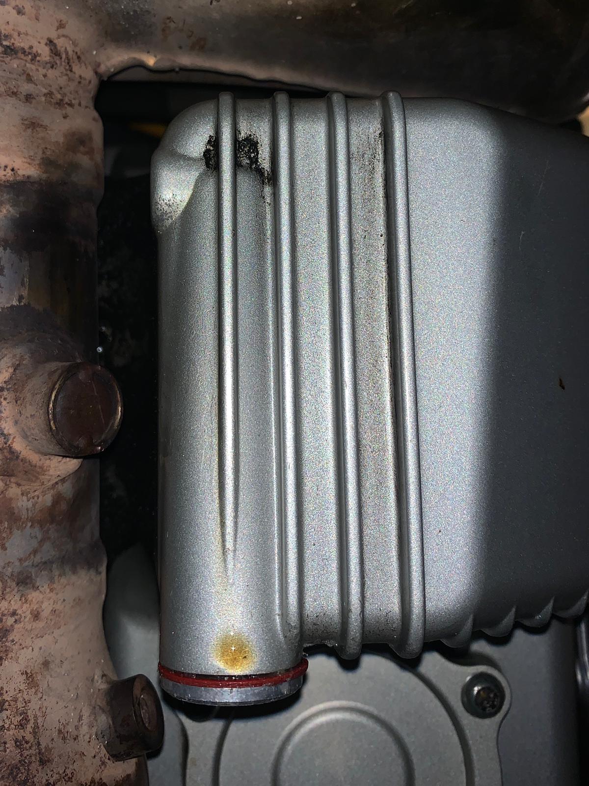

  6. After finding a small oil drip on my sons MV F3 675 from the sump drain plug.
    He fitted a new copper washer, still dripped, fitted a fibre washer and a smear of gasket sealer, still no luck, it took a couple of days to appear. Today I decided to try and sort it once and for all. On removal of the plug and close inspection I could see a ring of unmachined material around the head.
    IMG_20200617_141759.jpg A closer look revealed it was a crack, possibly due to over tightening by a previous owner, it is made of alloy and the flange is very thin.
    A little tap and it came apart. Hopefully this new plug with a bigger head should solve the issue.
    Yes I did say flange.

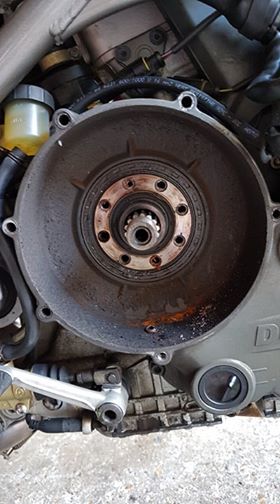

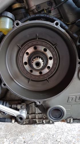

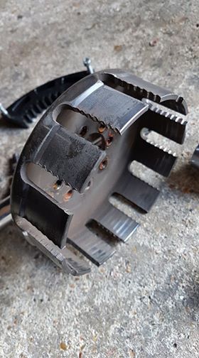

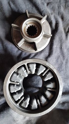

  8. I thought i would pull the clutch out of the 996 today, basket fucked, friction plates worn out but Boss clutch and cush rubbers all good!!!! 104368670_230153881748706_795066839728150115_n.jpg 104844242_267292511021488_1882557173929376881_n.jpg
    104570374_619740462302895_1036778179730473684_n.jpg Before.
    104330513_259582548818756_5580641614166027142_n.jpg After.

  10. 20 year old dunghill:upyeah: i'm pretty sure that basket has never been changed, it's the one it was born with.
  11. daren't check mine then its 30 yrs old must be a sewer in there ! Less than 20k so i expect it's original.
  12. Well worth doing though, i'm sticking in a new light basket in and plates, and a nice new pressure plate bearing!! I don't know what it is but all the bikes i've owned over the years there seems to be a bit of a love hate thing with clutches.:grinning:
  13. must admit Wayne, that dry clutch rattle does give me a bit of trouser movement :blush:
