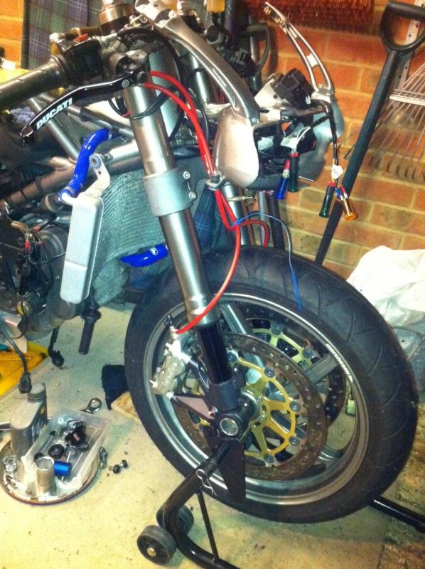

  4. Went for a ride to Goodwood for b-fast, then had bacon & egg batty yummy plus looked at cars, had chat with people. Departed home, took wrong turn and bit later ended up in Box Hill. Had a coke. Went home got lost on the way in Richmond again!! Got back about 1430 and had a doughnut. Later did laundry and watched The hunger games now it is nothing like Logan run?! Cooked dinner, farted a bit did some internet and now going to sleep. How is that for busy day?
  5. Most excellent!
    Have you managed to retain the original discs or are they 748R ones?
    I'm still musing over this conversion but would ideally want to retain the original speedo drive and gauges.
  6. You found some posh forks mate? :upyeah:
  7. They are 748R ones with the 15mm offset so I keep my original front wheel.
    Doing the speedo conversion isn't a problem but I've used a spacer as obviously I'm fitting the TransLogic as well and that uses a speedo sensor instead.
    It was actually very easy to do - the forks go straight in. The spacers are fiddly as I sourced/made my own... a top tip is to purchase a bearing of the right size internal diameter (25mm) and width then cut the outer race off and junk the bearings ... instant spacer of the correct size!

  9. No problem, just drop me a note if you need more info.
    I managed to get a second-hand pair of disks for £150 off another DSC member, so it was cheaper than buying the newer wheel with disks!
  10. Are there not 5mm spacers available for the discs?
  11. Yes, but I wanted to go for the disks and not use spacers.
    You will have issues with using spacers if you want to keep the speedo drive as there then isn't enough room for it!

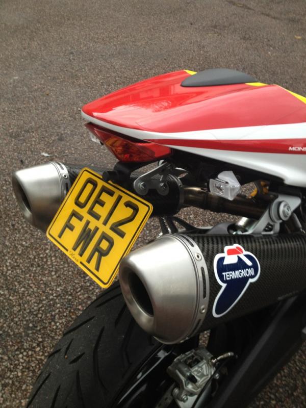

  14. Were the tail pipes still warm when you 'DID' them? :eek:
  15. The rizoma indicators were a steal too

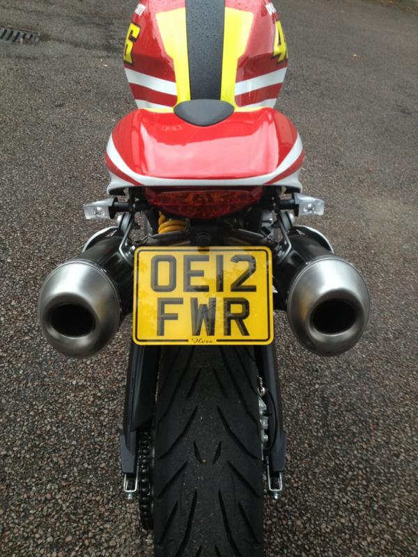

  17. Is that a personalised number plate: Phwoar!?
