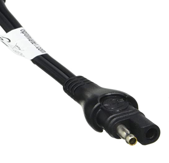

  8. Throw a picture of the connector on the end of the pig tail fitted to the bike Terry. I might have something to get you charging. Andy
  9. This is what’s fitted to the bike

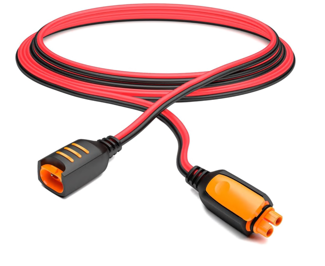

    This is what the CTek fitting looks like (I think)

  11. Okay, you have 3 options, buy a Ctek to Optimate adaptor, about £14 off Amazon, attach the pig tail that came with the Ctek charger to the battery instead of the Optimate lead or exchange your Ctek for an equivalent Optimate charger. This IMO is the simplest solution, https://www.amazon.co.uk/CTEK-56-56...43&hvtargid=pla-486957975267&psc=1&th=1&psc=1. Andy

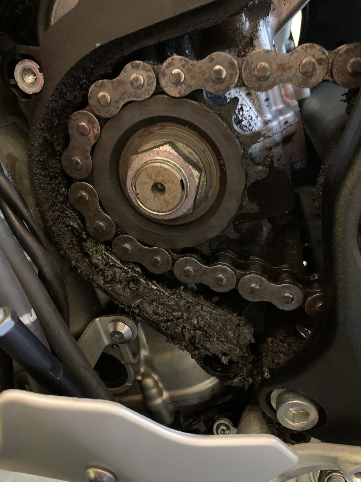

  12. Cleaned the crud out of the front sprocket cover. Often an area of neglect but I’ve not seen it this bad. Has anyone got experience of these OEM sprockets with the dampers on them? Is the chain designed to rub on them to reduce noise or is it a sign the sprocket is worn? I’m thinking the latter
  13. I've used them on lower powered Cagiva bikes but they didn't have the large rim that yours displays, i'm guessing this is a fail-safe feature, and yes, pretty certain that that "rub" is wrong. I know it's hard to assess with the chain tension on, but have you checked the sprocket for radial and axial play?
  14. I haven’t yet because in honesty my plan was just to replace it with a 15t sprocket but I’m not sure now whether I should really do the chain and sprockets as a set, normally as a rule I wouldn’t mind on low mileage bikes just doing a sprocket but my bike has 15k miles on it
  15. I wil probably get slated but i've often done 2 front sprockets to one rear over the years, especially if rear sprocket is steel (I realise yours isn't).
  16. It is actually Steel, it's the standard OEM one at looks really good, so I might just change the front one for now, or buy a chain measurer, as they are quite cheap and handy to have.
  17. no brainer for me then, you know you can get a good idea of the state of things by pulling/trying to pull the chain off the rear sprocket at the 3 o'clock position, you have to interpret this carefully of course, as can show sprocket wear and/or chain wear.
  18. The moulded in ring is really just a damper when you engage gear and get slight chain whip jump.Two schools of thought, replace the lot or swop out front. Really should bed in as a set but each to their own.
