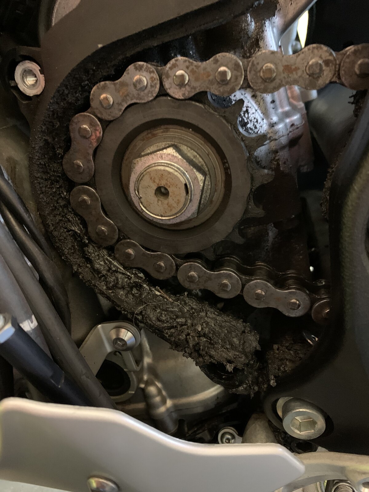

  2. Your standard sprocket has the rubber sides, helps to reduce noise, did you say it’s done 15,000 miles?
    I would be tempted to replace it as a whole set :upyeah:

  4. I wouldn’t be able to sleep at night if my chain looked like that!

  8. A great idea up to around 30 brake but can cause problems even before sprocket teeth wear out on anything much greater, particularly if constantly subjected to oil and chain lube.
  9. The mouldings are external only. They only reduce whip and jump to reduce noise. They are quieter when new.
    Sprocket is same thickness plus the damper ring on each side for the side plates to ride on, wears out rapidly if chain tension is not correct or sprocket worn. Low power bikes have spline core moulded to sprocket like a Cush drive. High torque motors rip that type to shreds. The one shown has done it’s job and worn because of side plate slap and certainly sprocket wear.
    Change it or Change as a set. Chains and sprockets are consumables.

  13. Sounds like you agree then, despite the "damper rings" :thinkingface:* - a bad idea for the more high powered applications. :upyeah:
    *will have to research the designed-in "ride-on" bit, sounds ridiculous to me..
  14. Two types being discussed. Solid sprocket with bonded on external damper rings. The rings reduce slap/whip and resonance. Quieter. Lower of the chain side plates are damped as they enter mesh by glancing ring contact, the ride on bit, which wears out the ring. You can see the mess made of the “rubber rings” in the photos. Sprocket almost certainly cream crackered.
    Second type which I think you have in mind.
    Hub and separate sprocket through bonded together. Lower torque/ power transmission but less alignment critical used on a lot of industrial applications and smaller capacity bikes etc. cheaper to make, mix and match teeth and hubs.
    Front sprocket I would suggest definitely needs replacing. I would replace the set. Best practice, each to their own.
    Personally I would use plain solid sprockets of good quality. Adjust chain regularly and use decent lube.

  18. thanks, useful info. I’ve had the bike 1 week so I’ll get on it, the Bike has some chain ‘whine’ at low speeds even though it’s adjusted fine, so it’s probably where it’s worn, I’ll change them and go down a tooth at the front probably at the same time
