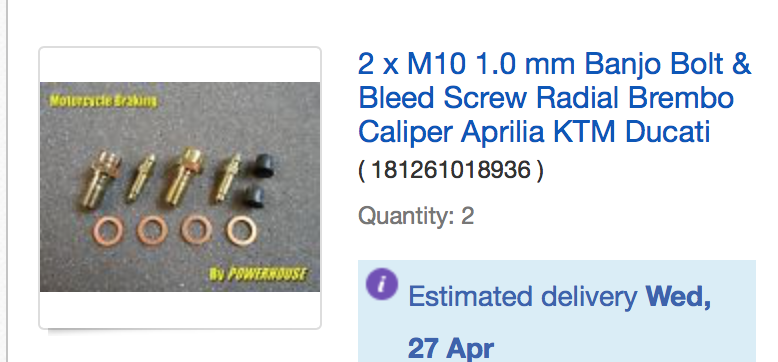

  3. Just brought these hope they are right , Screen Shot 2016-04-24 at 12.51.45.png
    Given its brakes , what torque settings should i use ?
    Regards
    Chris
  4. Can you please let us know if they're any good Chris?
    10NM is the usual T/F for this sort of thing - but you'll need an accurate low value wrench to trust. Personally when it comes to Plugs and nipples I prefer to go by feel!
    :smirk:
    Lumpy
  5. Thank you I have a set of 3 Norbar torque wrenches with one from 1nm - 20nm so trust it for 10 as nicely in the middle. I did the banjo bit to 23nm and 10nm for bleed nipple. The quality of the components that came seem great to my laymans eye. But WOW ! seriously WOW ! my back brake is solid works a treat. I bled at abs unit and it came out full of tiny tiny bubbles for ages. Brilliant now , I did the front inc abs and still got a problem there in that i can pull lever to handle bar , but the actual braking is great and rear will lift with a hard squeeze i just hate the fact lever will pull back to handle bar when stationary and i can't figure out why . there is no air in the system. They work fine and when riding can't pull back to bar .
