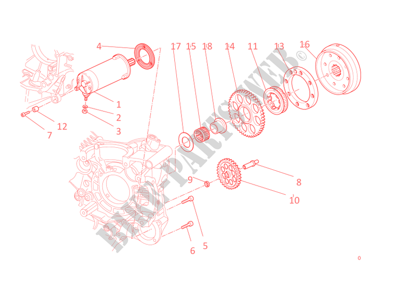

    I think i am going to buy new oem parts...there are three parts involved...the clutch, the driven gear and the flange (11,13,14)

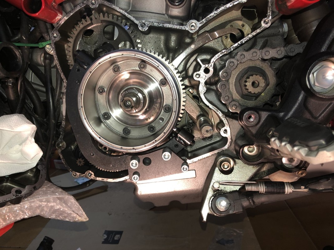

    Well, at the end I could buy all the parts... a new sprag (the clutch, the driven gear, the flange and a new crankshaft nut). Nearly 400€. I had to buy a flywheel lock tool (80€) as well...
    This weekend I finished the repair..

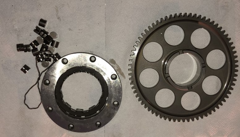

    Once flywhell was out I disassemble the flange and the sprag came out in peaces... probably changing only the spring had been enough but I prefer new parts on my bike.
    The only tricky part was separate the flange and the flywheel to arrive to the sprag. It is needed to insert two screws from the flywheel rotor side in their holes in order to remove the flange and the starter clutch. This operation takes me around one hour and I damage the two screws thread. :confused:
    I had to buy new OEM screws.
    Once the flange and the flywheel are separated the rest of the work is relatively easy.
    With everithing mounted back another point is how to tighten the cranckshaft nut (Min. 313NM- Max. 346NM). I had to borrow a dynamometric wrench...friends are great!:innocent:
    Well, now it's time to fit the generator cover... apply sealing compound... screws on and thats all.
    I have to say that I don't understant why italians don't use gaskets as the rest of the world! :mad:
    With everything mounted back fingers crossed... :expressionless:

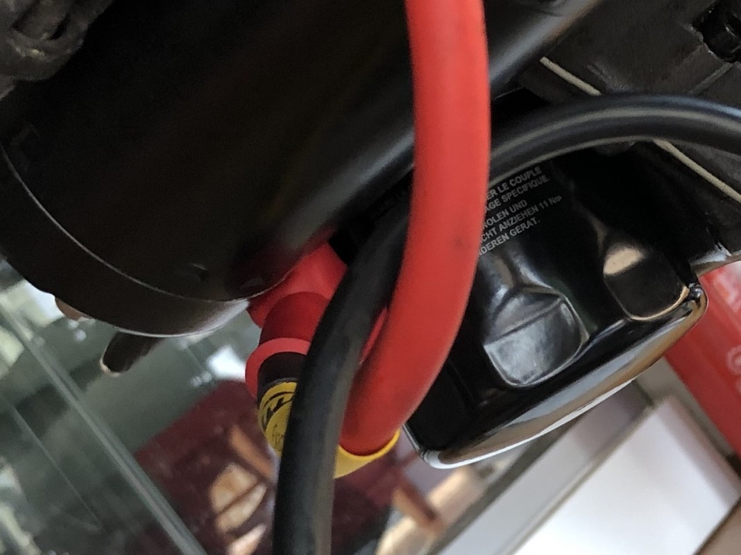

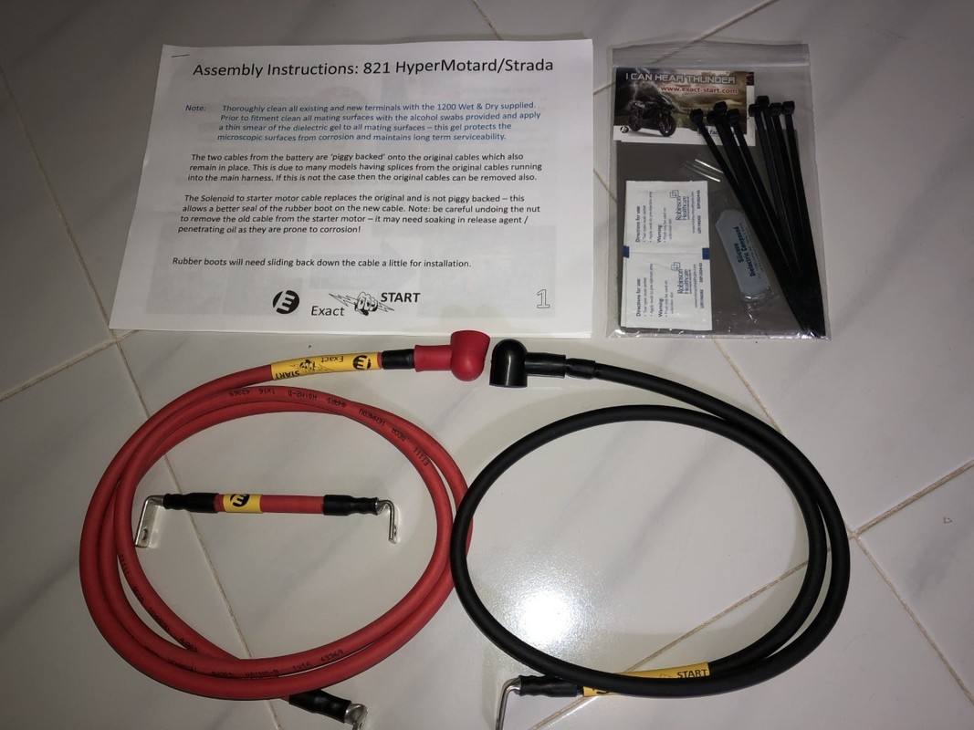

  13. Santa sended me a present for the bike.
    He contacted with exact start and got a cable kit to improve the starting. Thanks @Exige !
    Easy to fit... cheap improvement... highly recommendable
    Just check the section difference between the OEM cable (black) and the new cable (red)...
    This is how the kit works
    (the engine was hot)(first time starting like this)
