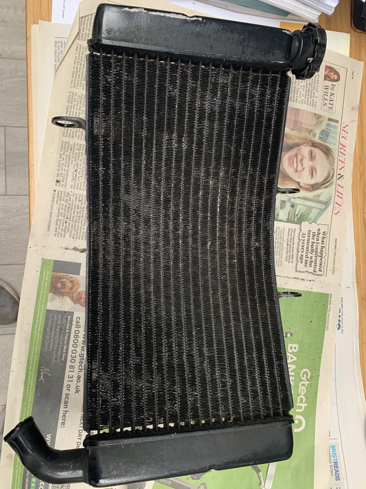

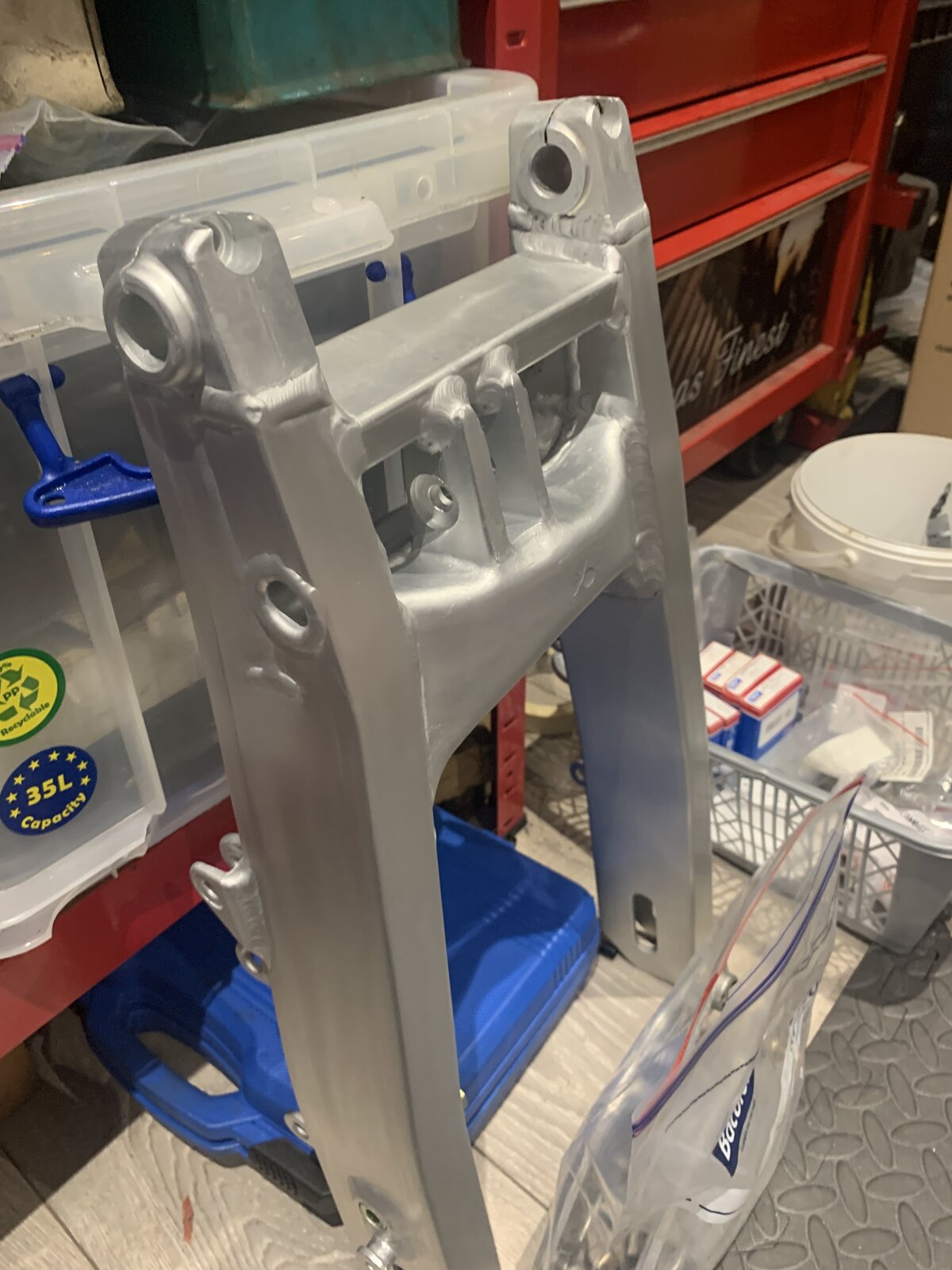

  2. Not much to report in terms of progress - but the rad fins are now straight and I am likely to get it cerakoted with the oil cooler.

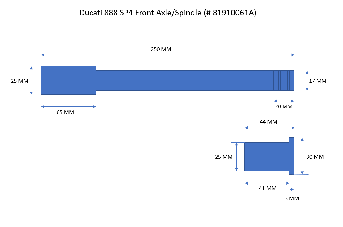

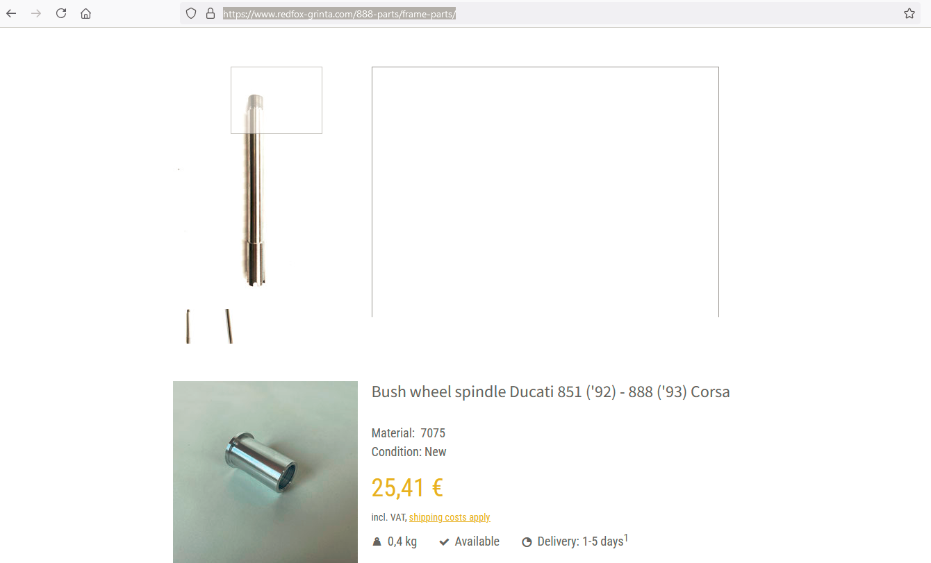

    1- I have had to use the front axle and catch sleeve for another build. I have the spindle but I am short of the catch sleeve for 888 and they cannot be ordered anymore. Anybody has a spare here??
    2—The swingarm has been rewelded and is now great, but I need to refinish it—brushed and re-anodised. But for anodising, I need to remove any of the metal parts. Basically the chain slider fixing points, the mudguard mounts and the thread for the clip that holds the brake line.
    Has anybody done this? Shall I drill those out?
    And then refit bolt rivets with something like that?
    Please let me know if you are in the known.
  3. Desmophil,
    I think my swing arm has been stripped i.e. anodising removed and all steel thread inserts out. The inserts are called rivnuts I think.
    Not sure how these were taken out but I would drill. I can measure the holes left in mine so you dont go too big on the drill side if you want.
    With your radiator you said you used tweezers, what was the exact method you used as it looks very good.
    Cheers Gaz
  4. If you could that's always helpful indeed. Thank you.
    I took some flat pointy tweezers (more workshop than beauty ones), inserted between the fins and straighten them up. You need to be careful as they are multi layers of fins and you try and align the fins below too. And yes, one by one. Work of patience.
    Some fins can't be made perfect but overall the result looks pretty good. Now I need to dislodge some remaining grime with a mix of engine degreasing and air pressure and some brake cleaners. Then I will take for cerakoting where they will strip paint and cerakote which is both thinner and more durable.
    It will look close to new and I stay with the principle of reusing the original parts wherever possible.
  5. Desmophil,
    Top hole RH Side Ø7.
    Side hole LH Side (x2) Ø9.
    What size threads are in these as a matter of interest.
    Cheers Gaz
  6. For the mudguard mount and the chain slider mount they are all M6 1.00 thread.
    For the clip for the rear brake line, I don't know. the bolt is stuck in the rivet and the rivet is moving. So I am going to have to drill it out Bolt and rivet together, which is going to be fun if the rivet spins! Probably the same or possible M5.
  7. The holes are countersunk, so maybe you could use a dremmel type tool with a cutting disc and cut across the head and collapse the head / shoulder in with pliers, it will then fall out the end, I think it could spin if the drill is a bit grabby, anyway just another option.

  8. Try:
    https://www.redfox-grinta.com/888-parts/frame-parts/
    #28 KevB, Nov 20, 2024 at 12:29 PM
  9. The 888 strada and 888 SP4 spindles are different (i.e. the SP4 is slimmer) which is why I put the dimensions up. Pretty sure Jan will have machined some to fit the SP4 though. They are actually quite hard to find out in the wild :-(
  10. Ah OK - thank you - Ohlins forks fitment I guess.
