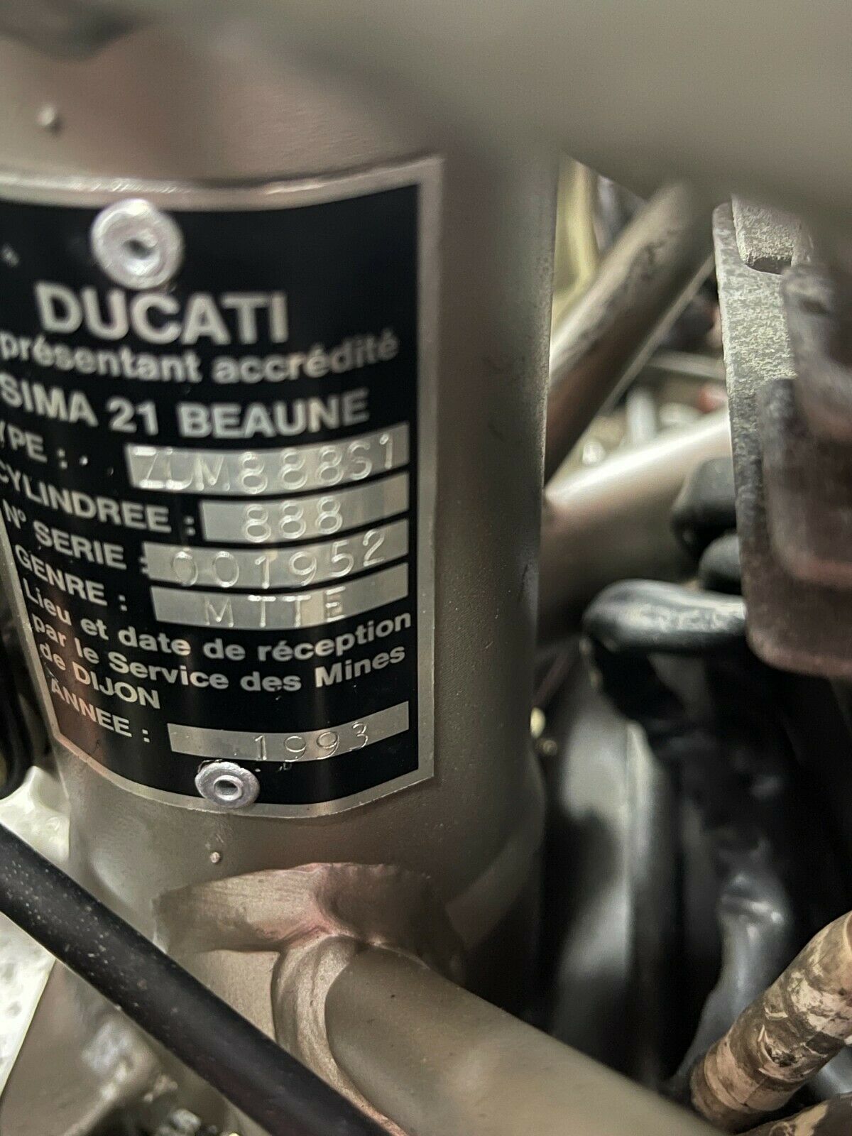

  2. I really do not see people (even in France :D ) mollesting a SP5 or SPS or any other factory race bike to fake a less powerful model to get it homologated for the road. I am very unsure this would have been « common practice » in 20th-21st century France. May be some did, but it seems universally stupid, IMHO...
    Until 2013, bikes with engine power exceeding 100hp had to be restricted before homologation could be granted. Restriction was often mechanical (e.g. 998s, with a metallic tab preventing WOT at the butterfly) or electronic with a specific Ducati EPROM (e.g. 996). The restriction had to be made by the official importer (SIMA, just south of Dijon, was the official French importer of Ducati’s for decades before the whole marketing model evolved to what we know today) in order to get the homologation certificate. That law was amended (2013) and today, ABS equipped bikes are good to go without power limitation.
    #62 Guillaume69, May 2, 2021
  3. That plate looks very legit to me. Still does not explain the dodgy stamping on the frame. If you don’t mind, I could use these pics to ask the French old timers what they have to say about this?
  4. The number on the French plate (888S1) is the overstamped prefix not the original 888S stamping of the frame so the plate matches the modified frame number rather than the origional, S1 being a Strada prefix. SIMA must have homologated it with the modified frame number as the modified number matches the plate.
    Please send it out to see what they say as I am curious about it.

  6. Snide VIN plate
  7. It would be good to know what you find out. As you said previously it does seem somewhat universally stupid to do this. Was it really so hard and costly to get the bike restricted that someone did this dubious change to the frame number? Someone obviously thought it was a good idea at the time!
  8. Same plate but for a Husqvarna :astonished:
    Search Plaque de Cadre.

    I don’t always tell people about my background but between 1994 and 2001 I was an expert witness regarding the identification of stolen vehicles including motorcycles recognised by the Courts in the UK.
    SIMA may be a genuine company but you can still buy blank VIN plates as shown from companies that are not SIMA.
    This bike has a dubious background.
    I like the theory that the stamping was done to get it round French BHP regs. That would explain the why the prefix and not the suffix was altered.
    The Upshot is that this bike has been considerably devalued.

  15. Well I don’t know about this. What I know, though, is that a modified frame number like this will get you in trouble over here, should you get controlled by the cops on the side of the road (speeding, noise, or just routine). French law strictly forbid to mess with frame and engine numbers, let alone in a DIY mode.
    I have passed the word, pics and the link of the listing to the 888 community over here. There seems to be consensus that seen from here (pics) it does look like a legit SP5, and that it would be very simple to confirm (or not) in front of the real bike. They say if the original stamping underneath is indeed 888S (can’t be seen on pics), then the sequence number #1952 does match a SP5 frame. Moreover, they insist that there are many parts to change in order to clone a strada into an SP5. Not worth the money just to sell a fake.
    That being said, nobody understands why the frame number was so messed up. They suggest contacting the SIMA and see if they have kept archives of that era. A long shot, as the business has changed hands since, but you never know.
    If that helps, Alasdair, I could try and help you with this. Unless you are fluent in French, of course. ;)

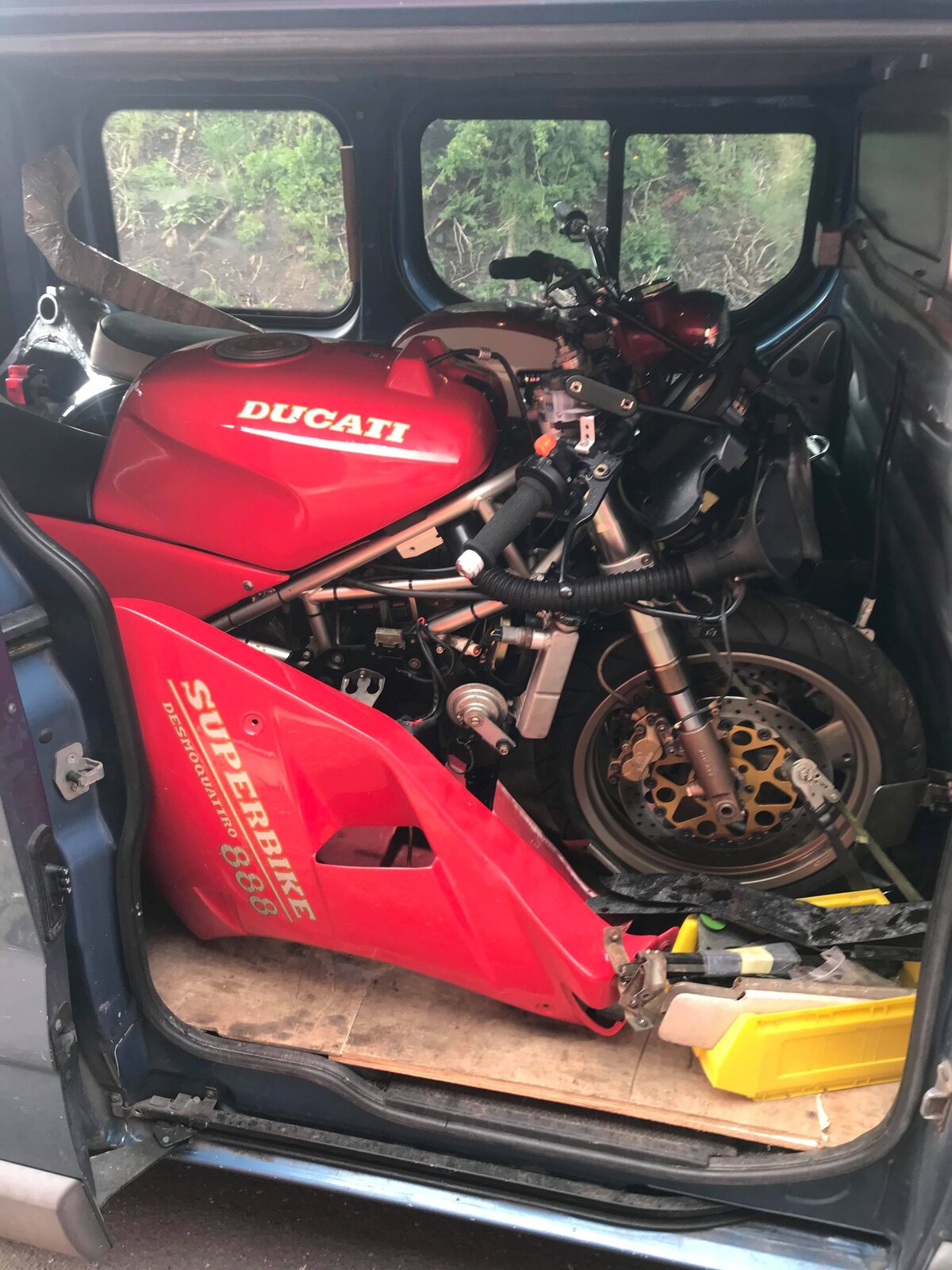

  16. I picked the bike up yesterday so will get the log book away (the last 2012 issue is not there) so need to post it rather than do it electronically. There is a French dealer sticker on the bike so I have emailed them as they are still going to ask them about it. The bike is not bad, a bit rough round the edges but nothing bad. It is definitely a proper SP5 for sure looking at all the bits and pieces on it.
  17. I'll start getting some parts sorted for it and get the motor to Slick Bass on the IOM hopefully when the travel restrictions are lifted again as have another 3 to take as well.
