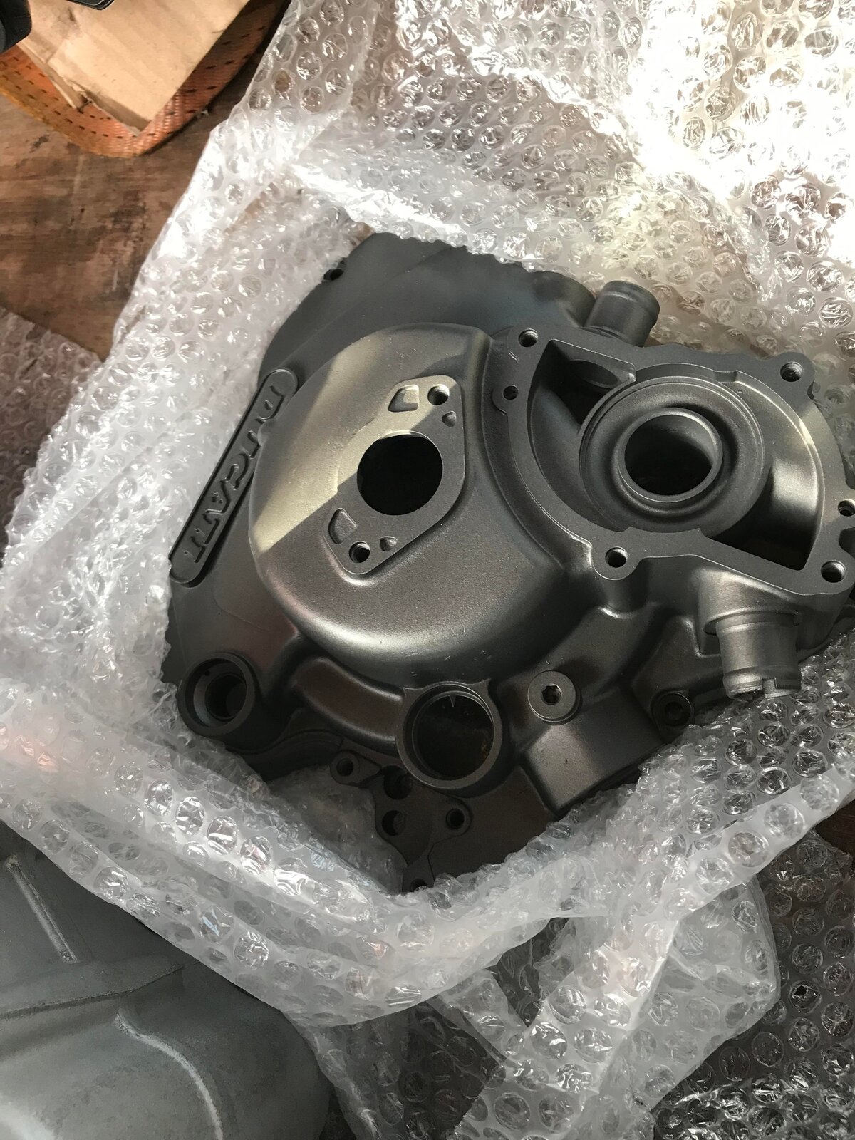

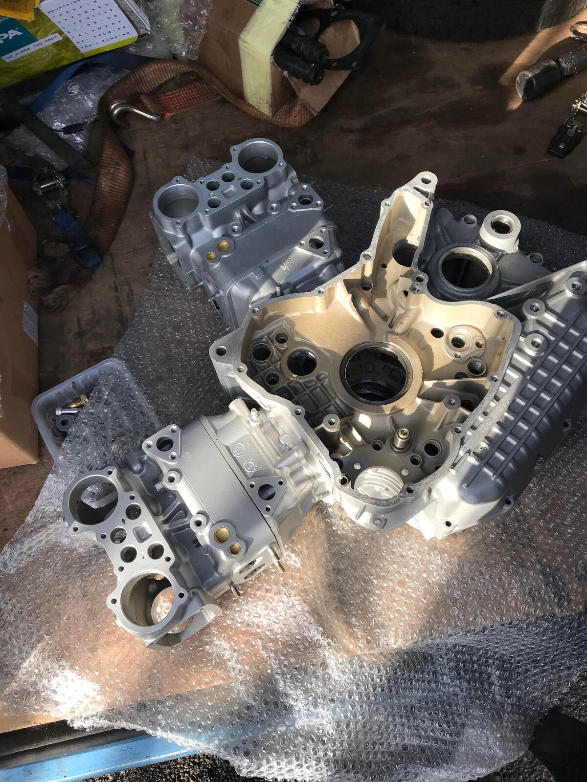

  1. All the parts are away getting ceracoted at the moment. Pain getting the rollers out the cam end caps but all done. Have ordered all the bearings now so have most bits and pieces, need to source a few oil seals. Managed to find shells for the 888 eventually. The ST4 cases are in very good nick with no corrosion so just going to degrease them and use them as is, save a bit of cash. Slick will blue print the motor for me as well to give it a bit more go. Will be going over to the IOM in the next few weeks and hopefully take all the parts back over with me.

  3. The green/grey colour on the engine parts is a funny colour so having to do a custom mix for the cerakote to get it right. Still looking for some engine parts as well, not knowing the bikes is always a struggle. In need of a set of big end shells as they are NLA from Ducati apparently.

  13. Picked up all the ceramic coating yesterday. Looks not too bad, the company unfortunately shut yesterday so will have to find somewhere else to get it done. Should have been off to the IOM tonight but van broken so off next Sunday night instead.
