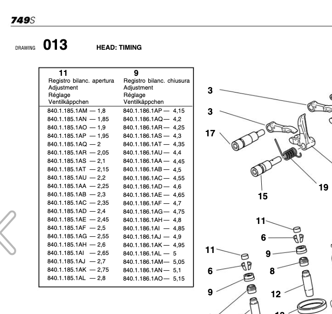

  9. Hy Derek,
    All the 749S and 999S have 6mm stems as for the Rs
  10. Yes me too. Getting Oliver to send anything quickly was a task! One day he put 2 shims in a DL envelope! I got an envelope with 2 holes in it! Still got the course notes somewhere too. Wish they were still on the go too, the current dealers leave a lot to be desired in comparison. Although I have eventually landed good.

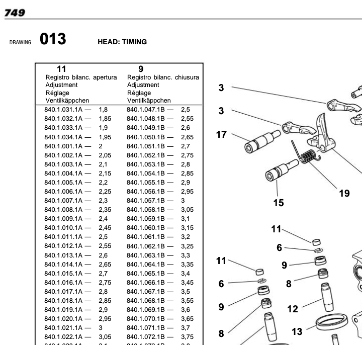

  11. I was aware that the "R" models have a different shims from the others using tapered collets instead of half rings. I didn't know that they had 6mm valve stems though.
    The 749/999 and 749S/999S however, are all 7mm with the same part numbers across both base model and "S" versions.
  12. Sorry, I beg to differ, the S versions use the same taper collets as the R. I've just rebuilt one from a 2004 S Derek. They are indeed 6mm too.....
  13. Well either your bike has R heads or the parts lists are wrong...
  14. Must be your parts list Derek, defo 749S with 6mm valves. I had to make the tool to preload the torque setting during installation, 9Nm or so iirc.
  15. How odd. I checked the parts lists for 999, 999S and 999R. Only the R differed.
    Maybe only the case for the 749S.
