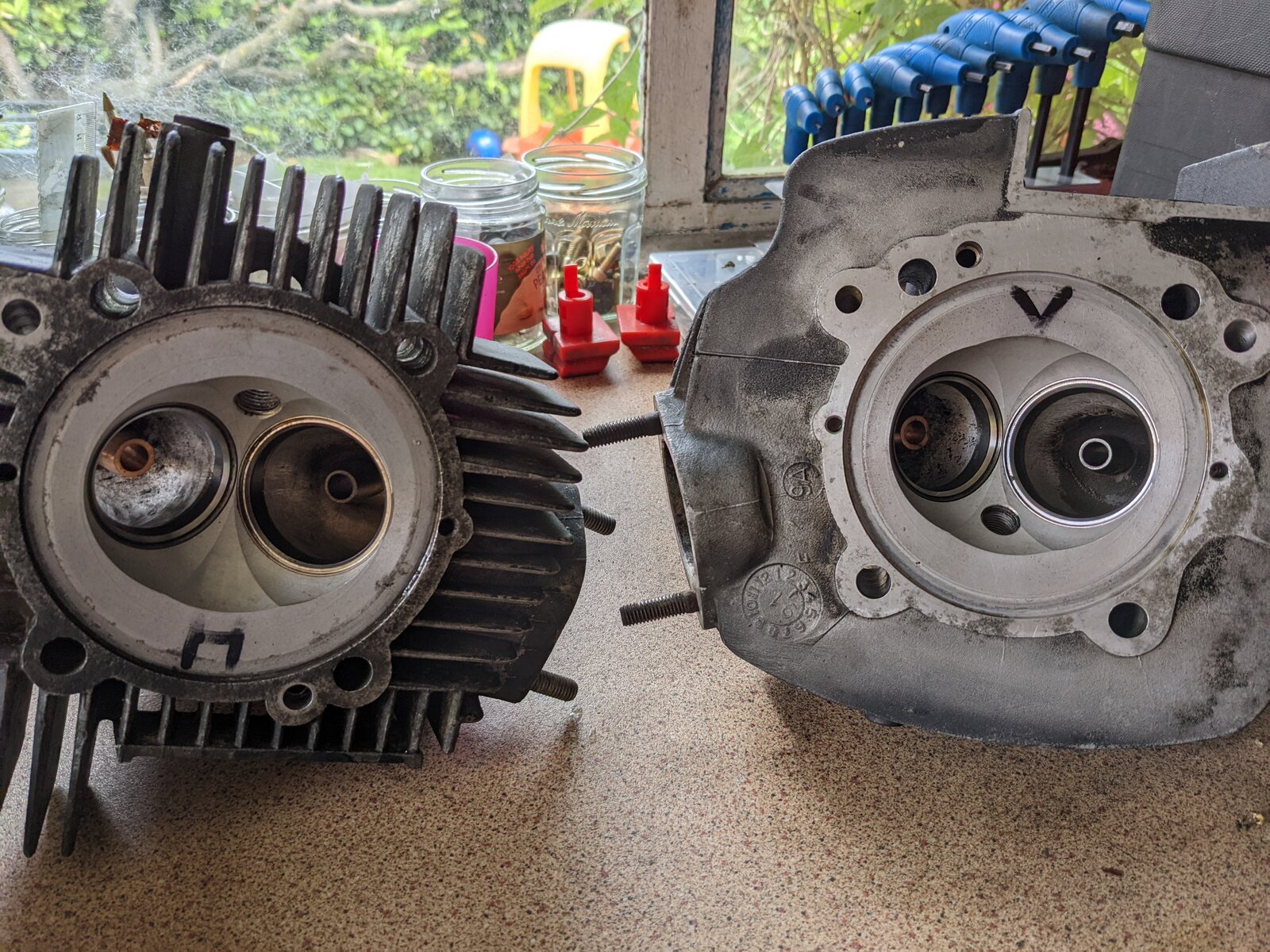

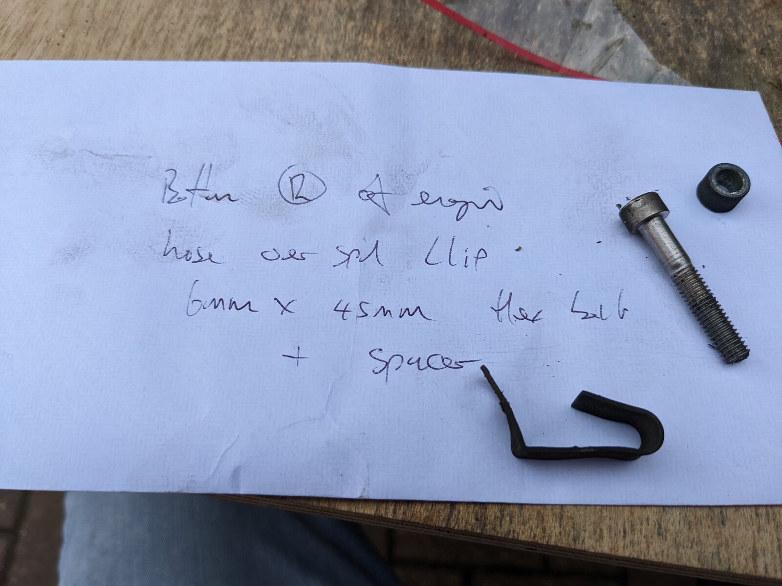

  10. The bike is fully disassembled, including the engine. No big surprises in the engine. Galley plug was loose, valve guides are shot.
    I've cleaned all the soot out of the cylinder heads and organised all the fasteners etc ready for plating.
    Only boring pictures so far!
    More to follow.

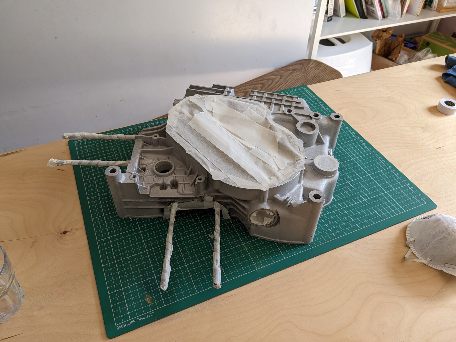

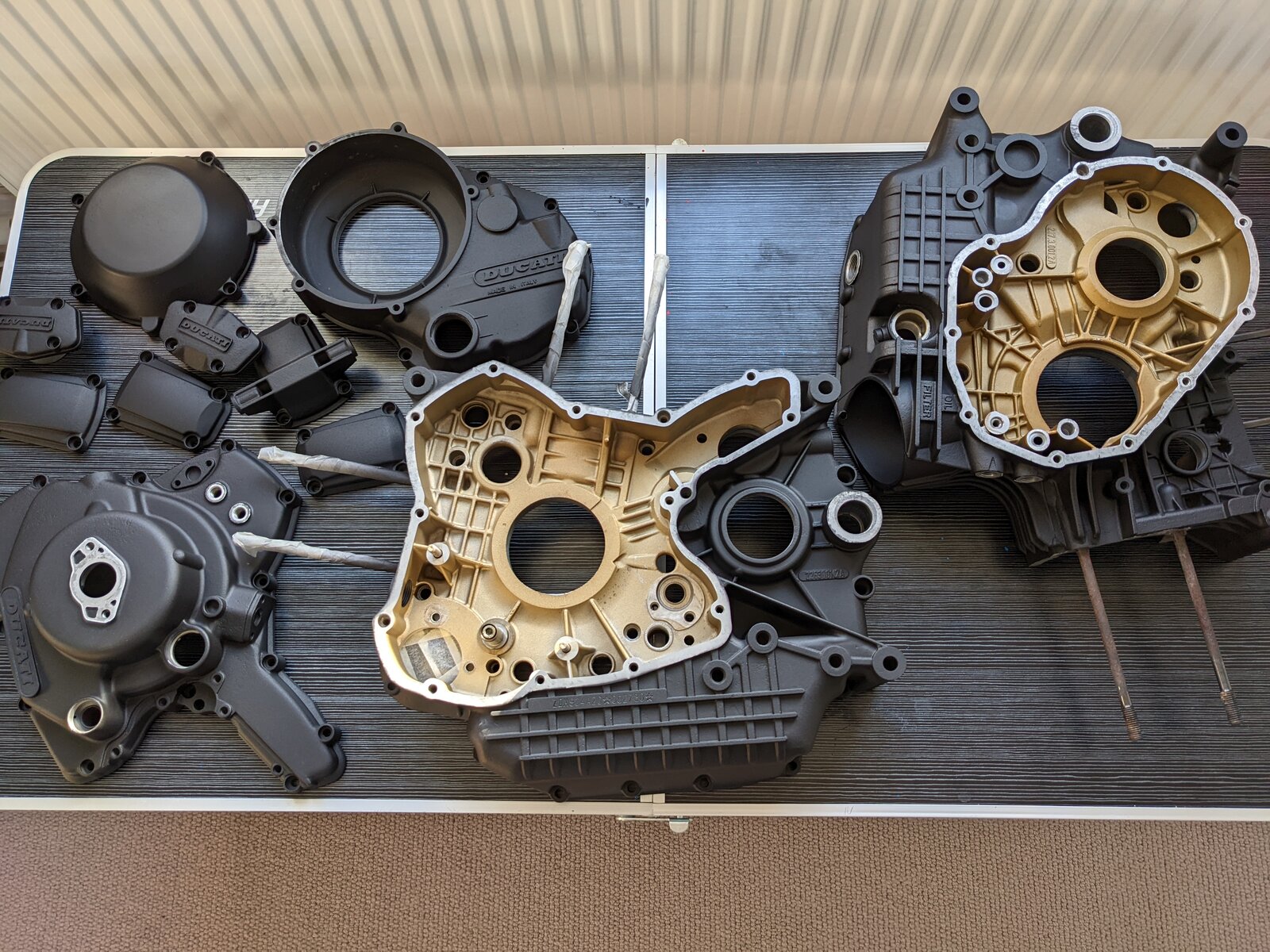

  11. Engine is dismantled. I've had new valve guides made and pressed into place. The originals were very 'sloppy'.

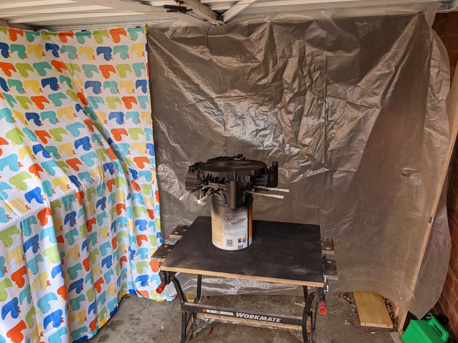

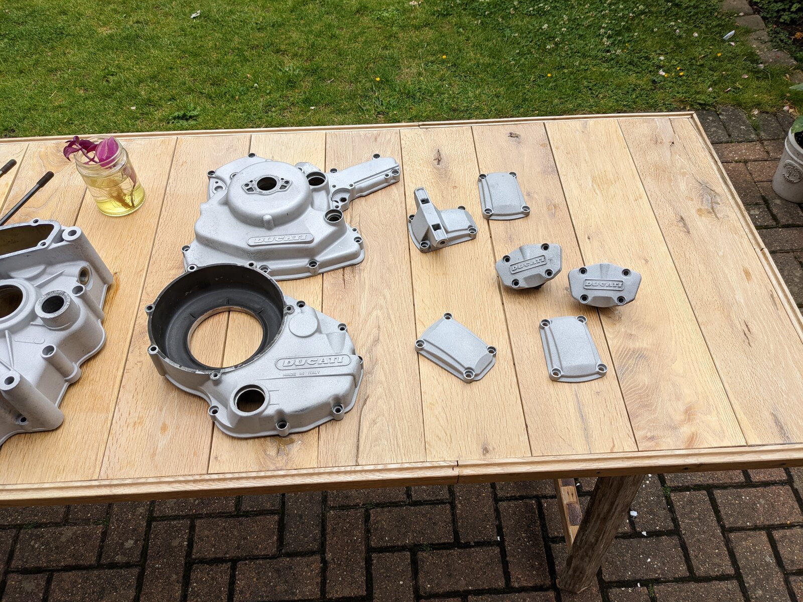

  12. Cases and covers etc have been sand blasted and I've painted them at home in a makeshift spray booth. Used PJ1. Everything black! PXL_20220706_101605330.jpg PXL_20220708_140222400.jpg PXL_20220708_163520488.jpg PXL_20220708_180644861.jpg
  13. I do like a bit of PJ1 satin, was it easy getting the oil sight glass out, socket and tap out from the inside?
  14. Looking great
  15. Very easy. I paid Ducati John (not allowed to call him that anymore) to dismantle the engine.
  16. Then you painting the engine bits and Ducati John rebuilding?
  17. Yep, although I'm not sure what to do about the heads and barrels. I may get them powder coated.
  18. I will be vapour blasting everything, crank cases left in vapour finish, side cases + barrels heads all pj1 satin
    With pj1 I usually do a bit of spray touch up when needed but if you powder at least it’s done for good,,

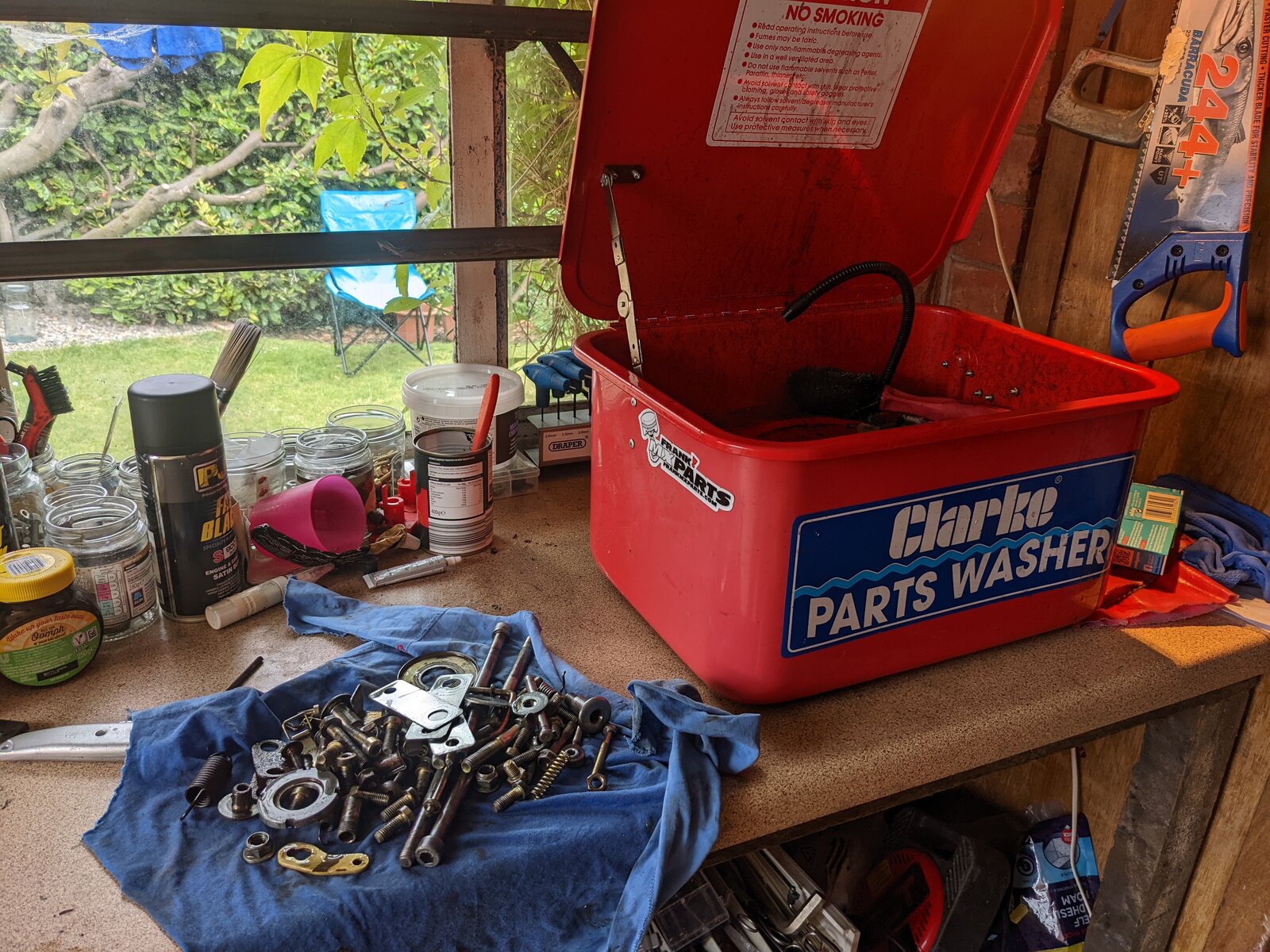

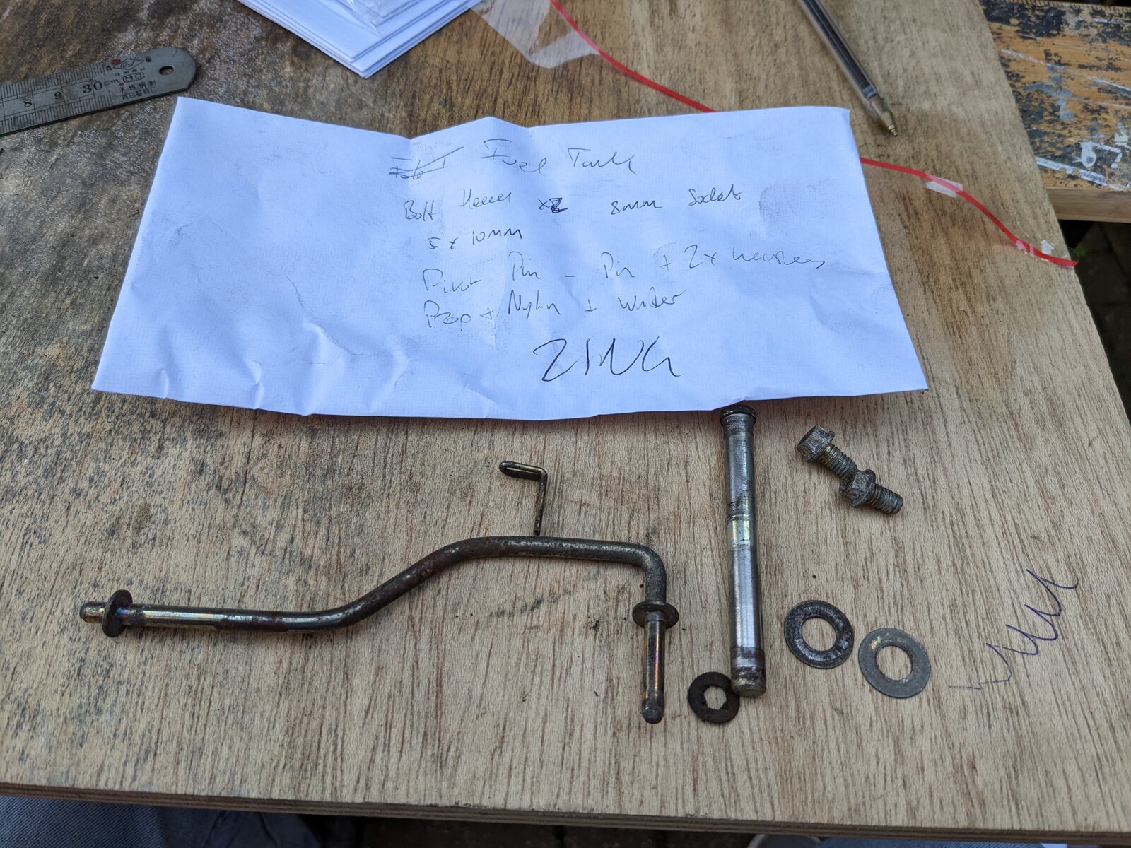

  19. Prepping all the original fasteners and other bits and pieces, ready for zinc plating. PXL_20220715_111157644.jpg
  20. Powder coating goes from powder to 'coating' at about 200C so I'd be wary of powder coating your heads, as the exhaust area is way over that... High temp wet paint perhaps?
