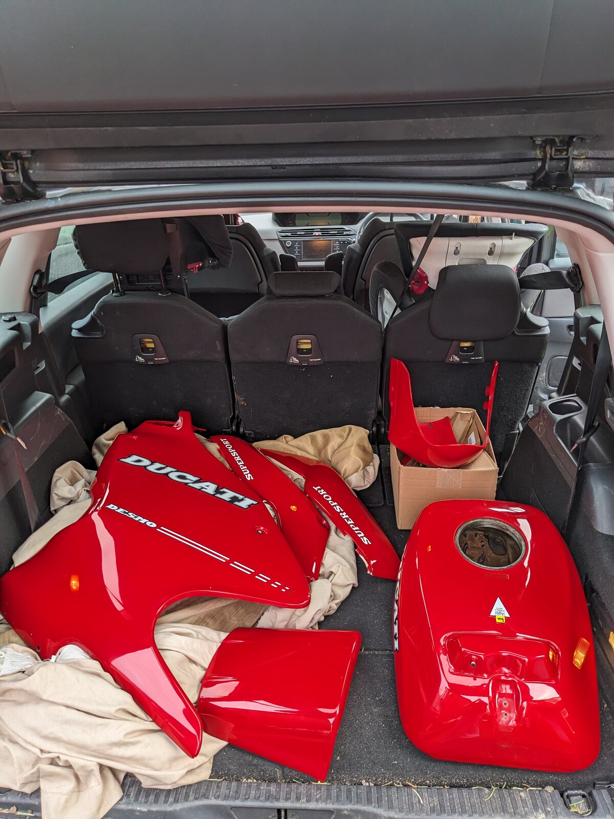

  10. I've finally saved enough money to have the rest of the bike painted. I dropped the parts off this morning.
  11. Do like them decals, will need a fitted photo.
  12. The picture is the 'before' photo. I only dropped them off today. 8 month lead time!! And it's not coming back red!!!
  13. Good before photo, Going for Yellow?
  14. Jeez, I hope you booked them in 7.5 months ago...
  15. 8 months! It’ll be next Christmas when you get them back :scream:
  16. Blimey, what are they doing... Growing the paint ?
  17. The paint dude rang me this morning, he has started prepping. 4 months ahead of schedule!
    Exciting times.

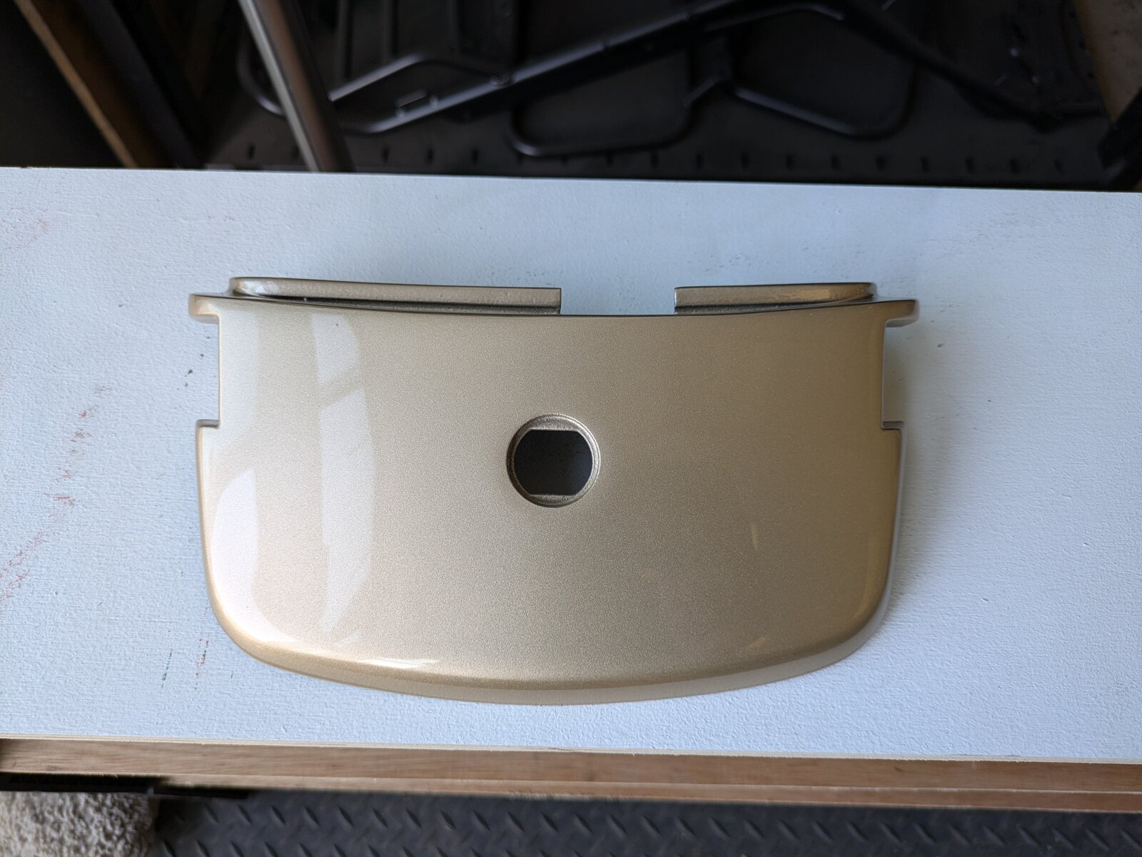

  19. Wow..looks unusual. Keen to see the finished outcome. :upyeah:
