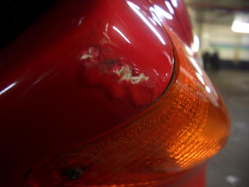

  6. Sorry for bumping this old thread, but
    a) it contains some really useful info
    b) I have some questions about painting:

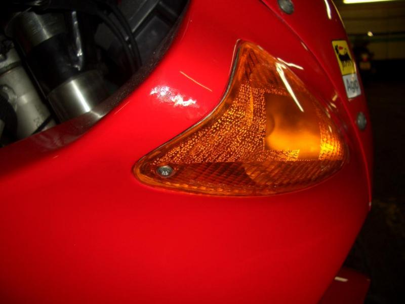

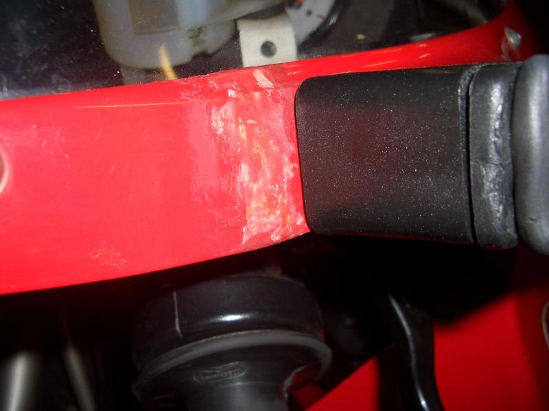

    This is the state of my right side fairing:
    What do you guys reckon the best way to deal with it is - touch up paint or spray, and do I need to rub it down, and is filler required? Can I do it without removing the fairing from the bike?

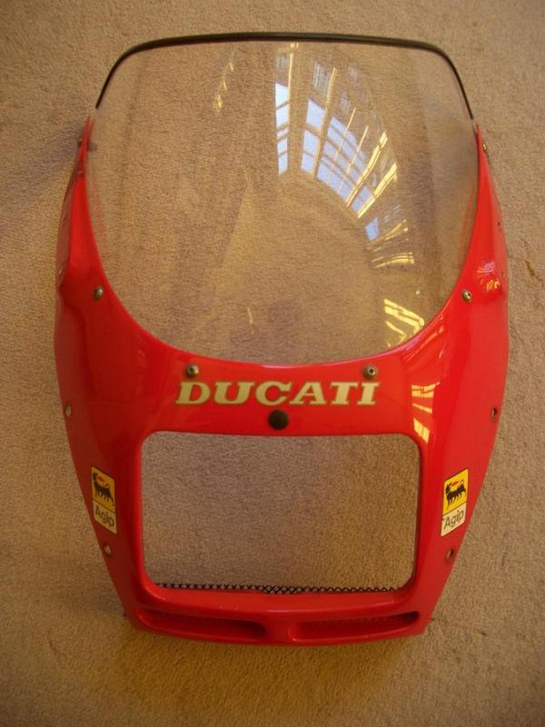

    I also took off the front fairing after purchasing a slightly more intact version off a forum member here. Might anyone be interested in this? I'm keeping the screen as a spare.
    Damage:
  7. Spray all the way. You can never get a decent finish with touch up paint using those paint brushes. I've learnt it's better to put in the work and get it done properly otherwise you will always look at it and be pissed off.
  8. OK..so what should I do to the side fairing above?
  9. on the side fairing take the indicator out. rub the bodged overspray away.
    use a rubbing block, and some 400 wet and prep the area - move the block in a 45 degree stroke rather than up and down, in that way you keep to the curvature of panel rather than risk sanding the spot flat.
    if you're going to rattle can you will need:
    Filler primer
    Some matt black spray, or soot.
    Primer (oe was grey)
    ground coat (depending on paint supplier)
    base coat (depending on paint supplier)
    laquer
    Mask off the area. You ideally want to mask in the case of your main fairing, the main fairing panel face, as you're fortunate that you can lose a lot of the spray on the shape. The way the indicator pod bends light means that re-spraying it will be quite forgiving.
